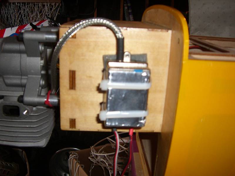

ORIGINAL: paul5992
Check this cowl cutting job. I went back to my stock pipe. What do ya think guys? Just got it done.
Couple of things. Where you've relieved the cowl for the front of the canister - watch that very closely. My Cap has a similar cut, and I had it too close, the cowl flexed during flight and started rubbing. Not good.
Of course - you'll secure the spark plug lead to the cowl so that wire isn't flapping about, right? If not, the thing will fail at the cap in short order.
Other than those things, as cambo wrote - WOW - Mine will *never* be that good.

Really looks great Paul!!! Great job!! I have one suggestion you may not have heard of. Get a roll of 3M 3 " Aluminum tape and put a couple of layers on the inside of the cowl between the opening at the front for the can and the opening for the stinger. Because the material there is so close to the can the heat can affect it and blister your paint. The aluminum tape acts as a shield against the heat. I use this a lot on my planes for heat shielding. I also put a couple of layers around my EI unit to shield RF. Once again, Great Job!!!

Thanks guys. I'll do what you said about the spark plug wire aerobob. Also I'll pay close attention to the cut out on the pipe. How close was your cut to the pipe when it started to rub, and what happend that was so bad.
Where can I buy that tape Lou. And thanks for the good looks
Thanks guys. I'll do what you said about the spark plug wire aerobob. Also I'll pay close attention to the cut out on the pipe. How close was your cut to the pipe when it started to rub, and what happend that was so bad. Where can I buy that tape Lou. And thanks for the good looks

Any Ace Hardware. BTW If the cowl rubs the pipe it can cut through the aluminum and give the pipe opening a really hasty look around the edges of the fiberglass..
