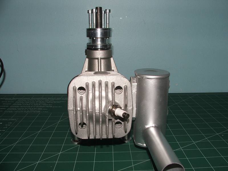

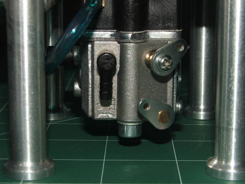

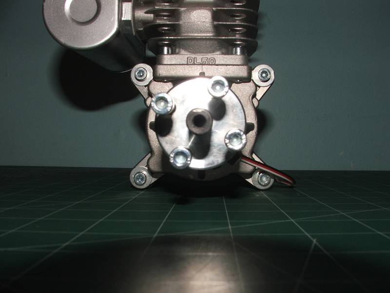

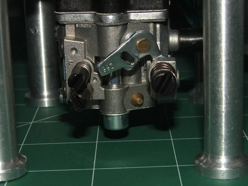

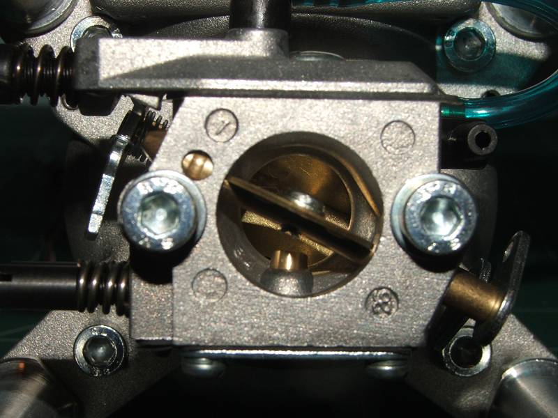

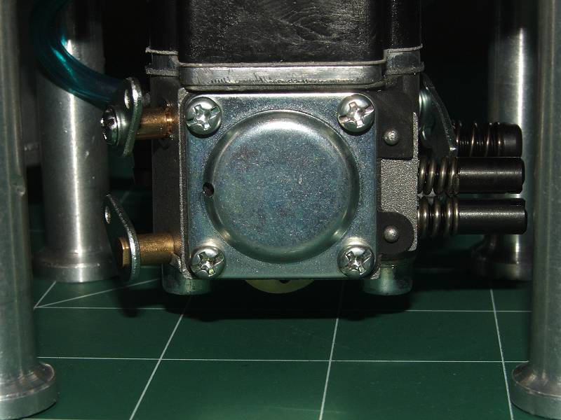

I just received my new DL50,oooooohhhhhhh.
It is my first gasser, it looks to be alot of fun ahead.
I ordered a couple of NGK CM-6 plugs and I am waiting on the CMPro 330L to show up and start the winter project.
Anyway here are some engine picts to slobber on

Old 11-15-2007 | 07:51 PM
  #444
Banned
Joined: Jul 2005
Posts: 1,791
From: Port Orchard WA
Default RE: DL-50 engine
Uhhhhh, We've all had one for ages and flown ours.LMAO Nice pictures though.
Old 11-15-2007 | 08:28 PM
  #445
Bob Pastorello's Avatar
My Feedback: (198)
Posts: 6,707
From: El Reno, OK
Great to see that enthusiasm and excitement about the DL!!!!
The pics are great, too.... I'm not sure there are any of the current version on this new thread, and since we know that no one searches the forum to see what is already out there, those pics will come in handy for many, I'm sure.
You are gonna be smilin' fer shure.....
Old 11-15-2007 | 08:36 PM
  #446
Banned
Joined: Jul 2005
Posts: 1,791
I've seen one of the engines with the thicker mounting ears first hand but I think these are the first pictures I've seen of one. Mine is the older style with the thinner ears. It's really nice to see a company actively correcting their shortfalls based on the consumers feedback. You are REALLY going to love this engine!!!
