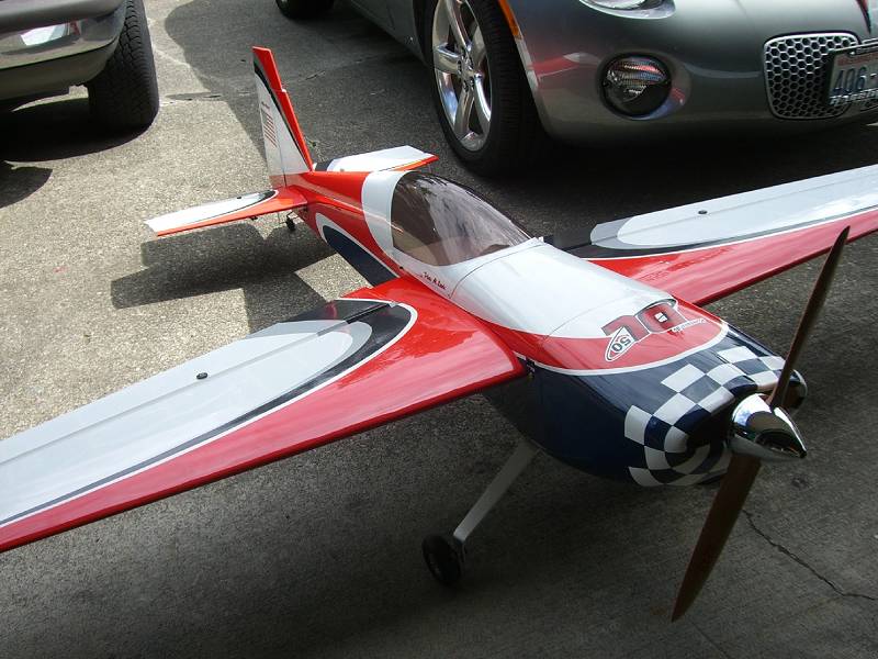

To be honest it flies just great! It will do all of the 3D maneuvers even though it is really an IMAC plane. I have another plane for learning 3D on. A WH Edge 540T V2 that is probably the most stable plane I've ever flown. I plan on using this one to learn/practice IMAC maneuvers and play around with a bit. Even so, with the DL in it it has more then enough power for anything you'd want to do with it. Here's the culprit that caused all of the fuss!

Awesome planes, Good news for me about your WH Edge, I was thinking about getting one. Just put a Sullivan tailwheel on that Extra. Or RC Blimp.

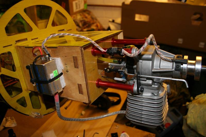

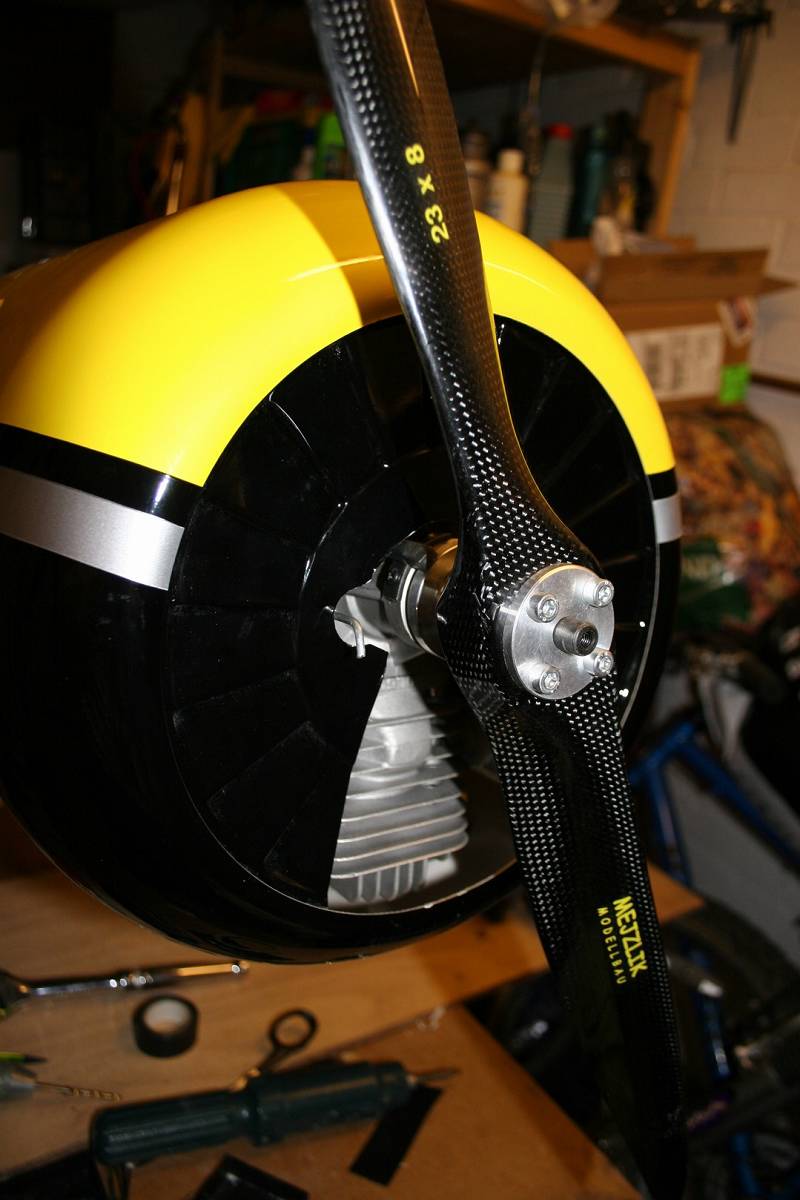

Got my engine and 2 props from ya today - awesome product and fantastic next day service. Its going into a GP Yak-54. Just one question, do you have any photos of the recommended linkages for the choke and throttle? I'm new to gassers so its a bit of a mystery to me. Cheers mate
Hi Scott, images of my EF yak choke setup...hope it helps? Its just a ball link on a std rod, held onto the standoff with an old servo arm, theres a post about it somewhere.
Theres also some info from Aerobob somewhere on using an old hitec blue servo arm on the throttle...thats what i use...and works perfect.

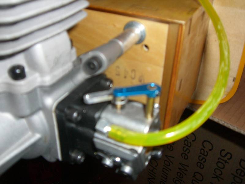

Here's the original post I did on the blue choke arm. Bob has one very similar on his web site. Sorry about the poor picture quality but it's a Casio Exilm and if it's got a macro setting, I can't find it.
For all of you Walbro carb users out there that are getting carbs with that useless little steel arm stamped on the choke rod, (and in the wrong position) here's a fix. The Hitec HS-5645MG servos come with a nice little aluminum servo arm that's even anodized a pretty blue. Due to its size it's pretty much useless for anything but a throttle servo. If you snap that little pressed on arm off of the top of the choke rod you can drill the Hitec arms hole out (above the spline) to .185" and then run a #29 (.089" drill through the side. Then you can tap the side hole with a 4-40 tap and install the arm onto the choke rod and secure it with a 4-40 set screw. Problem solved and no extra cost for so-called custom made arms.
