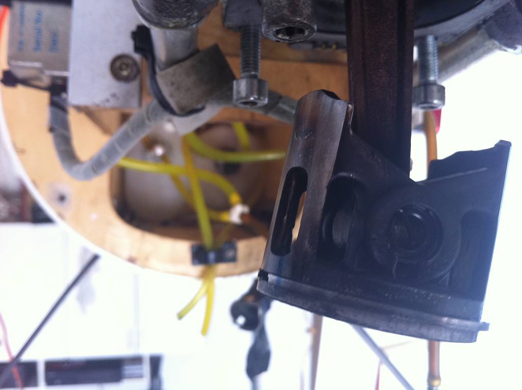

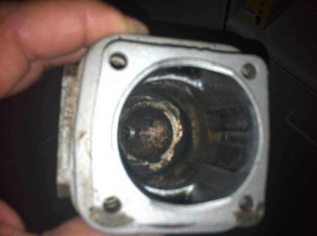

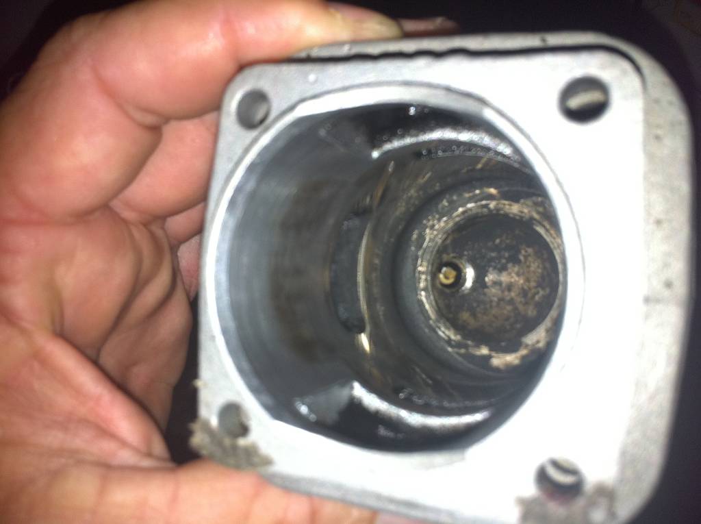

Ok, i've run this eng up to 270 deg F. I think I've fried it. What are you guys thoughts?? the inside wall of the cylinder head has burned dis-coloring the darkest area is right below the exhaust. I have cleaned inside the head with degreaser. i cant feel any scaring with my finger on the walls.... I've jus been chasing needle settings. but every time she warms up a bit she wont start back up...

The ring looks a bit tired - showing blow-by. Should be clean all around. Piston looks OK from this angle.
Needs a massive cleanup!
You might get away with just a new ring if the rest looks OK after cleaning. Main bearings still good? Doesn't look knackered, just needs a bit of TLC.
How many miles does she have?
