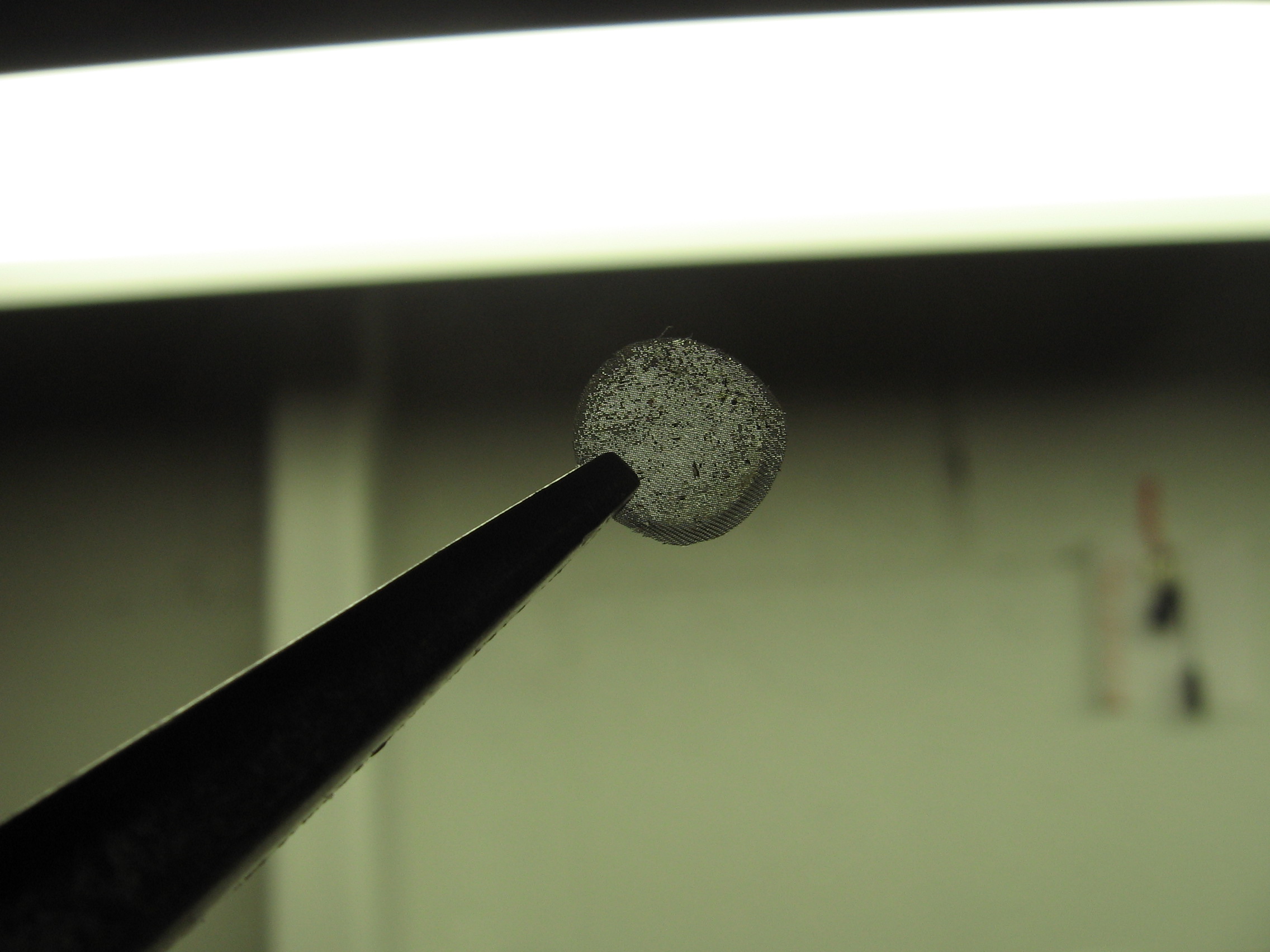

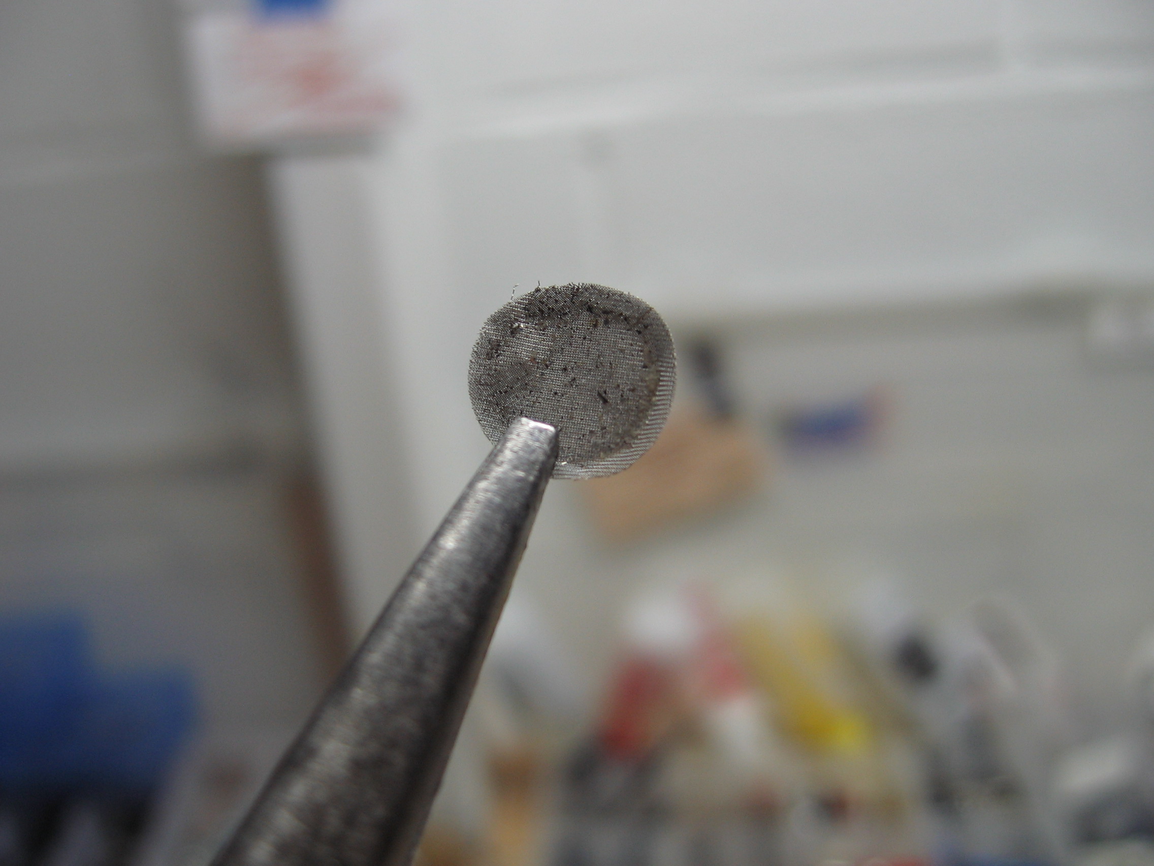

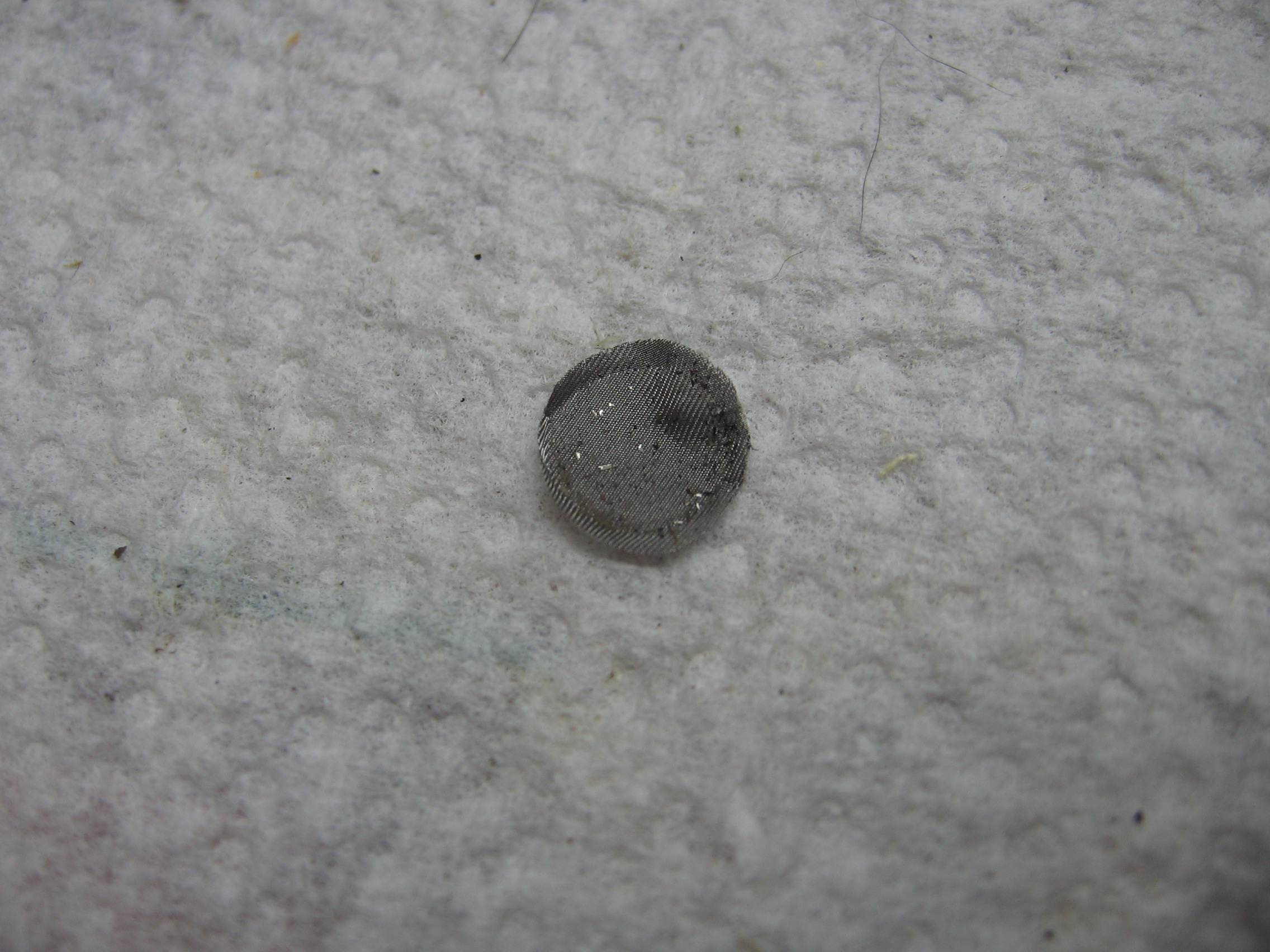

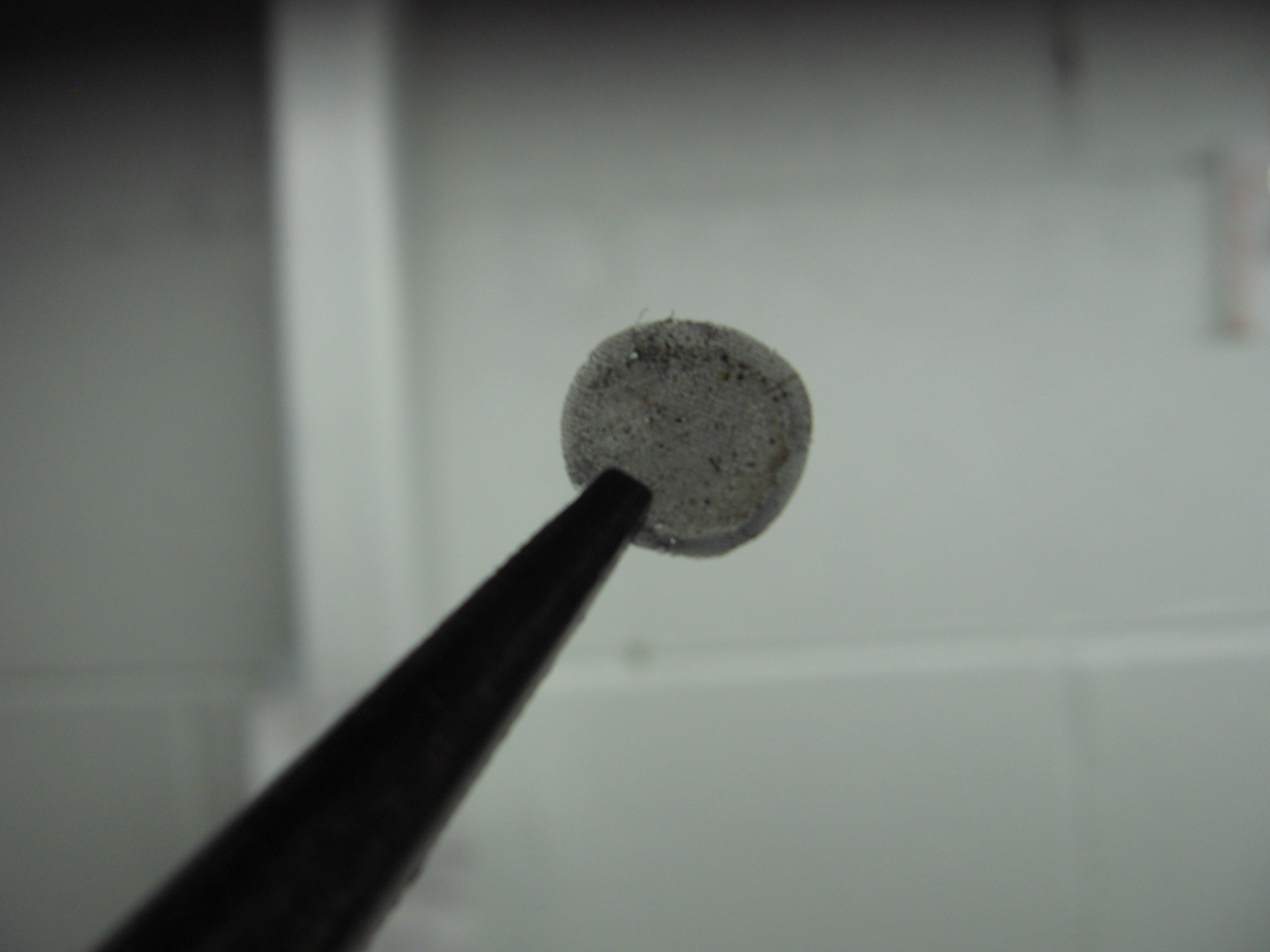

Don't use neoprene. Do a search and you'll see me and others reporting problems. It just deterorates and plugs up your carb screen. Tygon is fine if you leave some fuel in the tank to keep it soft. I'm going to try Viton for the clunk next time I re-plumb. It stays flexible. I'm using the Walbro felt clunk and a Final filter in line with the carb. This is a system that Jody said works for him and it's working awesome on my DL-50 and DLE-55. I didn't used to use a filter because my gas fill can has two but after all the plugged screen problems I decided to try the Final filter. Works great. It's not serviceable so it can't leak air.

I never had my neoprene dissolve to a point it accumulated in the carb screen. I only leave the line inside the tank installed for one flying season, anything outside the tank usually lasts two seasons before I swap it out for new. I rinse it all first, so perhaps the problems seen are from mold release agent or something? In any case, whatever line you choose to go with, don't assume it is the very best and doesn't require routine inspection, develop good maintenance habits early, and you'll keep all of your systems in good shape.

No. The additional octane did nothing at all. If you were using Shell gasoline for the oxygenated fuel I can see where the rough running occurred. I've experienced the same thing with their gas in any octane level.
An issue of lost volatiles may have occurred if the oxygenated gas had sat around for a long period of time. Gas retains it's octane additives when it sits but will lose it's more volatile components.
For the guy asking about Dubro filters.
They are absolutely useless for filtering gasoline. Using a felt filtered clunk inside the tank and inside the gas can will eliminate any fuel debris contamination. The Walbro filtered clunks are also a lot heavier than standard clunks and do a much better job of keeping the gas line immersed in the fuel inside a gas tank. Because of that additional weight they even overcome the stiffening of Tygon line inside the tank. Another feature is the felt clunks pick up the last drop of fuel in the tank, break up line bubbles, and don't have to be fully immersed in a fuel quantity to still effectively draw a constant supply of fuel. They only need to be touching the gas.
Too many advantages of using a Walbro filtered clunk to even consider anything else. For those that have a belief they shed fibers and clog carb screens, many thousands of hours of operational use has proven that to be a fallacy. Out of the bag and into the plane.
