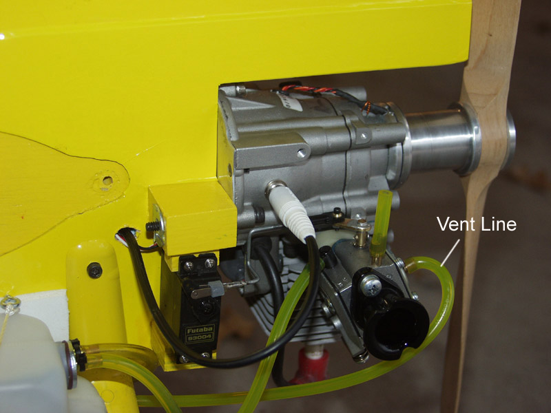

paul, i do have a hole in the firewall, with what i have it flys very strong, just not getting the high rpm like some are, maybe it will come with break in and a new prop.
how ever i am having a problem with engine stumble , fly level and pull hard up to do a wall or go into a hover engine stumbles real hard, just on the up not the down? what do you think?
presure inside the cowl over the vent hole in the diaphragm cover is all i can think of, i flew it sat after going through the fuel system with all new fuel lines, running a filter walbro clunk.

I don't know how good you are at adjusting a carb so I'll just say that with my motor it was in the fine tuning of the needles. And its not just the high or the low speed because they seem to work together on the midrange. And thats were my burble was.

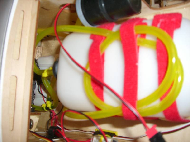

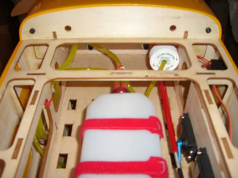

You can always run a line from your metering plate to the inside of your fuse and into a pill bottle. Works great, if that's your problem. BTW Make sure the pill bottle's not air tight. I do this as a matter of course when building the plane.

im ok at tuning did it for yrs in karting, with the tilitsons,
i leaned and richened because i thought the same thing, didnt help, full to near empty on the tank doesnt matter either,
AL, my set up looks just like yours as far as the mounting with the hole behind the carb, the tube for the air hole in the plate maybe be just what i need, thats where i was thinking the problem lies. what did you use for a nipple? and did you tap it?

i need a new mouse sorry for the double post, do you have the pill bottle vented?

sorry i miss the part of being air tight, i will give it a try, B T W like how you mounted the servos on the side like that, never thought of that,

I believe it was an 8-32 tap and I'm pretty sure the hole is the right size for the tap. You buy an 8-32 muffler nipple and use that after tapping the hole. Remove the plate before tapping and after you screw the nipple in use a Dremel to grind it off flush with the underside of the metering plate so it can't contact the diaphram and puncture it. I drill the hole in the cap of the bottle large enough to slide the tube in slightly loose. That way I know it's not airtight. There is another method where you solder a piece of tube into the hole and bend it so it's right next to the carb intake (a 3W design I believe) but I have never used it. There are those who have to great success, just not me.

I put a vent line inside fuselage for the metering diaphragm covers on all my gas engines. It takes about $.25 and fifteen minutes (after you've done one). Go you your local hardware store and pickup the brass fitting in the plumbing aisle, solder it to the to the cover, drill a hole through the cover, and put silicone over the existing hole. The brass fitting is used on the small polyline that is used with ice makers and furnace type humidifiers.

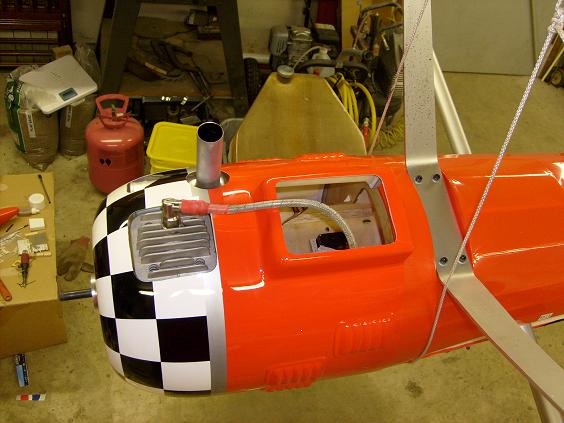

Do you guys think with this set up that I'll have a pressure problem?

Odds are you won't but check the rub through on the plastic spiral wrap every flight. Just a quick once over. If that fiberglass edge gets to that plug wire it will saw it in half in a flight.

Al, here is how I fixed that problem. A little electrical tape under the rap and a tyrap.

That should take care of any potential problems.
Paul, Don't know about the pressure problembut that is the best looking cut and fit crowl job I have ever seen. That thing fits better than a glove, I can't figure out how you got the muffler pipe through the crowl to mount the crowl to the airframe. Good work. ED
