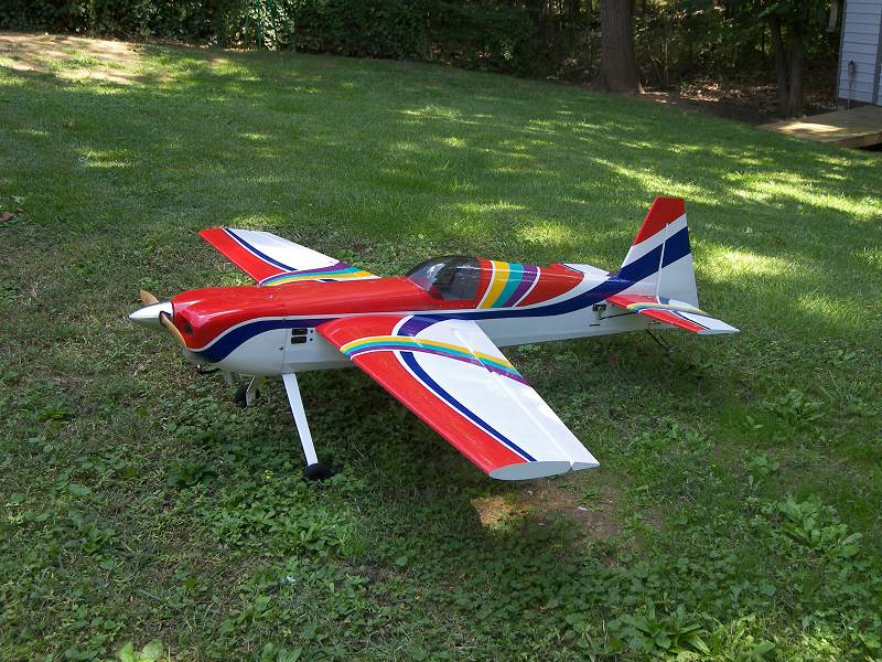

I just finished running pennzoil 32:1 thru my DA50, I am now going to switch to Amsoil Saber 100:1. A couple of DA50 owners at the field told me to run a gallon at 50:1 before going to 100:1. I also changed the prop from a 22x8 to a 23x8. The DA50 is in a PAU 50cc Edge 540. Any suggestions would be helpful and welcomed.
