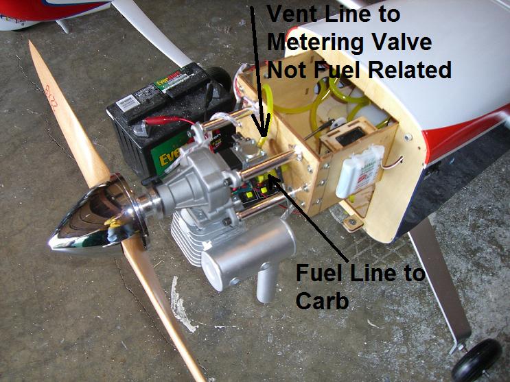

I found out the problem It was I had a two line system . one going to the carb and one plugged with a plug. What was happening was the engine would build pressure in the tank and quit and run rich !! When I would take the plug out or the fule line off the carb fuel would spit all over . So I un plugged the line and have run 3 tanks fully out with no problems and the plug was perfect!!
Thanks for your help !! I guess I was just thinking nitro being this was my first gas and didn't think about the pressure !! This engine runs great would recommend to any one !!I thought I was kinda werd it had pressure in the tank !!
Thanks,Josh
I'm confused, you always have to have the tank vented to the atmosphere. With a two line system one is vented the other to the carb. If you plug the vent you will create a vacuum and stop fuel flow.

Okay, Let's all settle down with the legal matters and take note of what is important here. If you are running a two-line fuel system on a gas engine you want the vent line to make 1-2 loops on top of the fuel tank and then exit out the bottom of the fuse. The line with the clunk on it goes to the carb. It has a tee in it and a line running off of the 90 degree tube that is used to fill the tank. It goes to the fuel button. See below.
Oops, I should have read the whole post. I didn't realize he had set it up as a glow system.
Al--I set up all my planes just as you have. It is very simple and works.

Ya This is my first gas and I rely didn't do no research on how to set up the tank!!
Thanks for the post on how to set the tank up!!
