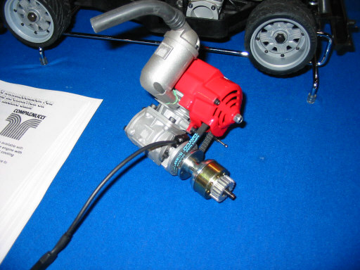

For those who was looking for small gas engine...here it is. I seen it at Toledo expo. Thanks Capt,n

What company produces it? What size glo engine does it compare to in physical size?

I saw one of these Campagnucci engines in a beat up old RC car in the LHS. Don't know how much power this little bugger puts put though.

That engine is about a .40 size with electronic ignition and puts out about 1.35hp. Saw one in a LHS about two years ago.
More info at:
http://www.aerohobbies.com/Cars/Compagnucci.htm
http://www.mecoa.com/compagnucci/index2.htm#gasoline

Thats 1.35 hp at 17,500 RPM!

From what I could tell, it doesn't use needle bearings in the con rod. So it requires quite a bit of oil when running glow fuel and a good dose of oil with gasoline too.

Diablo - I haven't torn apart dozens of engines (only 5 or 6), but I've never seen bearings on the connecting rod. Even if it did have bearings there, shouldn't they be regular bearings or roller bearings? Needle bearings are tapered and seem inappropriate for the con rod. They're more appropriate for the front crankshaft bearing. Is that what you meant? I can't read Italian, but the exploded view of the Campagnucci engine looks like it has dual ball bearings (item #16 & 17).
