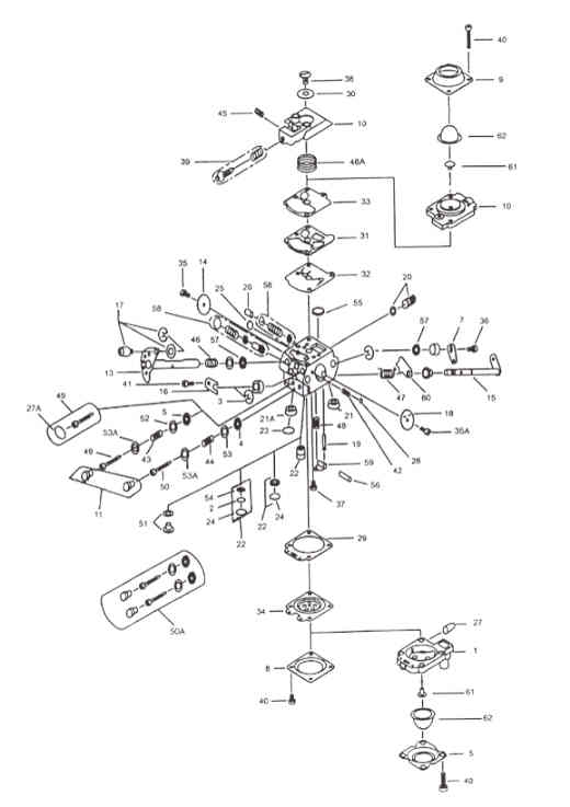

He guys,
I had to take the butterfly disk (throttle valve) off the throttle shaft to slide the shaft out of the carb, (part way not completely out) so that I could put a connecter on for the cable. Any way, did that and screwed the disk/butterfly back on, BUT the carb doesn't want to idle, even with the idle stop screw completely removed. My question is , Does the orintation of the disk matter? there a few stampings on it but I could not discern any up/ down, etc. differences. At 3800 rpm, the plane would never land while running!!!
Mike
Part numbers 14 and 13 on drawing,

Yes the disk notch should match up with the jet on the carb. I kept track of the orientation when I took mine off. If that disk is not on just right the disk won't fit in the carb right and the throttle won't close completely.

The disk has a bevel, and should be fitted the right way so the bevel face can snug up to the bore. It takes some light fiddling with the setup to get it snug before you tighten the screw.
When fitted the right way, the disk cutout will be located where the idle jets are.

But neither Pe nor Joe mentioned the HORRORS of that swaged screw fatiguing the shaft through removal and reinstallation.... ON SOME WALBROS this is a death sentence. There are threads to be found where adjusting that plate by removal of the screw has resulted in the purchase of a new engine (or at least the payment for an extensively-repaired and internally-severely-damaged USED engine).
Some of the Walbro shafts don't have enough meat to tolerate that screw coming and going, particularly if the threads exposed on the initial install were swaged like most of them are. Removing that screw strips out a LOT of the meat of the shaft hole and weakens it severely, which also forces one to rely overly-much on the holding strength of retaining compound or Loctite.
I know I'll take some shots for bringing this up, as it sounds like you have a good solution to re-adjusting that plate. But in all good conscience, I couldn't read of your repair without telling the tale of the ingested carb-butterfly-screw.
NO criticism to either Pe or JoeAP, they both know a lot, and are good guys..... sometimes I just have to be "Chicken Little"....

Bob,
Are you suggesting to use new parts whenever you disassemble the throttle butterfly?
Too much torque also will kill the new parts, because the construction is delicate whichever way you look at it, swaged screw or new.
I always wipe the thread with locktite before fitting it, and apply just enough torque to make it stick. Too much locktite would also cause heaps of problems, and the cure might well be worse than the desease.[&o]

I have limited experience with doing this, but the ONE failure of the screw to remain tight did it for me. My understanding is that not all screws are swaged behind that shaft where the threads are protruding, but I could be incorrect. I've been told that ALL of those that are held by screws in brass shafts ARE swaged.
So yes, I would recommend a new shaft and screw, for sure.

So far, all carbs I worked on had swaged screws. Surely something to consider, and check well.
I always have been able to use the old shafts with good results. Guess I have been lucky.

Bob, I 100% agree with you. If you need to take the screw out of the shaft out then have a new shaft ready to put back in with a new screw. Then use red Loctite. Be sure the disk is seated properly before the Loctite sets up. My experience is that all Walbro carburetors have a swagged screw. What I've found is when the screw is removed the swag will often cause the shaft to crack through the thin threaded area. This may not be readily apparent unless you use a magnifying glass and a bright light. At a minimum you will severely weaken the shaft due to brass removal. When your engine is running and it ingests the screw it is the kiss of death for the engine. Been there done that. Same goes for the choke shaft screw.

The Tillotson carbs are better in this respect. They use smaller gauge screws in a steel shaft. I do agree, that the Walbro is critical.

The amount of swaging on the throttle plate screws on the Walbro carbs seems to vary quite a bit from carb to carb. Some easily tolerate removal and reuse of all parts where others have the screw thread end swaged so much that it will indeed destroy the shaft when removed. You just have to use good judgement whether the parts are OK for reuse. I have also seen guys push so hard on their screwdriver that they bend the shaft where the screw goes through and any bending will fracture the shaft making it prone to failure at a later date. Again, a component inspection and good judgement is in order to determine whether the parts are reusable. A blanket statement that parts are not reusable is just not in order here.

It's easy to check and see if you have a swadge screw. On the opposite end of the throttle arm is usually the little stop part that hits the idle adjustment screw (most of us just remove this screw). There is a little metal plate that moves back and forth on the shaft. It is usually secured with a small screw. Just take that screw out and now you can rotate the throttle shaft all the way around. Now you can inspect the screw to see if it's been flared out on the end.
If it's flared out, Just hit the end of it with the dremel and a cutting wheel. Slice/grind the end of the screw off. Now blast the area with carb-n-choke cleaner to remove metal dust. The screw should back out without destroying the soft threads in the brass shaft..
When you put it back together, use red loctite. Clean all the threads in the shaft AND on the new screw with a toothbrush and some more carb-n-choke cleaner. Get all the oil off. Loctite is worthless if the threads are covered with oil.

I did as suggested ( align the cut-out on the disk with the 3 fuel holes (tiny!) and the carb idles down nicely... With the brand new Brillelli 26cc after 320z of gas thru it, it idles at 2300-2400. top RPM is about 7700-7900 RPM. BUT there is a significant miss present at all speeds. I have a optical kill switch in the circuit and the light blinks with every miss. I tried adjusting high and low speed screws per walbro instructions ( run 2 minutes untill warmed up, take up to top speed and adjust hi speed screw for top rpm, then cut throttle slowly untill it "4 strokes" and adjust low speed untill 4 stoke goes away then repeat slower and slower. No real difference. I understand missing can be a voltage thing, so I'm going to a) swap my batteries around to put my 5 cell in ignition, 4 cell for servos, if no result b) take kill switch out of circuit, c) buy a new race prepped big bore walbro off ebay?
