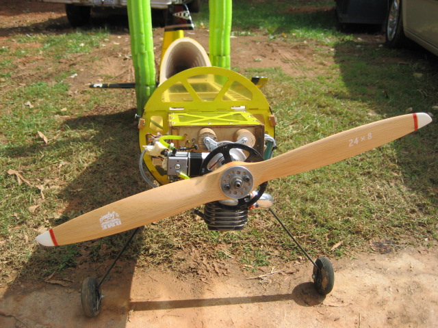

All mine is on a EF Yak. I did do some testing in the backyard on a 24 x 8 BME prop. I have been busy with working on my house so my Yak is collecting dust because of those reasons. I am running mine on a Karl from Canada header along with a CF pipe. I do not have 1/2 gallon on mine at this point I have flew it 2 times so that is my input along with these below links:
http://www.youtube.com/watch?v=7hgcGJAcXQw
http://www.youtube.com/watch?v=adU0mC5p4iM
Set up is BME 58
11†Carl from Canada 1†header
ES Carbon Fiber Pipe
EF Yak 54

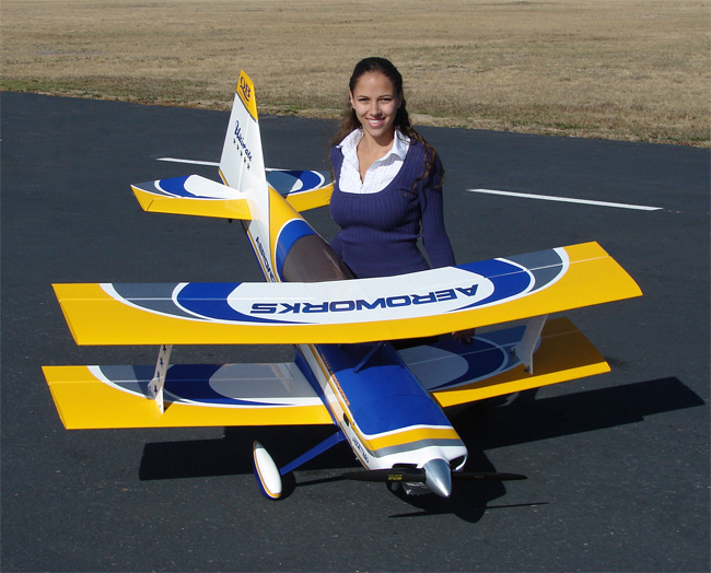

Hey torqmeister,
How is that Ultimate going? I'm very interested in seeing your install. I don't know the particulars on your Aero-works Ultimate. I'm on the list to get their new one, out this next year. I'm looking to get this motor for it, I think it will do the job, with smoke!!![link]http://aero-works.net/store/detail.aspx?ID=350[/link]
Thanks.
Don

Don that is going to be so kewl
