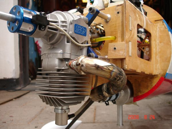

For comparence I use the first variant of the MVVS 45cc engine with the aluminium case (100 g heavier than the newer one with magnesium case) and use the small MVVS cannister (No 3206)
I get 6600rpm both with with a Mentz 24x8" and Graupner wooden props and 7200rpm with a top-Flite 24x8" prop. A 22x8 prop is way way too small for the MVVS 45cc gas engine and should be for the 58cc engine as well.
I run my engine on 2,5% all synthetic oil and 95oktan lead free fuel. Running in was done on what MVVS recommended; 4% all synthetic oil.
No lenghty running in time is needed on any MVVS engine, be it gas or glow!! This must be a severe miss understanding!
The engine should turn top rpm after just a tank or two.
MVVS uses the Brisk UR-17 plug for these early gas engines. The new one uses the much smaller NGK CM-6 plug.
4,8V-6v, 2000-2800 mAh NiMH cells is used for ignition. I use 4,8V , 2500mAh AA GP cells soldered together.

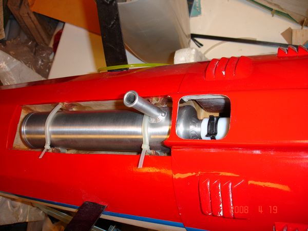

Just came out of field flying MVVS 58, Xoar 24x10, MTW RE2 pipe and DIY MTW header kit in EF Extra 88". Could not be happier how the motor is working. It's still under break-in, but I have had zero deadsticks, automatic choke is working fine and vibration is minimal. Few liters more and I can switch to 2% fuel.
