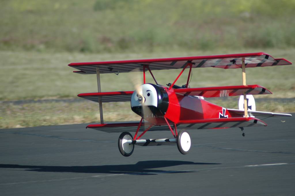

guys,
i am currently reading thru this whole thread.
i'm pretty much 99% sure that this engine is the way to go for my new project.
i want to use a 20" prop, and it seems this engine will do it with ease.
the one thing that keeps nagging me though as i don't know much about running gas thumpers yet is that everyone keeps referring to the use of this engine in 3D type planes.
is that what the DLE 30 was meant for, and not to be used in slow type WW1 models?
intended project to be powered

I ran a Xoar CF 20x8 on my DLE30 and it turned 6500rpm static. My enigne is not broke in yet and I wasn't happy how this prop performed on my Giant Stick. I prefered the performance of the Mejzlik 18x10. It had better speed and vertical than the 20 inch prop did. I feel it was a bit too much load for the engine. A 20x6 would be the ticket or a 19x8 on your project.

thx Super08,
i know the model was designed around the Zenoah G26, but things progress.
time for new blood in this design and you are right, a 20x6 would be right for this kite...........doesn't need to go too fast, just needs power to get it out of trouble.

Some more to think about. If that Tri-plane was designed around a G26 with fly-wheel ignition....that may be the way to go. If you Place a DLe30 on it you may have a hard time getting enough weight in front to balance. I do not know that....but it something to consider! Capt,n

you're right Capt,n and i am going thru build threads to see other equip location.
what i haven't seen is the use of the forward firewall area above the engines being used for the batteries and stuff. you can bet i am going to rework things to try and make this work.
too many good things said in this thread about this engine to not try.
