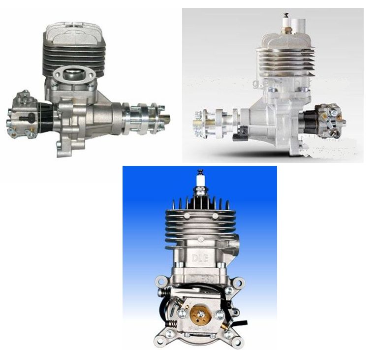

<div style="margin: 0in 0in 0pt"><font size="2"><span style="font-size: 10pt">Can someone please post some pictures of <u>side views</u> (each side) and one <u>rear view</u> of the DLE-30 rear carb engine <u>with</u> the factory muffler?</span></font></div><div style="margin: 0in 0in 0pt"><font size="1"></font></div><div style="margin: 0in 0in 0pt"><font size="2"><span style="font-size: 10pt">All pictures on the internet show the muffler at an angle. I need to be sure that the muffler will clear the firewall. I have not bought an engine yet but will need to use a shorter length standoff. I am trying to determine how far back the muffler protrudes towards the carb (back of the engine). I posted pictures below as an example but need them with the muffler. </span></font></div><div style="margin: 0in 0in 0pt"><font size="1"></font></div><div style="margin: 0in 0in 0pt"><font size="2"><span style="font-size: 10pt">Thanks.</span></font></div>
Old 02-06-2011 | 09:37 AM
  #4394
w8ye's Avatar
My Feedback: (16)
Posts: 37,576
Received 11 Likes on 10 Posts
From: Shelby, OH
Default RE: NEW DLE30!

<p class="MsoNormal" style="MARGIN: 0in 0in 0pt"><span style="FONT-FAMILY: "Courier New"; FONT-SIZE: 10pt">w8ye,
</p></span></p><p class="MsoNormal" style="MARGIN: 0in 0in 0pt"><span style="FONT-FAMILY: "Courier New"; FONT-SIZE: 10pt">
 </p></span></p><p class="MsoNormal" style="MARGIN: 0in 0in 0pt"><span style="FONT-FAMILY: "Courier New"; FONT-SIZE: 10pt">Thanks for the quick response and nice giant pictures. Those standoffs look to be about 20mm in length. What is the length?</span><span style="FONT-FAMILY: Arial; FONT-SIZE: 10pt">

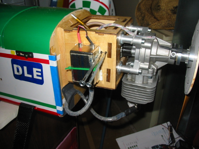

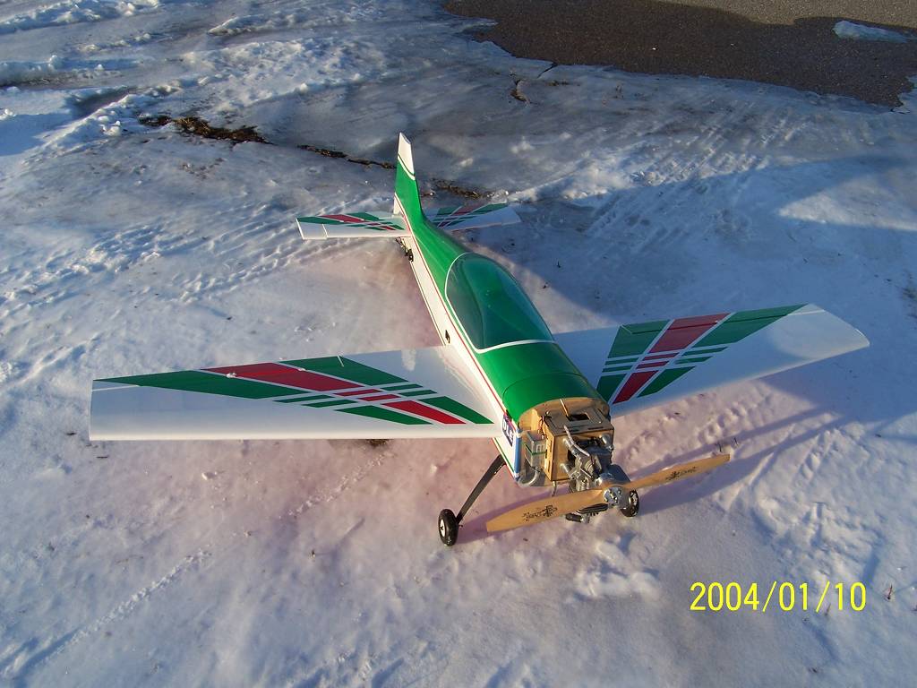

Old 02-06-2011 | 12:01 PM
  #4396
Posts: 12,957
From: Hesperia Michigan, MI
I can go measure the stand-off on my airplane....it is one of the airplanes in the photos just posted. Capt,n
Old 02-06-2011 | 12:22 PM
  #4397
w8ye's Avatar
My Feedback: (16)
Posts: 37,576
From: Shelby, OH
Those pictures are from this thread. I just went back and looked for something that showed the muffler close to the firewall.
Old 02-06-2011 | 01:03 PM
  #4398
Posts: 12,957
I did measure the stand-off length. It is .800 or 800/1000 of a inch. I choose that length so the exhaust will be close...but most important.... I can adjust the fuel mix through 2 , 1/8 holes drilled just back of fire wall. It works out good. I am going to get a better exhaust later. It is ok for anyone to use any photos I place on RCU....I did it to try to be of a help. Best Regards Capt,n

Old 02-06-2011 | 01:41 PM
  #4400
Posts: 12,957
Hear is another....it shows 2 small screw drivers placed in holes to adjust the carb. Capt,n
