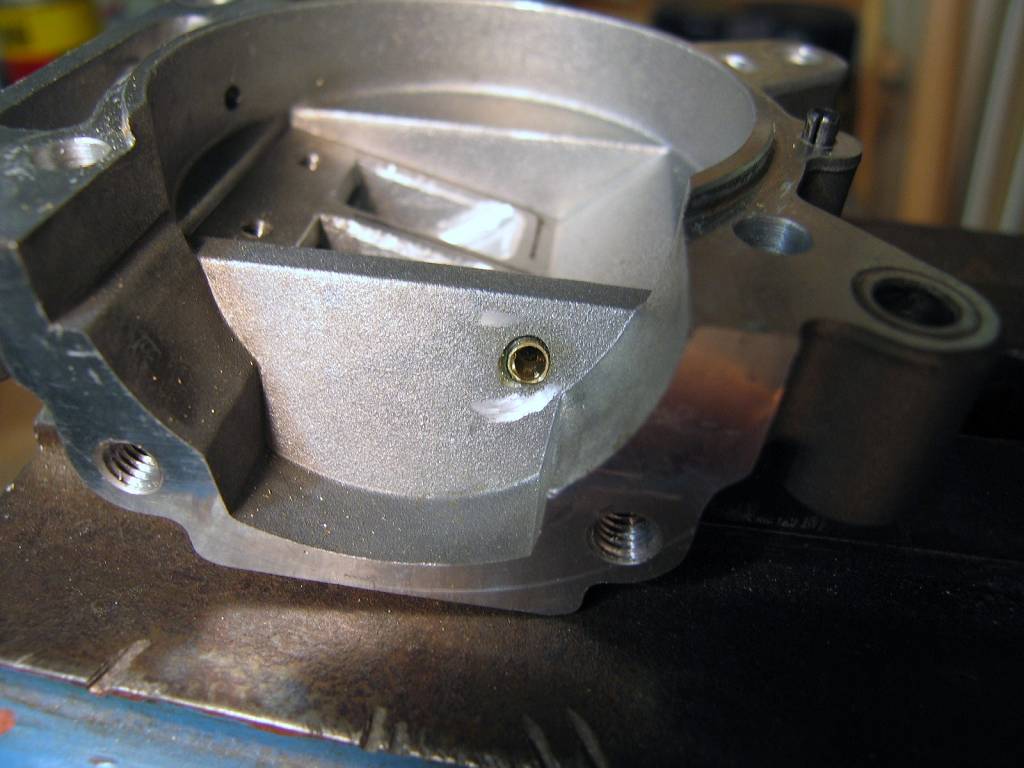

Okay, I took this engine off my plane and back apart to show what I did to it back when we got our first shipment of engines, when I did this it was not because it died when it was tilted, never noticed that but it may have. It was obvious to me through the ground running and tuning I did that there was fuel puddling next to the reeds. It's possible that a nipple with a check valve in it or in line to another nipple in the crankcase may do the same thing, outboards use the same thing to prevent pooled oil from loading up in them as well. They use the pooled oil routed through check valves to lubricate the crankshaft bearings. Anyway here are some pictures, one of a new un-touched crankcase back, then the modified one. If this is attempted I must stress caution, the case is not very thick and can easily be ruined by grinding all the way through, it was done by hand with an 1/8" ball mill and then the edges were smoothed more with a fine file, enjoy.

Jedijody, Nice pics. I can see where some fuel might pool up there.I would guess if you guy's are having the tip&quit problem this is you're solution.

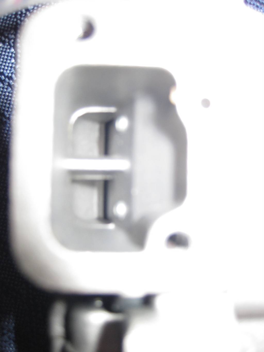

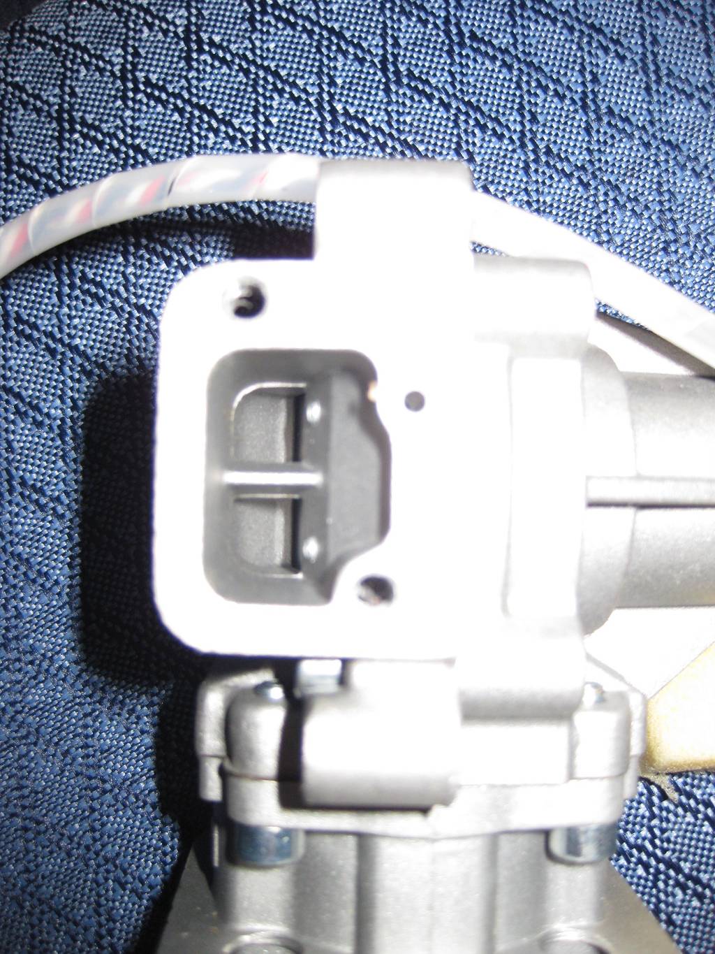

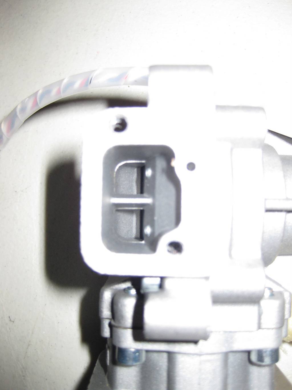

Jody,
Here are a few pictures from the carb intake side. I did not want to take the engine apart until you look at the pictures. Plus I want to make sure I don't void the warranty. One side has a large area of extra casting material.

The ridge isn’t large at all and would not raise my eyebrow if I were not looking for a source for puddling but is one of the areas that I smoothed out on mine, you can see it in the pictures. I don’t think this area is the whole problem and my not need to touched at all. Ralph Cunningham modified a different area that may be the bigger contributor. Both of our mods had positive results but were not perfect, I think we’re on the right track though.
After further studying of this crankcase and re-reading Ralph’s descriptions I think I understand what he did. So in a bold move I installed a REAL drain for the puddle. I had to think about this for a while because I could not duplicate the dying on my test stand. Engines mounted on it are at a 90 angle to gravity, on a plane, on the ground, and in slow speed flight they are at a higher angle of attack. The ledge right below the reeds would then be able to hold a fair amount of fuel, definitely enough to kill an engine at a low idle. I will modify the way this engine is mounted on the test stand and run it later today.
Just this morning I got the first email from a customer that is having this problem and is sending his engine back for repair. If my testing goes the way I hope, I will install the drain only on his engine and test it.
