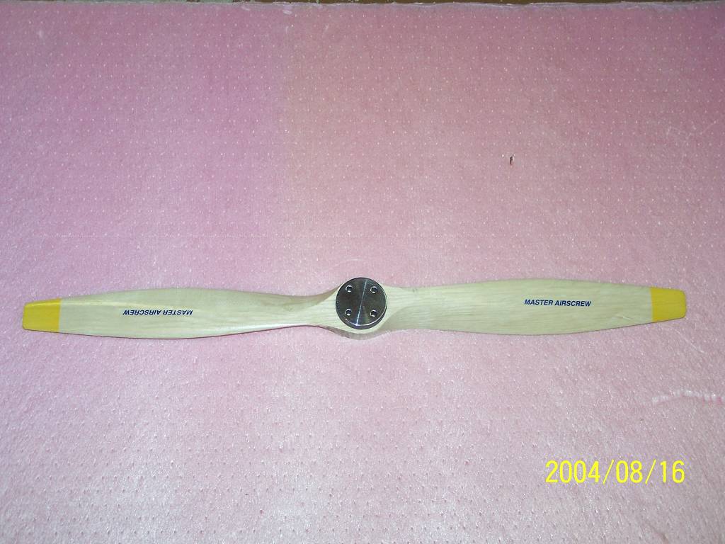

Well nnot much happening, so I will post a photo of my one of a kind DLE30 prop drilling jig! Capt,n
