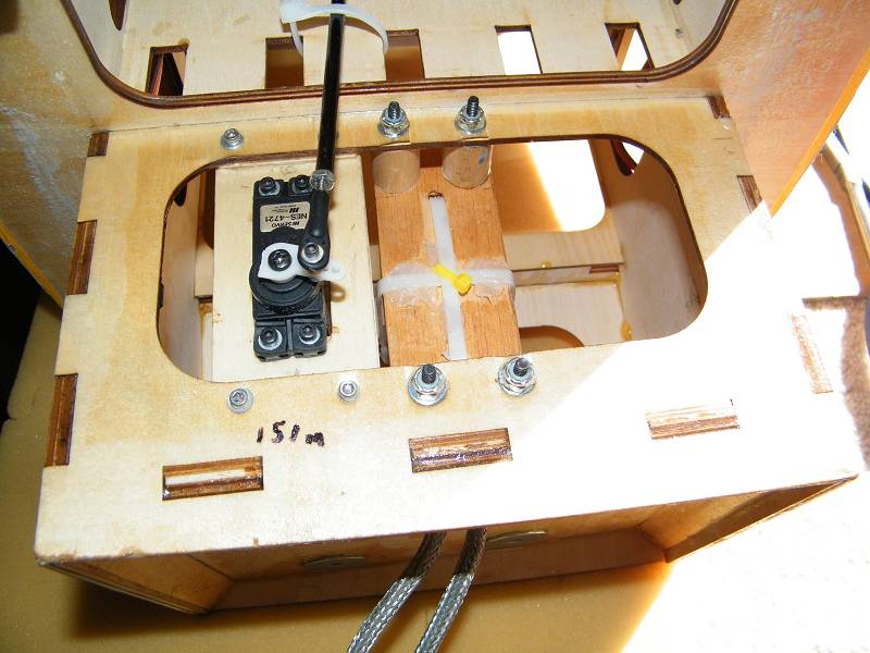

Some pics. We will not go into the debate about how carbon rods might generate rfi. Take a real close look at the installation before you go in that direction. All my planes use similar installations, all using 72mhz radios. If you use a product that can flex, it eventually will, at the worst possible time.

Old 07-18-2009 | 12:08 AM
MetallicaJunkie's Avatar
Joined: Sep 2006
Posts: 5,464
From: Donna, TX
Default RE: throttle push rod set up
Im with TOM, BJ to BJ link is the way to go

I've seen 3 snap on ball joints loosen and pop off with in the last 3 months. They were all planes that had a lot of flights on them. Vibration will wear them out after time. I'm not saying it will happen 100% of the time, but it's something to watch for.
I use a set up like T.O.M has pictured
Old 07-18-2009 | 09:28 AM
Posts: 18,602
From: Valley Springs, CA
Don't use snap on ball links, always bolt on. Even the bolt on types should be checked perodically for wear, and using a flat washer over the top of the ball, under the bolt, adds an extra layer of security.

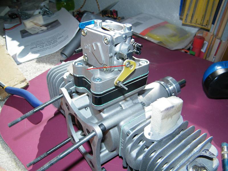

Here's mine.
Old 07-18-2009 | 10:04 PM
JoeAirPort's Avatar
My Feedback: (41)
Joined: Aug 2003
Posts: 10,259
From: Milwaukee, WI
I like that spring. Absorbs vibrations. Cool.
