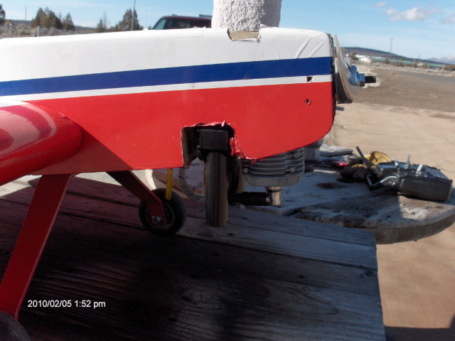

Looks like plenty of room for a spinner to me with an APC 18x6W prop.

Well I didn't say anything bad about the DLE, I simply showed proof of false claims by someone else. As for the crack against the apc of "not being a real prop" I could care less. If I had the engine mounted in a different I would try something different. In the twist an APC 18x6w turning 1550 -8750 does just fine.

If anything negative is posted in the Syssa thread it gets deleted. The APC 18X6W has a very thin hub for that size prop, Add a tru-turn back plate (approx. 3/16") and spinner nut adapter and you'll be running out of room unless you buy a short shaft adapter and drill a 1/2" hole in your prop. The propshaft is short as some owners have mentioned, period. I had recommended a true replaceable propstud to Todd prior to the motors release. Fell on deaf ears but hey it's his design. To me, a 8mm shaft belongs on a 1.50 cu. in. motor. But it's all good. It's just toys and we all want to have fun.
