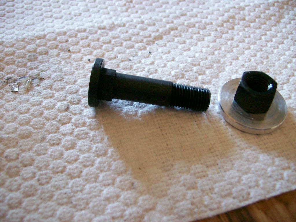

Here are the pics of the single bolt prop holder I came up with, the only trouble is you need a deep well socket to reach the 11 MM hex, I had to drill mine deeper to reach the original one let alone one the ones I made.

Looks good. Did you tap it for a 10-32 spinner bolt?
I wonder why DLE uses the threaded stud on the end of the crank rather than a seperate stud that screws into the crankshaft. Any thoughts?
#375
Very simple and effective, nice.
A note about the new Rcexl tach. I found it read differently than my optical tach by about 100 rpms if I recall when I tested my DLE30. I forget which way the difference went, but if I recall the optical tach I have read lower. It is the same as the one Jody has in the video. I am going to fool with it some more when spring arrives. Either way I think the Rcexl oneshould be more accurate as it uses the ignition pulses.
