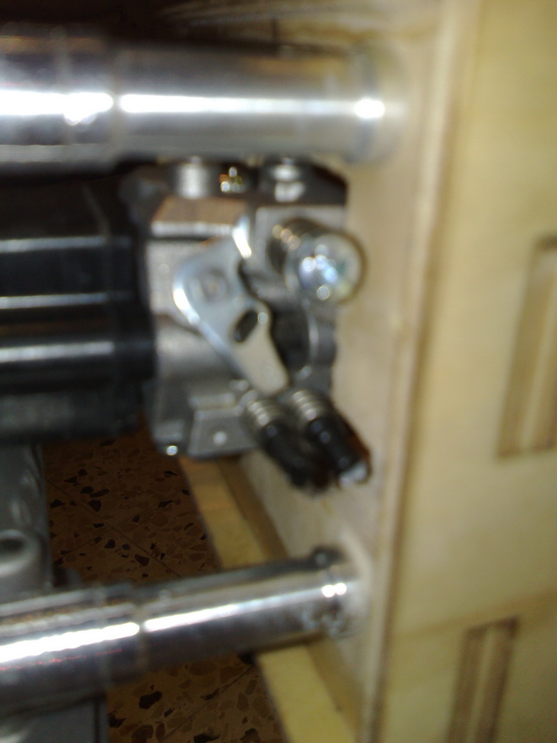

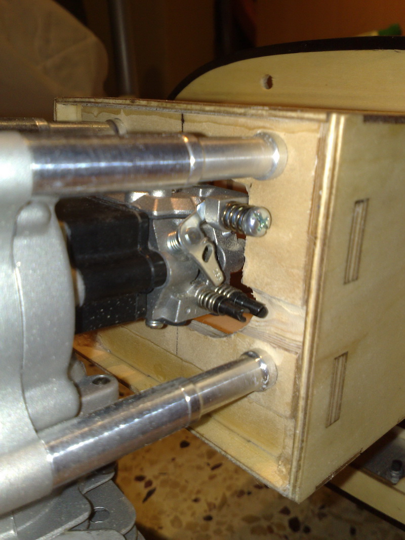

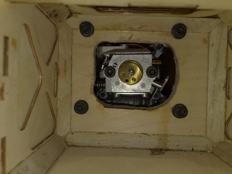

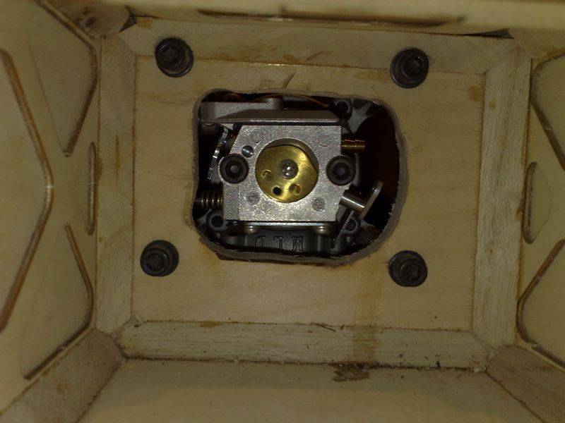

I think you may need to cut a bigger circle hole in the firewall in order that the carb will best fit but it is not too big issue. (of course if we are talking about the Sabach 342)
but i am not sure since i didnt install it yet and maybe i am wrong and if you add the 3mm wood spacers maybe you wont need to cut anything.

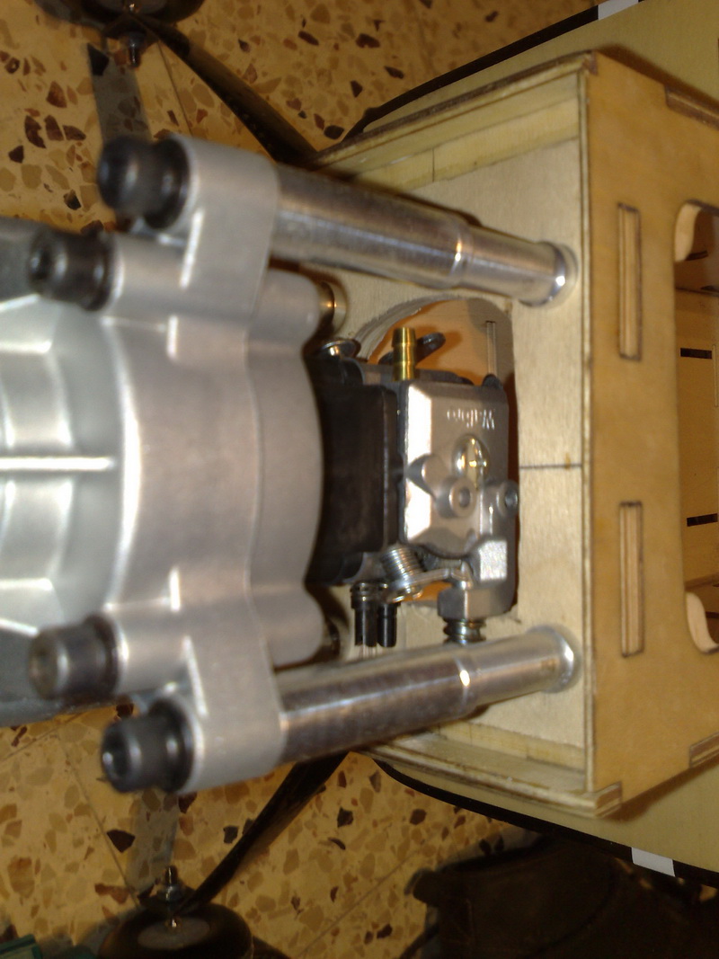

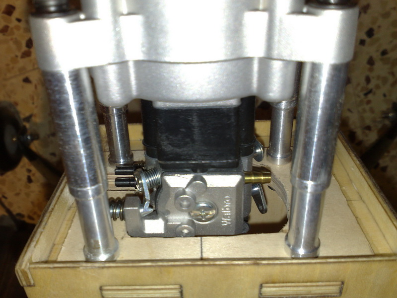

Hi George

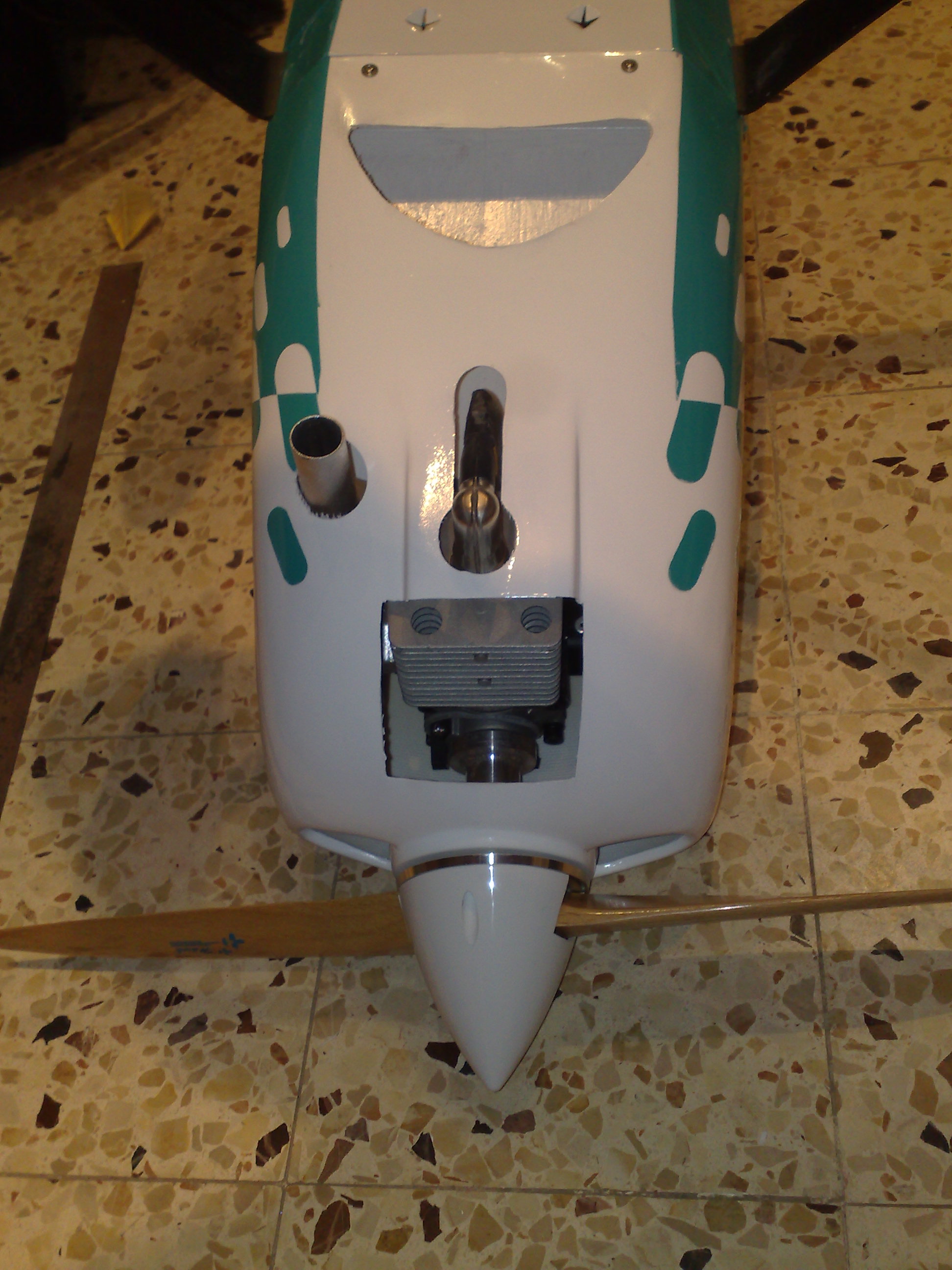

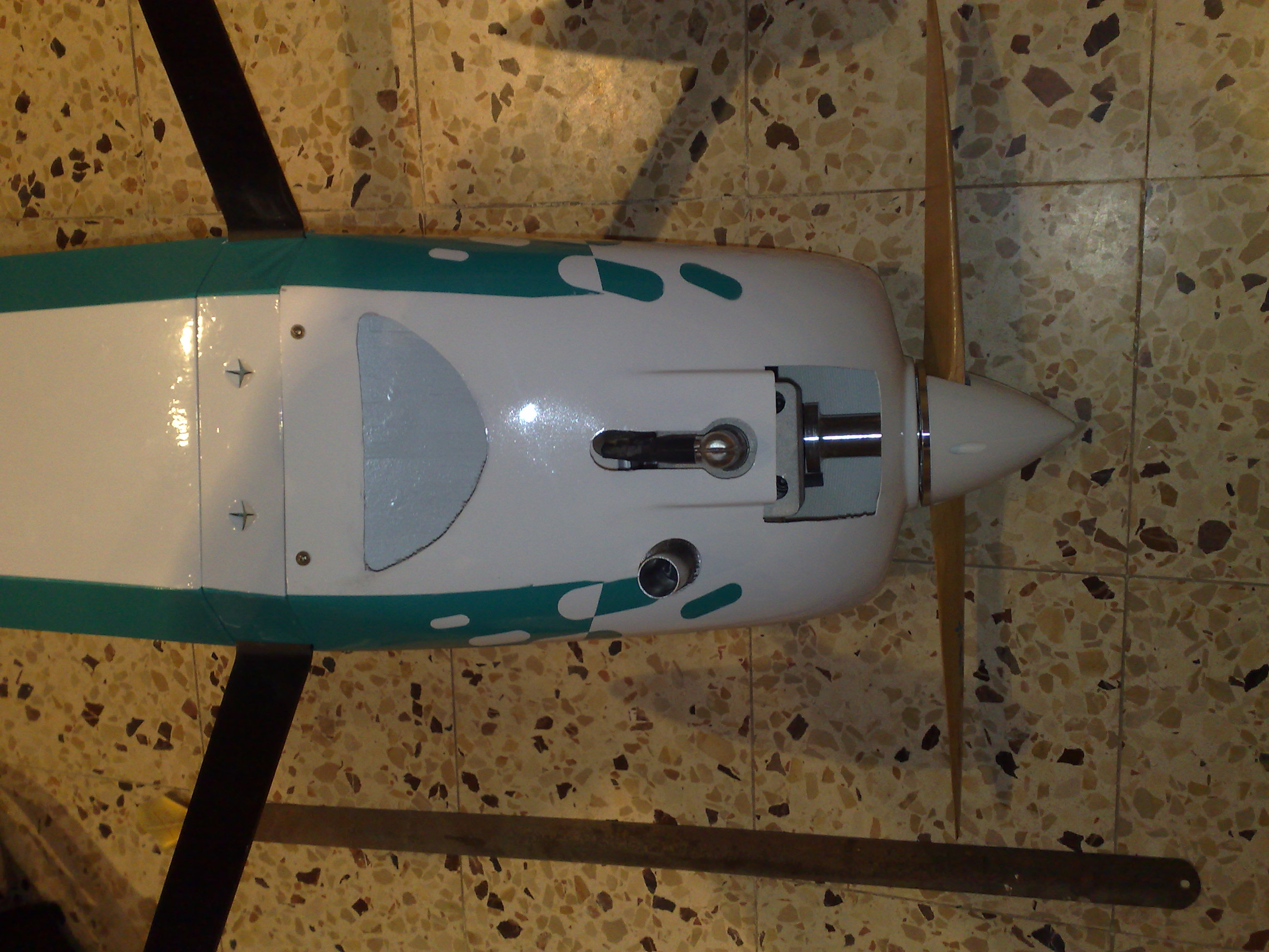

Since I have notice that you wait for my progress I have decided to mount the engine on my Sbach 342 so you will able to see how it is installed or fit.
Please note that I have added 3mm wood in order to have the engine go out a bit from the cowling and after this 3mm i have notice that it is only about 1mm to 1.5mm out of the cowling, so I guess that I will add additional 1mm spacer.
attached some pictures for your reference.
Hope it will help.
Shaddow.
Hope it will help.
Shaddow.

wow ...very nice installation .....great!!!as i see it fits perfectly inside...and something else... everybody complains about that the airplane sbach 342 is tail heavy with the dle30 and that they have to put weight or the batteries all in the front and still the plane is in the tail side..heavy ...as you have see in the manual ...its says for the cg 5 1/2 '' that is far behind almost 1'' from the carbon tube and all are talking for a cg in the carbon or just behind the carbon ....( 12CM istead of the 13,7cm that the manual says peak model or redwing same airplane) this engine be heavyier but more powerfull will solve this problem
thats why i am very intresting for this engine!!!!!
THANKS SHADOW AGAIN !!!

Yet i dont know how much weight I will need to add but I planning to install additional fuel tank close to the CG and a smoke pump. I am planning to install the smoke pump really on the front.
Also I have no problem to install the batteries (2 or 3 LIPO batteries) and the ignition also in the front.
I hope after all that no additional weight will need to be added.

Shaddow: nice pics. May I suggest where the posts meets the firewall (and the rear side)? I notice there isn't any baffling on the 2 air-intake above the cylinder. May I suggest that you place baffling to help improve airflow/cooling. Engine temp has a tremendous effect on performance. The more air cooling you can force the the air to pass over the hot spot. The better off you will be. On the top end, you can see a 10-18% difference. The current setup will Oh, remember to check for tightnes after each tank during the 1st couple gallons.
Luckymacy: For the next 2 months, we are not likely going to offer the rear muffler version for MLD-35. If and when we do, it will be offered as MLD-35R. The engine can be rotated in any direction to best fit your cowl! That is why the rear muffler is not as critical as it may appears.
note, we not yet ran into a case where there was an absolute necessity to use a rear muffler.

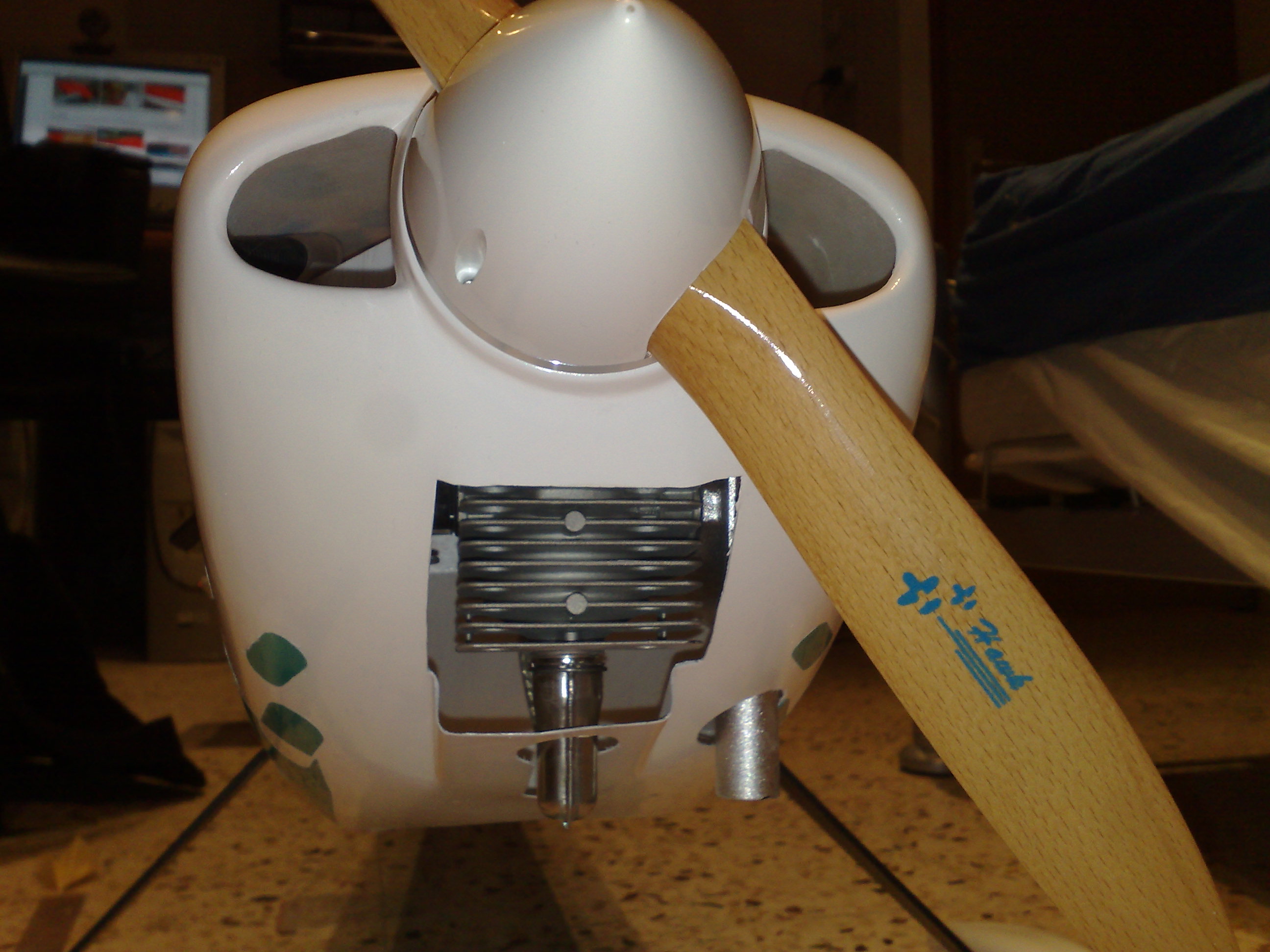

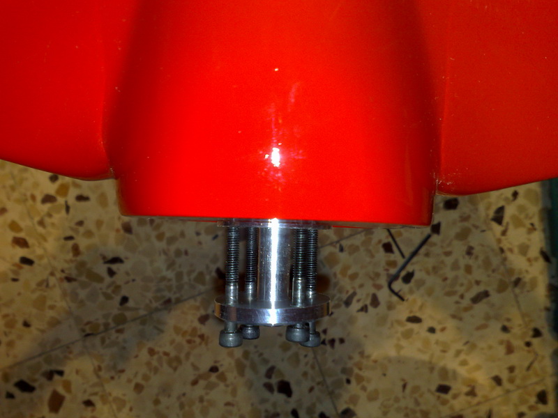

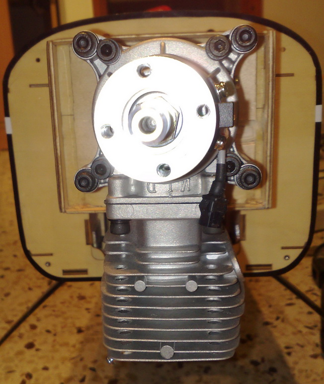

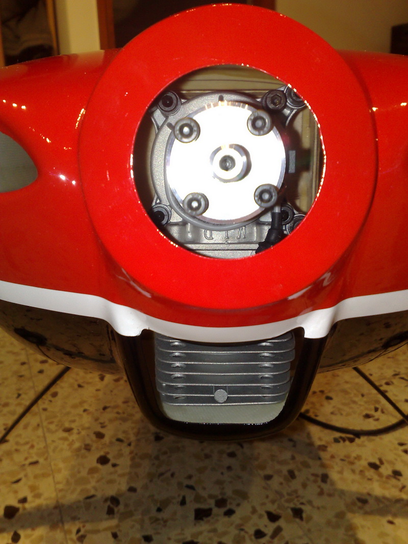

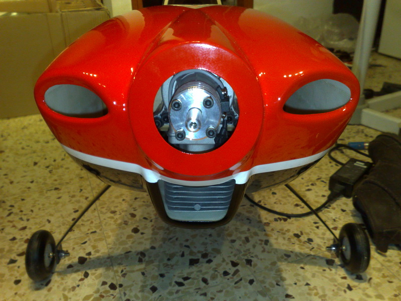

Hi Steven
I didnt quote understand what you mean by buffling.<span style="font-weight: bold;">?
I have added some more pictures.
Also added pictures of my EDGE 540 that has the MLD 28CC installed. (and one picture of how it lookes when it is assembled from the manufacure site since I didnt yet have the chance to get pictures of my own)
I hope that with this folowing weekend I will finally have its test flight.

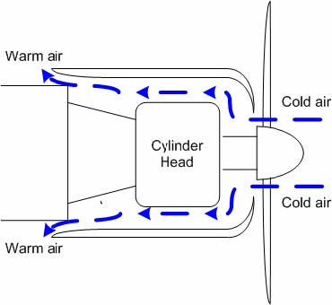

Sorry Shadow: I meant baffling....
In the N.A. MLD-35 Manual, there is a small Q&A section on baffling. Here it is;
"Q22. How important are cooling and baffling for MLD engines?
A22. Baffling is the technique to channel / direct all intake air over the cylinder head, thus forcing air to flow across the engine rather than bypassing it. This is a very effective cooling method on air cooled engines. Deflecting or baffling of the air to and over the cylinder is highly recommended for proper cooling. The idea is to get all of the cool air that is coming through the air intake opening(s) to hit the middle of the cylinder(s) directly, and then be forced over the cylinder(s), creating turbulent air moving through the cylinder(s) fins. The freely flowing, but directed and turbulent air between the fins provides the maximum cooling for an air cooled engine. Without baffling the air (similar to water property) will take the path of least resistance. Some incoming air will bounce off the cylinder(s) and the rest will escape around the cylinder(s) without coming into contact with the cylinder(s).
To ensure constant flow of cold air around the cylinder, and to reduce the air pressure build-up inside the engine cowl, the hot air exhaust exit must have a much larger cross section area than the cold air intake. As a rule of thumb, allow 4 times the area for exhaust air than intake air, this may be achieved by reducing the intake area (as in a radial type cowl) and expanding the exhaust area. Air entering the smaller cowl opening will expand and cool existing at a lower velocity, further aiding cooling of the engine."

Hi Steven
Yes it is right, the cowl isnt finished yet and isnt cutted yet, it is just to show how the engine is mounted.
you can see with the EDGE pictures that there is enough cooling.

Here is an excert from one of our engine manual thanks to Roger Lee (Australia).
"Basic laws of physics
1. Air expands when heated. Volume of hot air is greater than the volume of equal mass of cold air.
2. Volume is an inverse function of density. Increased air volume reduces the air density.
3. Increased air velocity leads to increased air volume over a constant flow area.
4. Air will flow down the path of least resistance.
5. By the law of thermodynamics, because the temperature of air is always lower than the cylinder head of a running engine, heat will be transferred from hotter cylinder head to the cooler air.
Efficient Engine Cooling
Efficient cooling aims at transferring the largest amount of heat from the cylinder head to the largest amount of cold air surrounding it. The most effective method is called Baffling. Baffling is the technique to channel / direct all intake air over the cylinder head, thus forcing air to flow across the engine rather than bypassing it. This is a very effective cooling method on air cooled engines.
Cooling for Various Engine Configurations
Type 1 – Scale model of planes powered by radial engine. E.g., Corsair F-4, FW-190 (see pic)
Type 2 – Scale model of planes powered by liquid cooled engines. E.g., Mustang, Spitfire. (this is what Shadow has)
Hint: use a baffled intake below the huge spinner to redirect airflow on to and around the cylinder head. Note that the host engine exhaust gas exits below the cooling air. This cooling configuration gives sufficient cooling to the engine. It also helps to keep the model clean during flight. The optional scale exhaust not only gives a scale look, it also functions as additional exits for warm air inside the engine cowl.
