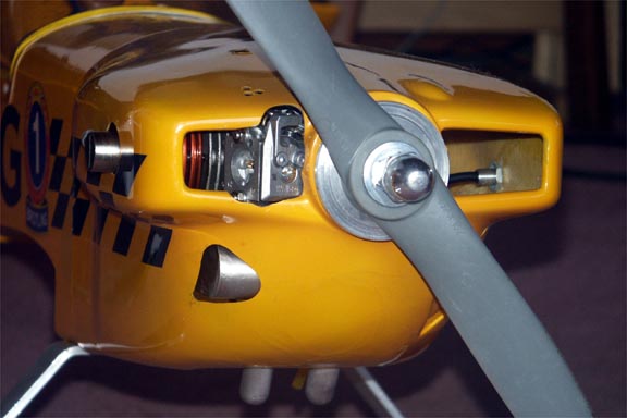

This MVVS 26cc with its Walbro carb sitting up front in the breeze never exhibited any mixture ill effects in the installations shown in the pictures below. One of the planes is a Sig CAP 213EX and the other is an Ultra-RC Giles 202. Are there any opinions as to why it is immune? Is the problem engine specific or did I just get lucky with these two installations?

Most engines do not have a pressure issue. People read a couple of posts about the problem and suddenly think all gas engines have to be equipped with a balance tube. Not so.

Both installations have the balance hole away from the direct impingement of the airstream. As long as the airflow through the cowl isn't turbulent, you may not need to worry about it. I am
