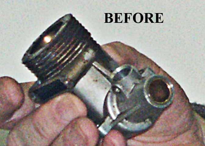

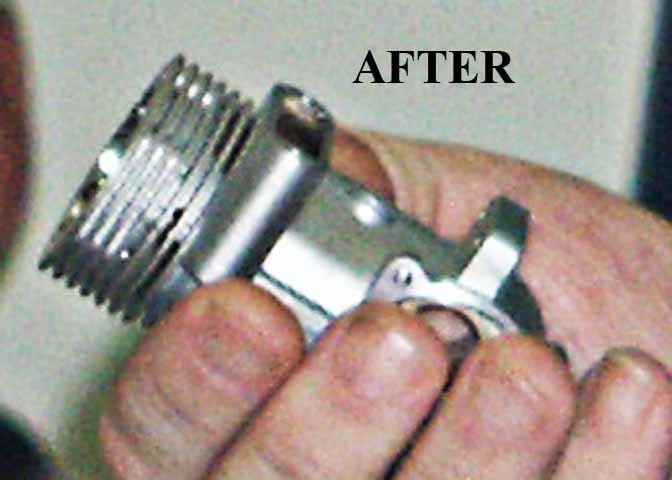

ahicks,
Here are a couple of before-and-after pictures showing the effectiveness of the anti-freeze treatment that you described. The gentleman whose hand is holding the engine did a show and tell at a couple of club meetings in 2002 to describe the process.

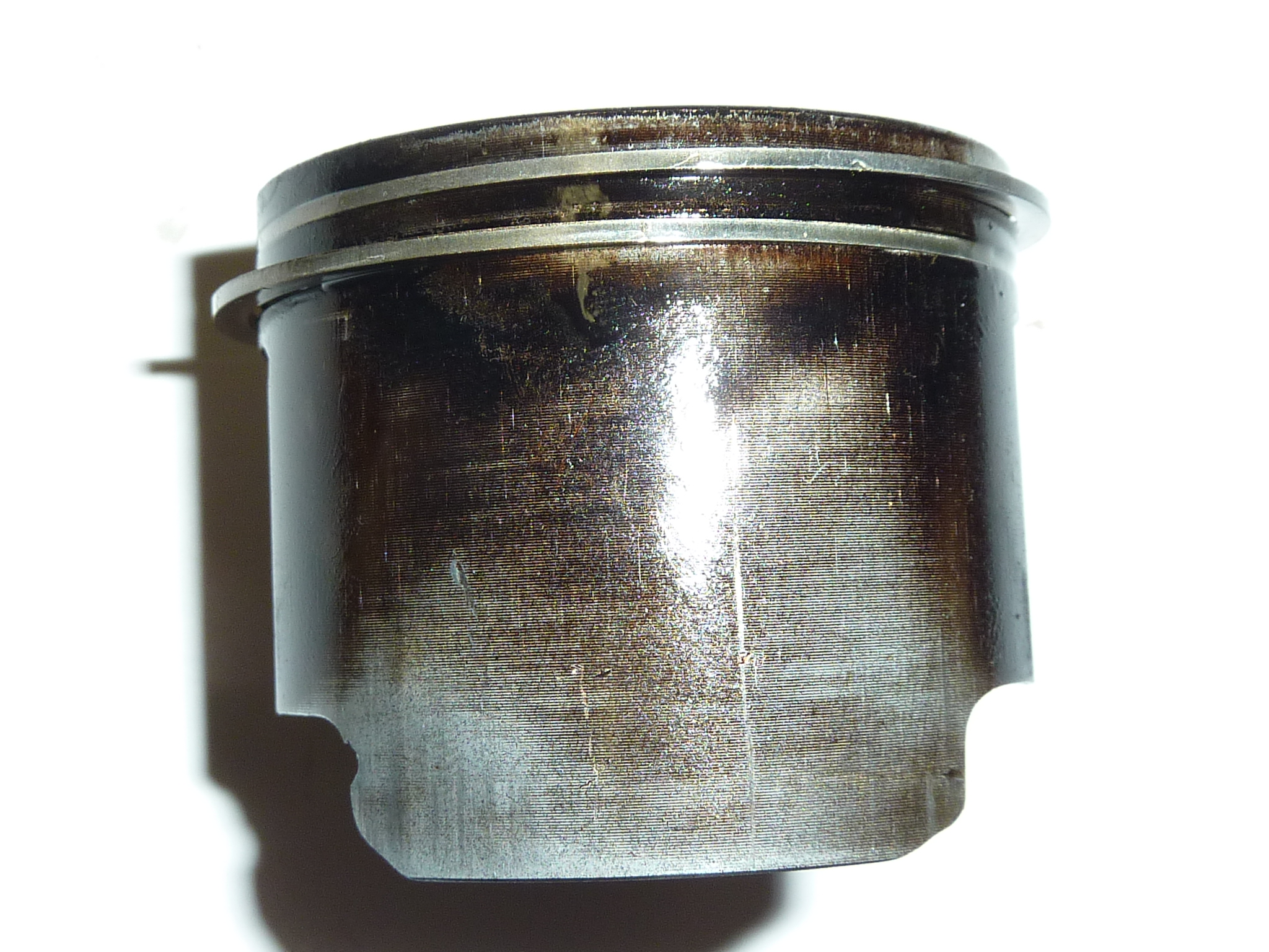

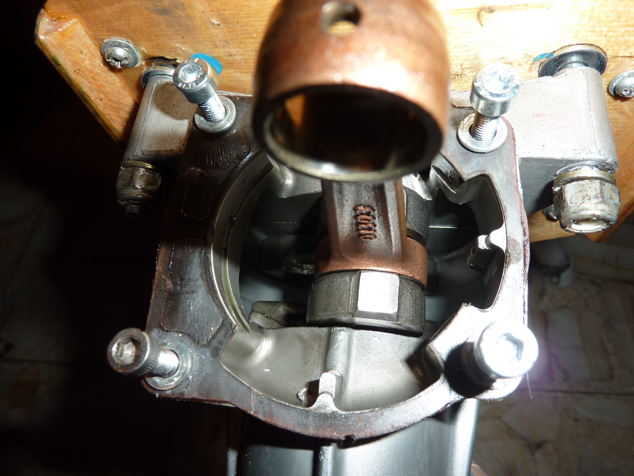

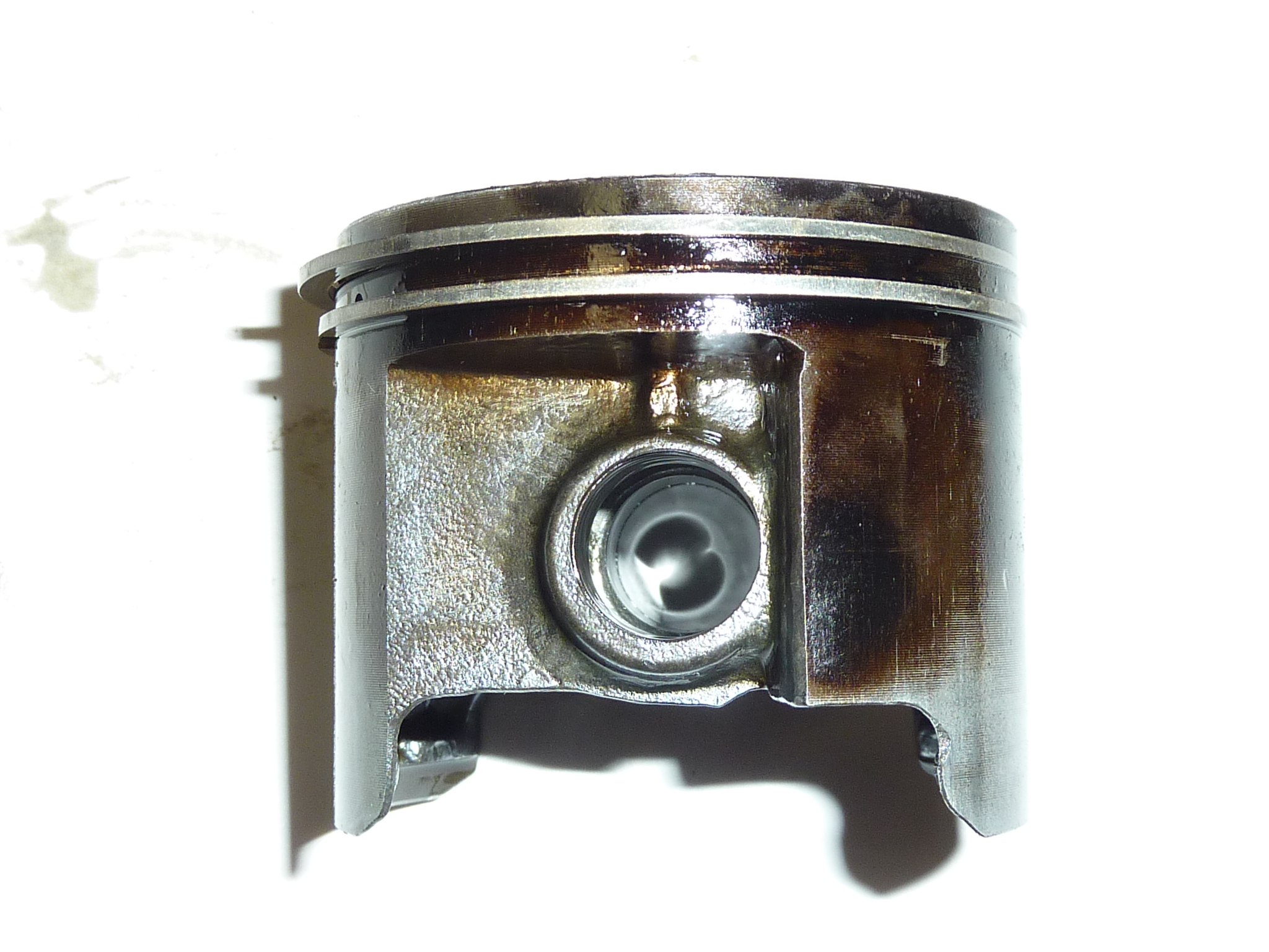

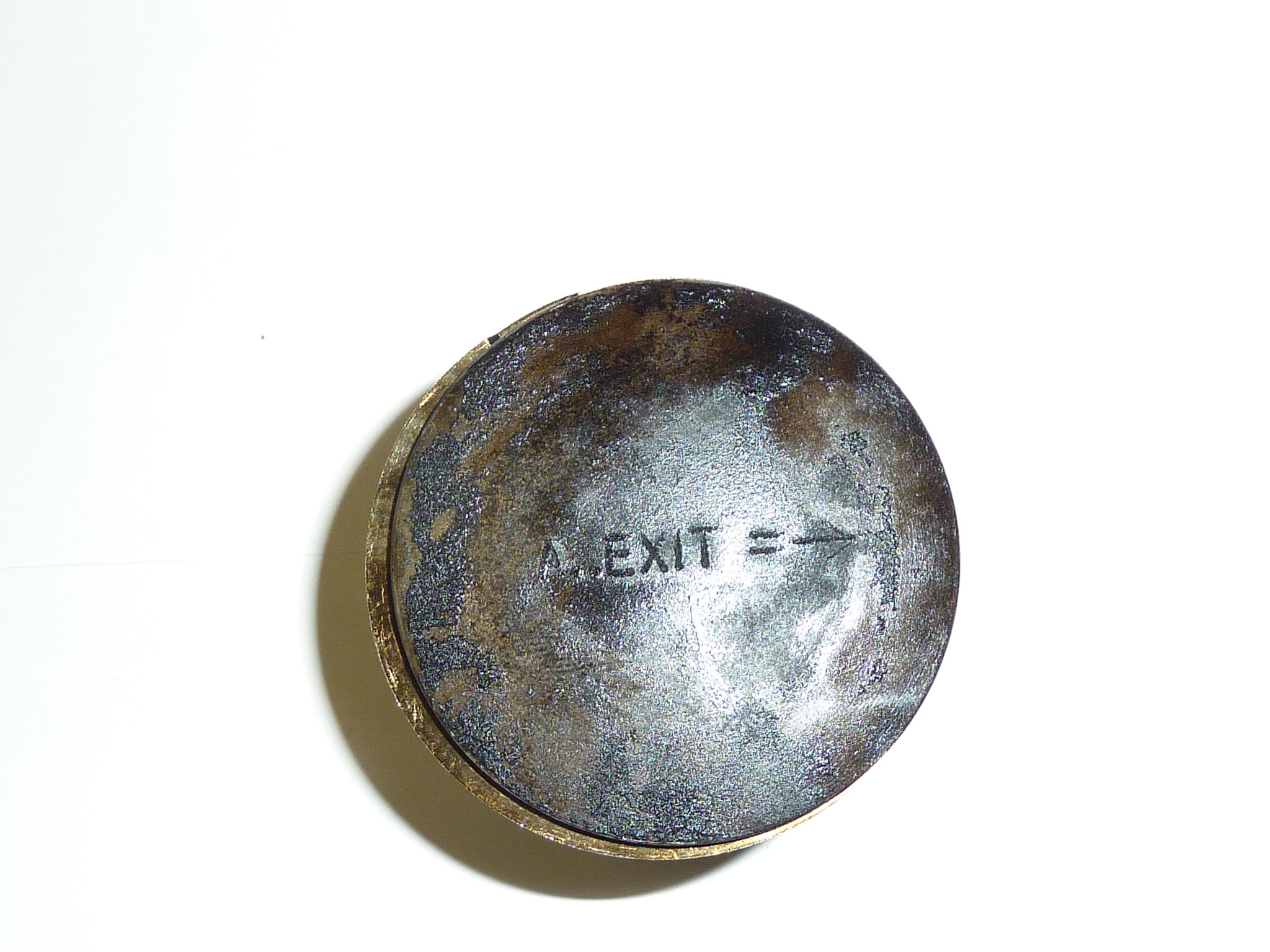

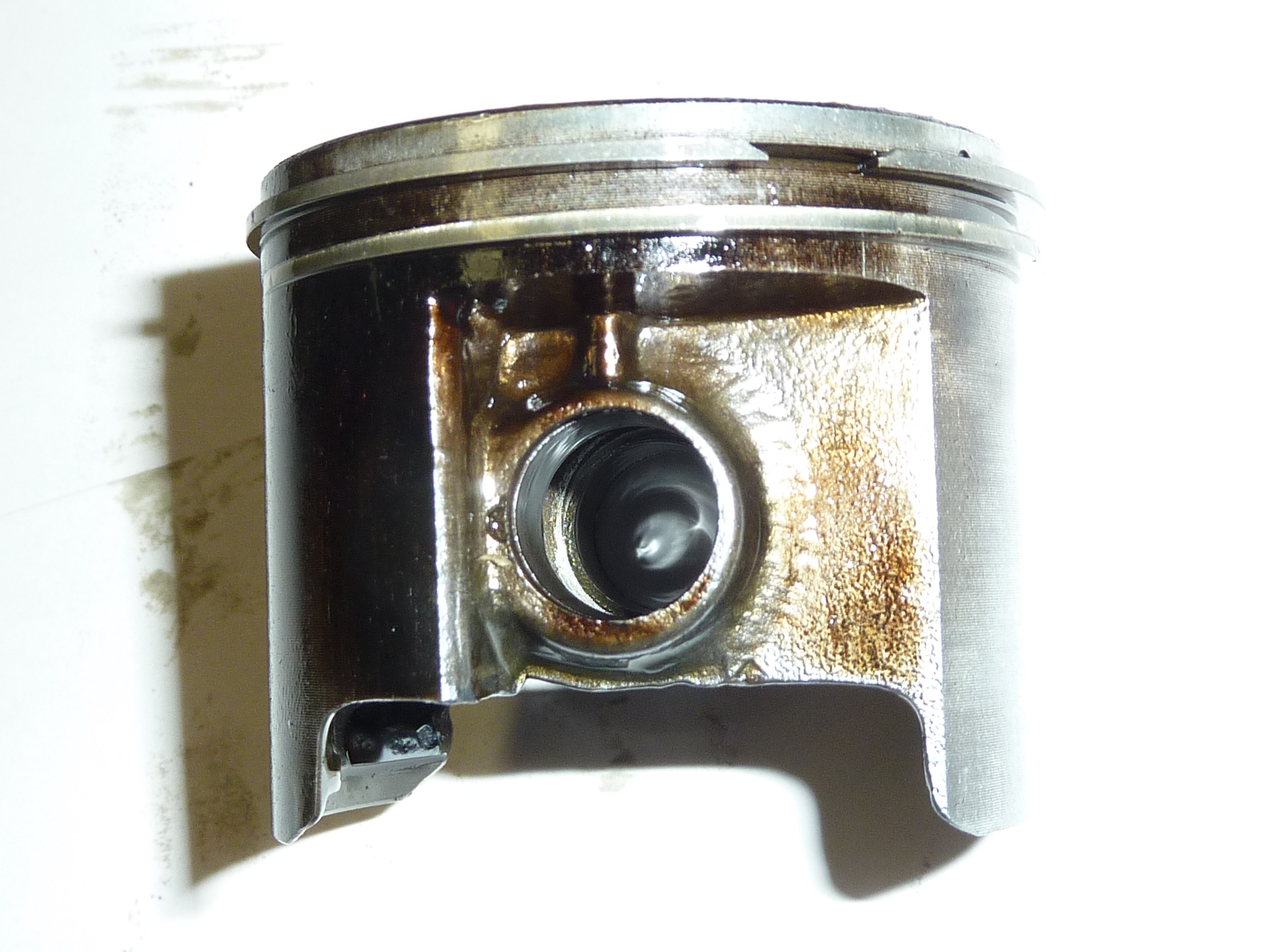

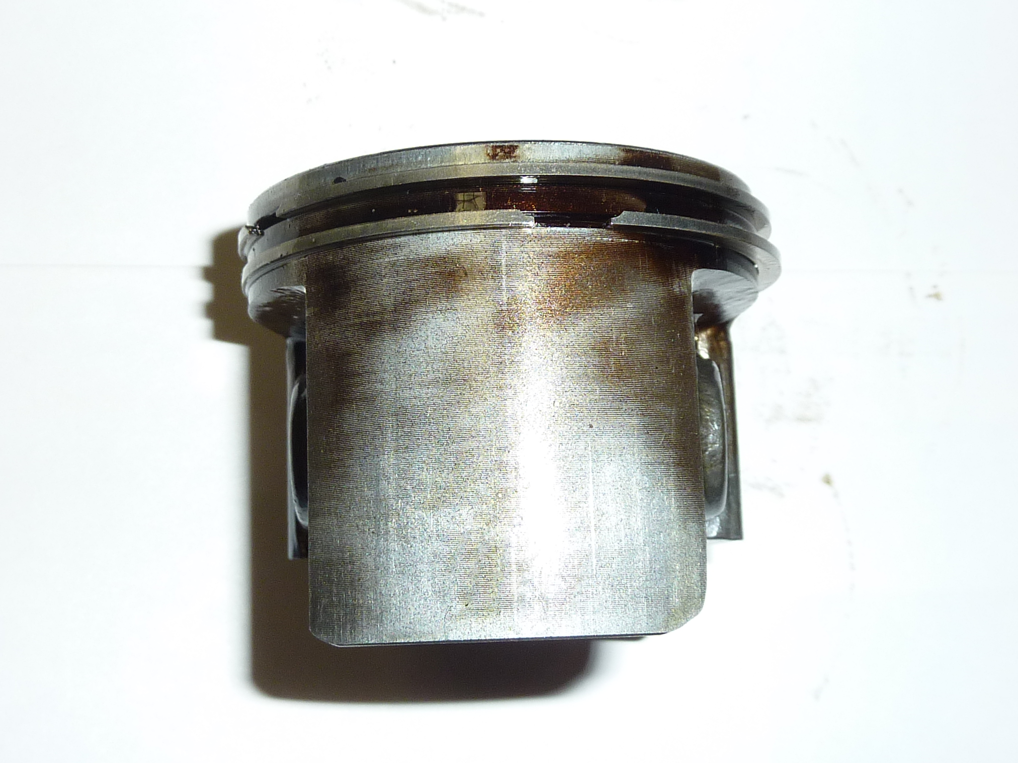

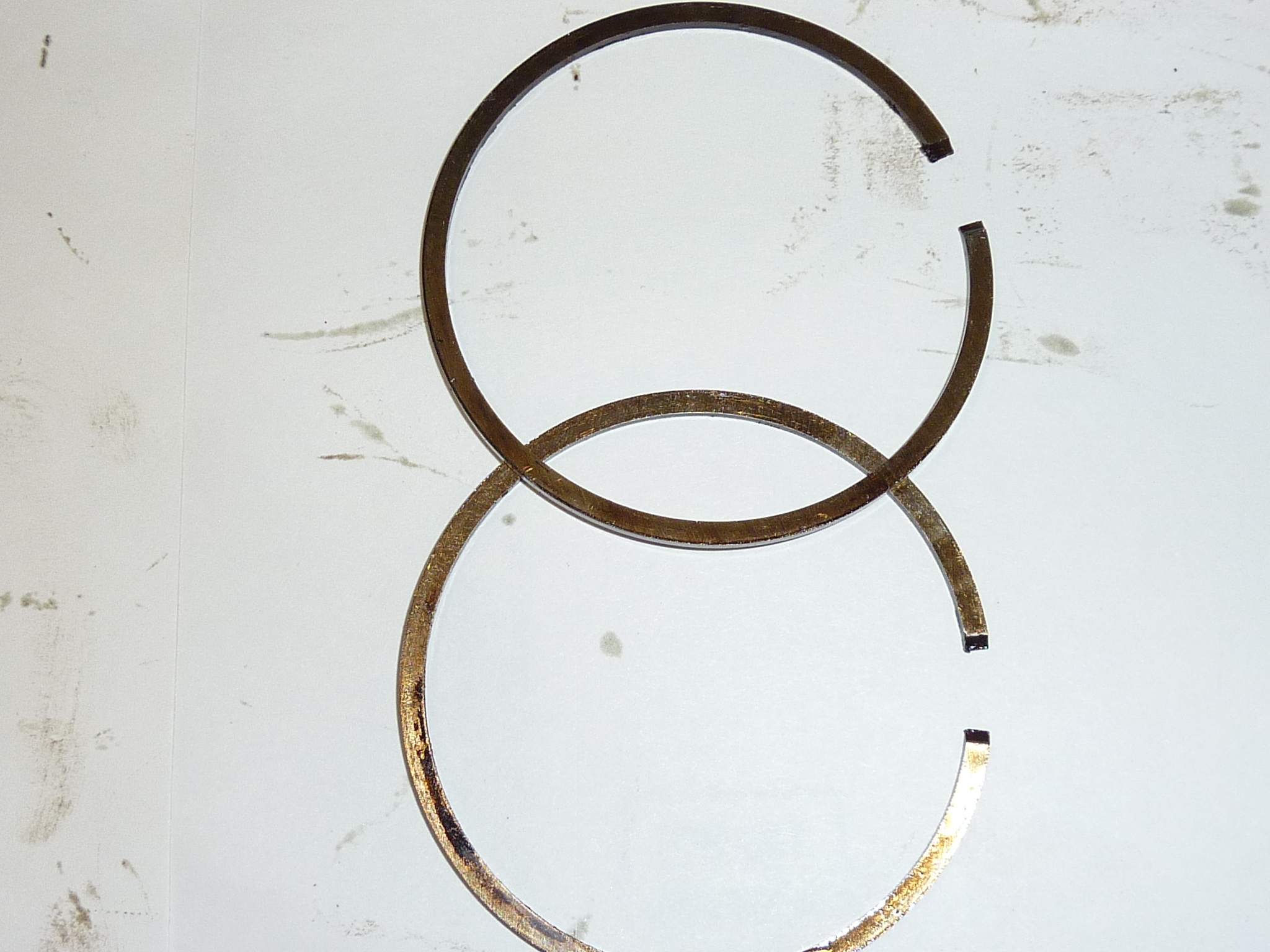

Ok here is the before.... Im still waiting on the rings...they should be here Tuesday... I went with the general consensus, and will do the antifreeze method.....just need to find a pot pourri pot now
i will post the after as soon as im done

Personally, I'd just check the ring end gaps, clean the ring grooves, put it back together, and run it 32-1 for a few gallons of gas. If the end gaps are good the rest of the piston and cylinder stuff will wash clean over some running time.
Did the previous owner use a tuned pipe on that ngine?

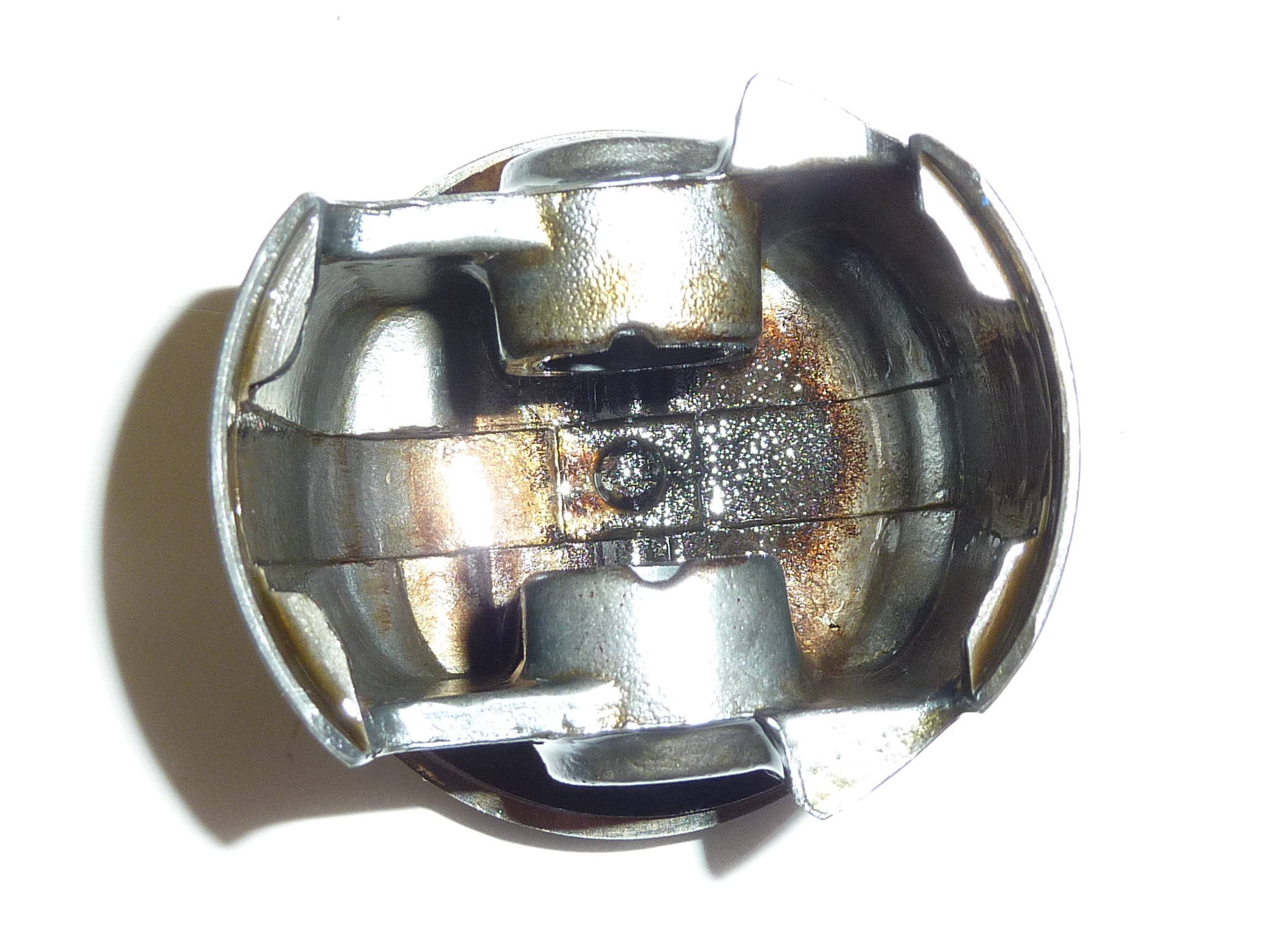

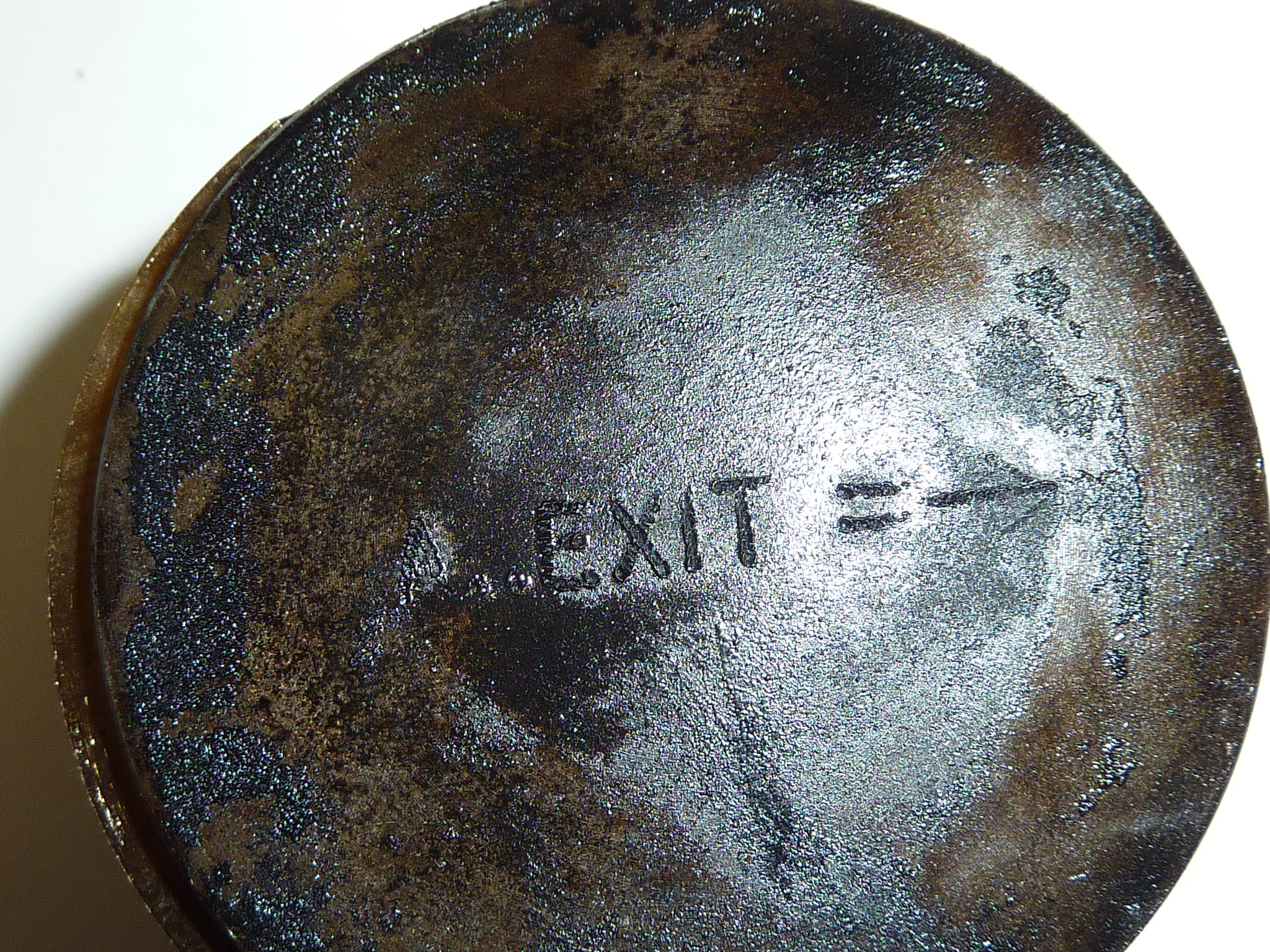

Old 06-02-2010 | 10:13 PM
  #46
MetallicaJunkie's Avatar
Joined: Sep 2006
Posts: 5,464
From: Donna, TX
Default RE: This is Bad Right?
ORIGINAL: Jezmo
ORIGINAL: jedijody
I've got the good old stuff,.........The stuff has ruined more than a couple parts in the past, it will remove anodizing and all the hair from your nostrils.
WOW, now I know why I don't any more hair in my nostrils.
sure beast pulling them out

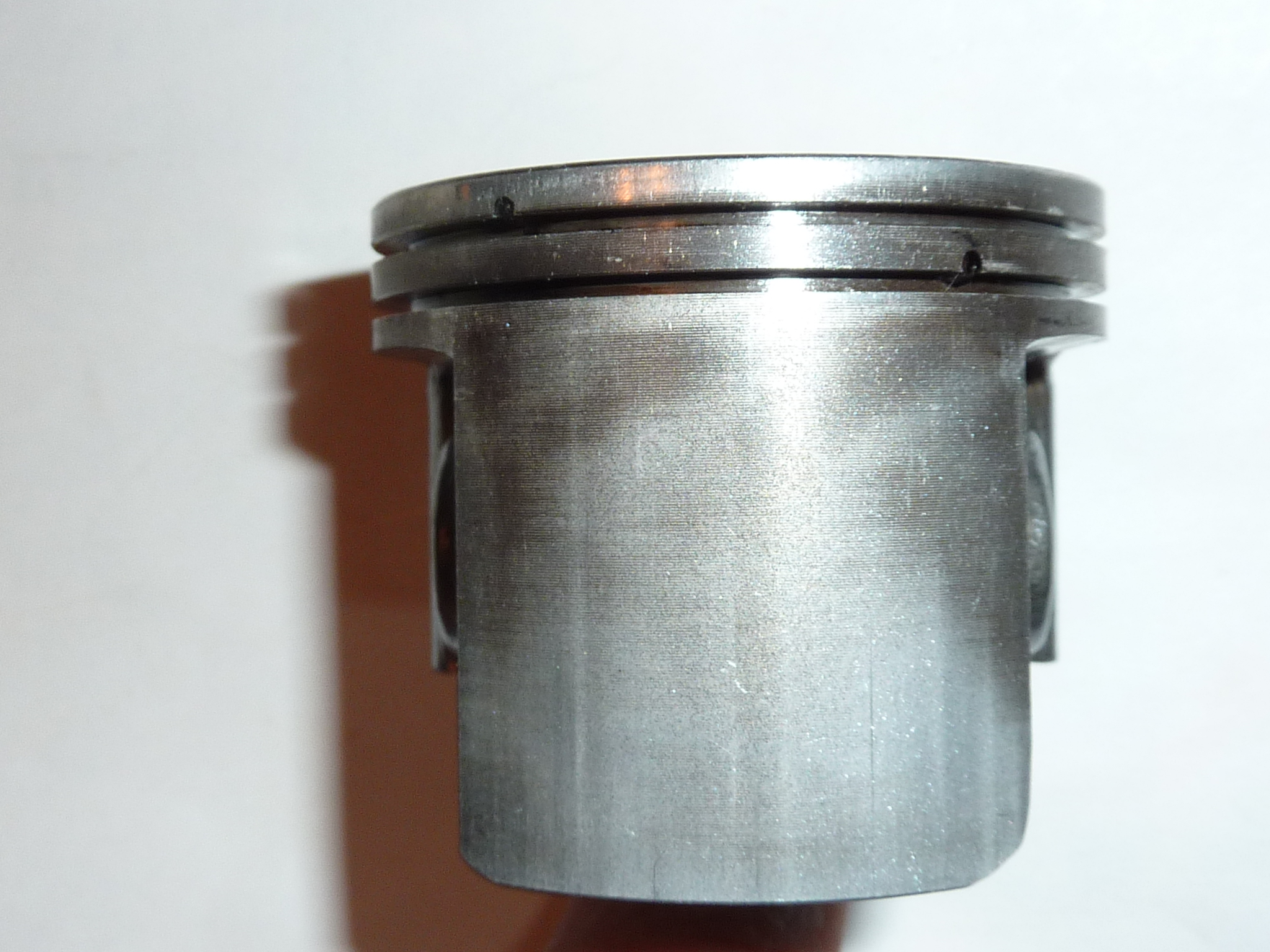

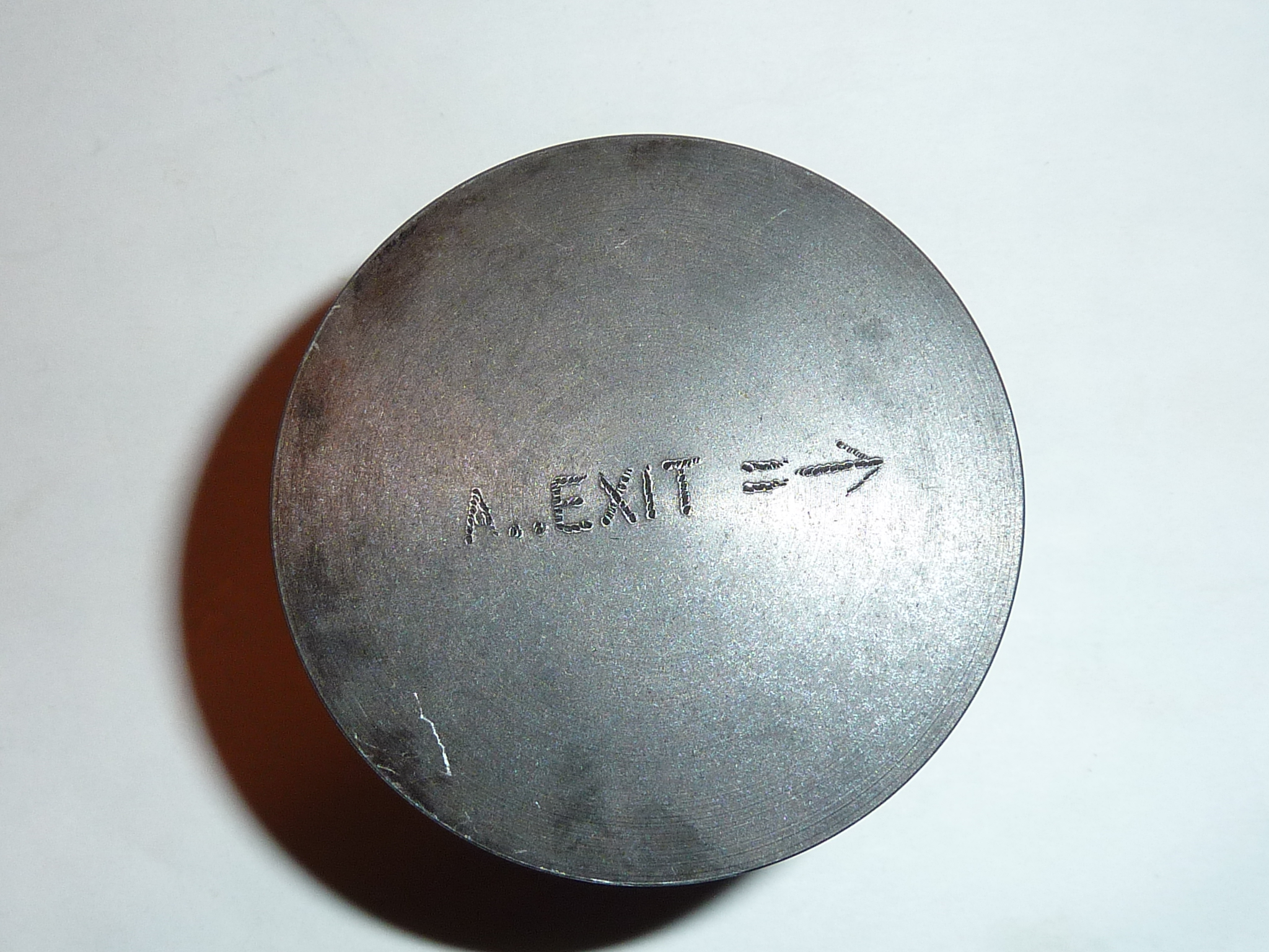

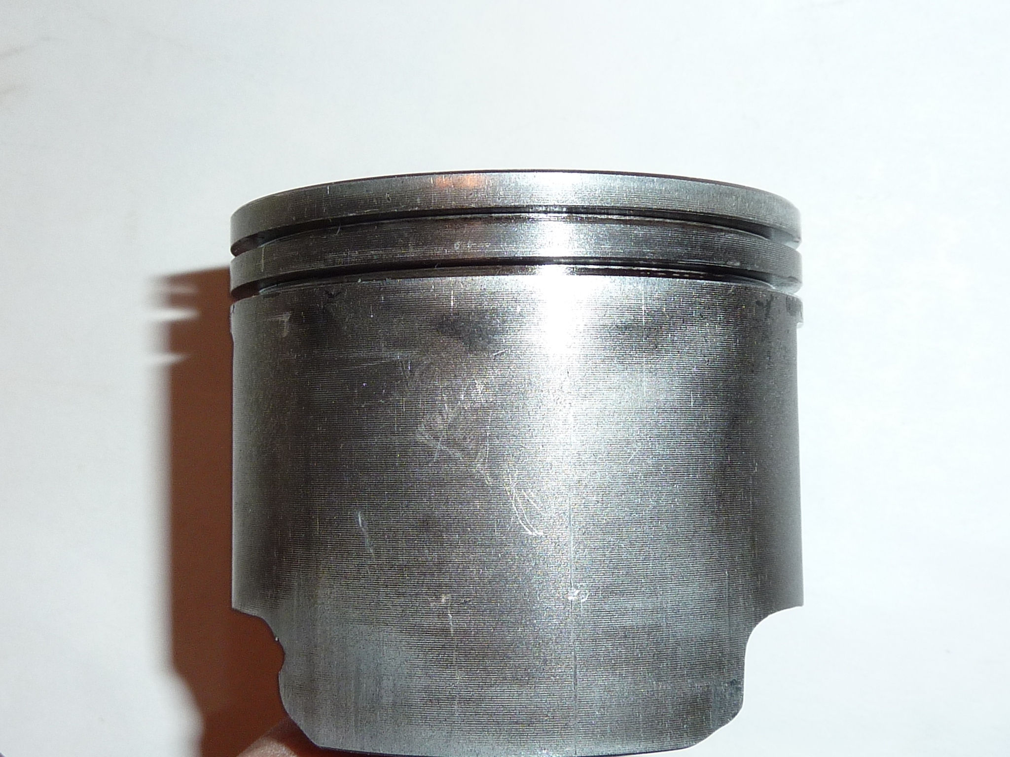

Here are the pics of my piston... it soaked in a potpourri pot overnight, with antifreeze, it did an ok job but not what i wanted.... it turns out i have the "new and improved" safer formula of antifreeze(orange color) that could be why.....so for peace of mind i so i went to the hardware store and purchased a gallon of mineral spirits and soaked my piston and cylinder head overnight....it seamed to get the rest of the carbon off.... i will fire up my motor tomorrow morning, and post rpm numbers after a few tanks, hopefully by this saturday if the weather is nice
ID:	1447327   Click image for larger version
ID:	1447328   Click image for larger version
Old 06-02-2010 | 11:06 PM
  #47
av8tor1977's Avatar
Joined: May 2003
Posts: 7,245
Received 6 Likes on 5 Posts
From: Tucson, AZ
Sure looks more than "decent" to me...
AV8TOR
Old 06-03-2010 | 01:13 AM
  #48
jedijody's Avatar
Joined: Mar 2005
Posts: 2,812
Looks perfect, re-ring and fly.
