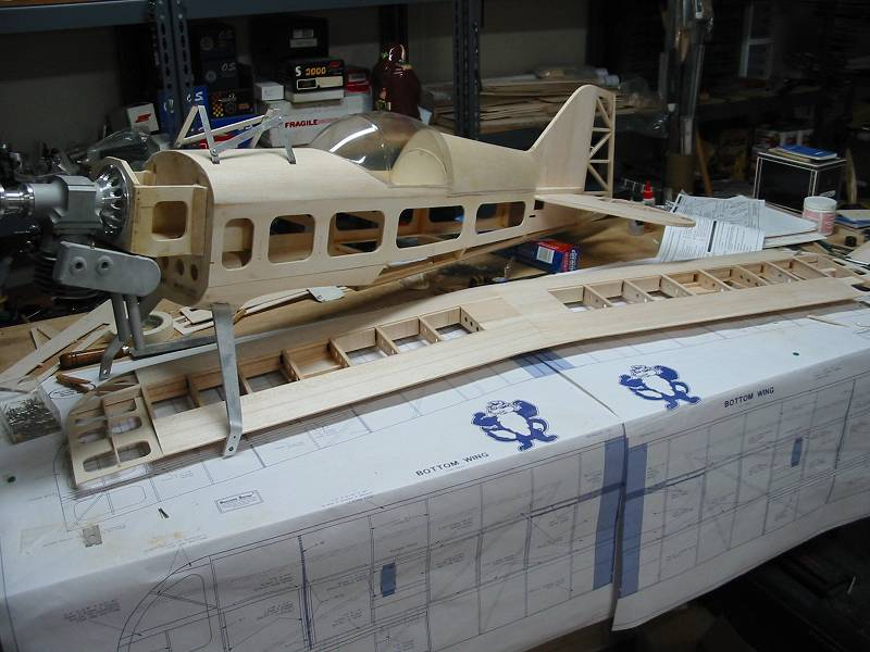

Here is a pic of my framed-up Super Stinker bipe with a Taurus TS42 mounted. The engine box needed a little trimming to clear the large-volume pitts muffler.

I can't wait to get her in the air. This is what she looks like now.

The G45 is fairly heavy at approx. 4.9lbs. The Taurus is 3.3lbs (without ign.). I'm shooting for an AUW around 14lbs.
Here is my airframe weight est. so far
Wings 2 @ 12oz = 24oz
Fuse with with tail and TS42 = 114oz
Fiberglass parts= 10.5oz
pilot = 2oz
tires = 5oz
servo 1.5x8 = 12oz
rec = 1.25oz
batt x2 = 7oz
fuel tank = 1.5oz
ign = 4oz
est. total bare airframe ready to cover = 181.25 oz = 11.33lbs (add 2 switches, extensions, fuel lines, control rods, horns, prop, spinner, and covering)

Texan, are you going to lighten the plywood fuse with a Dremel? Looks like alot of excess meat there. You might save a few ounces.
Old 02-18-2006 | 11:40 PM
Texan's Avatar
My Feedback: (10)
Posts: 568
From: Georgetown, TX
Default RE: MID. Super Stinker GAS ENGINE HELP
ORIGINAL: mrbigg
Mrbigg,
I don't want to hijack the thread. My point is that the AUW should come out about right with the Taurus TS42. The plans show a weight range of 12.5 - 16lbs. The wing area is 1240sq in so the loading range is 23.2oz to 29.7oz. At my 14lb AUW target, loading is 26oz. I may take a little meat off the ply if it doesn't compromise stiffness. I want my snaps to snap... not SNAP! I expect the static thrust to be around 25lbs (estimated by my experience with a ZDZ40). I have not run the Taurus yet. So, if someone has direct experience with static thrust output of a TS42 I would be interested.
