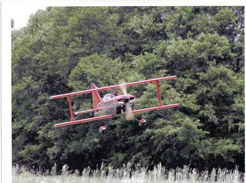

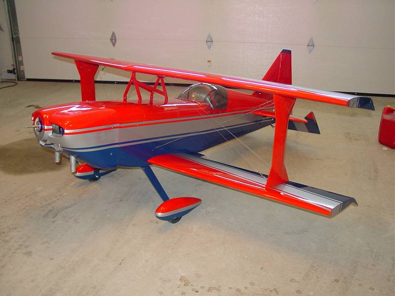

Well guys, Here's mine. BME 100. Did everything I could do to lighten it up except carbon tubes and still came out 29lbs. If I like the plane I will get some C/F tube and that will save around 8 or 9 ozs. My old 100 will need all the help it can get.
However my ignition had a coil go bad and I only got 1 four minute flight out of it. not enough to judge the plane yet. Hopefully I will have the ignition back in a few weeks.
Later

Thunderbolt47,
Your plane looks AWSOME!!!
Do you think your engine will be powerful enough? I have a BME 102, and I am concerned my engine wont be enough for good vertical performance, what do you think?
I am planning on using Fromeco batteries and regulators to get my weight down, and maybe a carbon gear and wing tubes.
BR, Mark

Mark, I really don't know. My Sukhoi was 26lbs and the pull out was pretty good, nothing like a DA in the same plane. Now where talking 3 more pounds,two wings and flying wires.(lots of drag)
What little bit I did fly, It seemed to have the power. It went staight up after rotation. 3 to 4 minutes in to the flight my engine started sputtering and I had to land.
will it pull out of a hover is yet to be seen. As soon as I get my ignition back, I'll find out.
I've seen the H-9 Ultimates at 42 to 44lbs pull out (slowly) with a DA150. much slower than a 42 lb mono plane, but they all looked like they had good control at ther slower speeds. If my BME will (slowly) pull my Ultimate out of a hover, I can live with that. Just have to be a little more careful not to get in trouble.
BTW my 100 will turn a NX 26x10 6100 to 6300 rpms on the ground. A DA will turn a 27 to 28 inch prop. My 100 would never swing them.

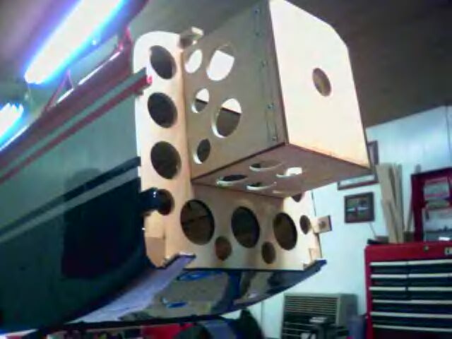

Mark here is my mods to the firewall. Sorry it's a camera phone pic that's all I have right now. Tomorrow I will get a pic of the top side and the hatch area for you.

One more thing. I had 10mm plugs put in my engine so I wouldn't have to cut plug holes in my cowl. Unfortionatly I got a bad coil back with it. At least I can run a li-ion with out a reg now.

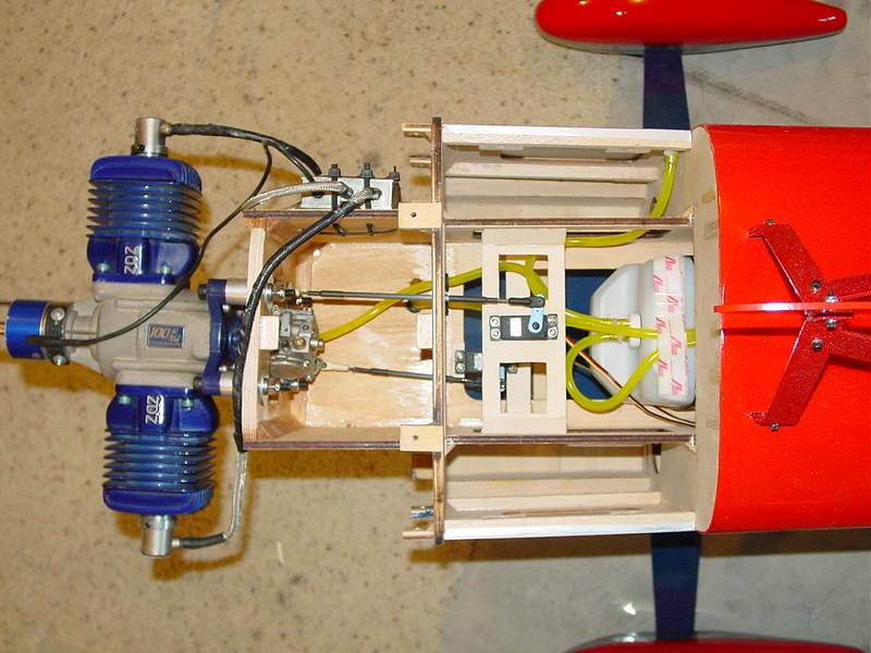

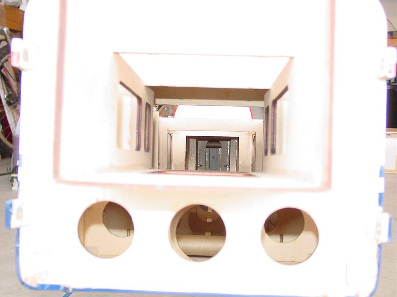

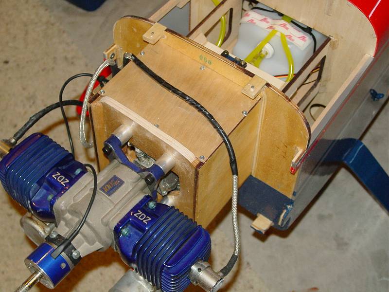

Hi Guys,
Got some more work done on this thing over the weekend. I was able to get the motor mounted. Decided to go full tilt with the rear carb box install. Had to put 3/4" standoffs on the ZDZ for good cowl alignment. Batteries and rudder servos are placed back some for proper CG. All my parts were here in just a few days with the exception of TBM. Kind of surprised by that because their usually pretty good. Tracking puts it here on Thursday. I still have the rigging left to do and the pull-pull. All of the servo arms for the rudder and wings are in the order that has not shown up yet.
One question for you guys, are you all measuring your CG with the wings off? Anyway back to work.

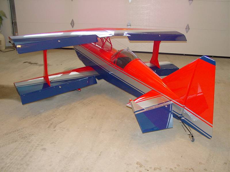

A couple more pictures. I've pretty much got it done less the parts that have not arrived. I am guessing about three more hours of work left to do. I ended up moving the batteries two formers up from where they were. CG seems pretty good but I am a little unsure. Any help with CG would be appreciated. She should be flying by the end of the week.

DAM, look at those ailerons reaching almost all the way to the root. Also the tail feathers are huge. Should 3D very well. It's cool that these birds will be in the hands of some sick 3D'rs. The flight reports and vid's should be very good.
