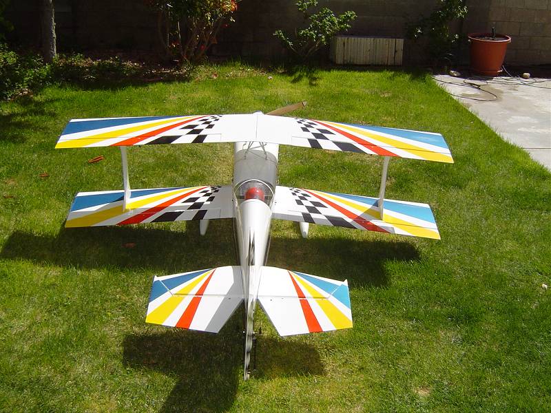

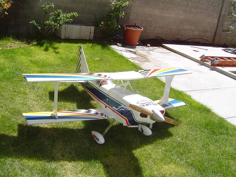

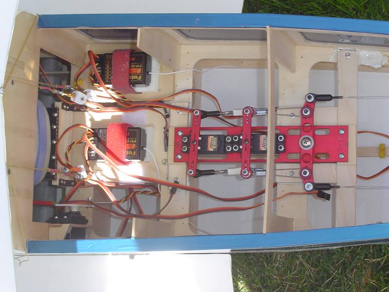

Mine took me about 1 year to raise the money for the servos and motor but its ready finally. BME 110, 2 Futaba 8 channel PCM receivers, 8 Hitec 5955 Titanium Geared servos at 333 oz of torque each. SWB self adjusting rudder tray with 2 of the 5955TGs for 666 oz torqur for rudder, carbon fiber wing tubes and stab tubes. 29.5lbs. I'm hoping tp test fly in the morning or on Monday.
ID:	445838   Click image for larger version
ID:	445839   Click image for larger version
ID:	445840   Click image for larger version

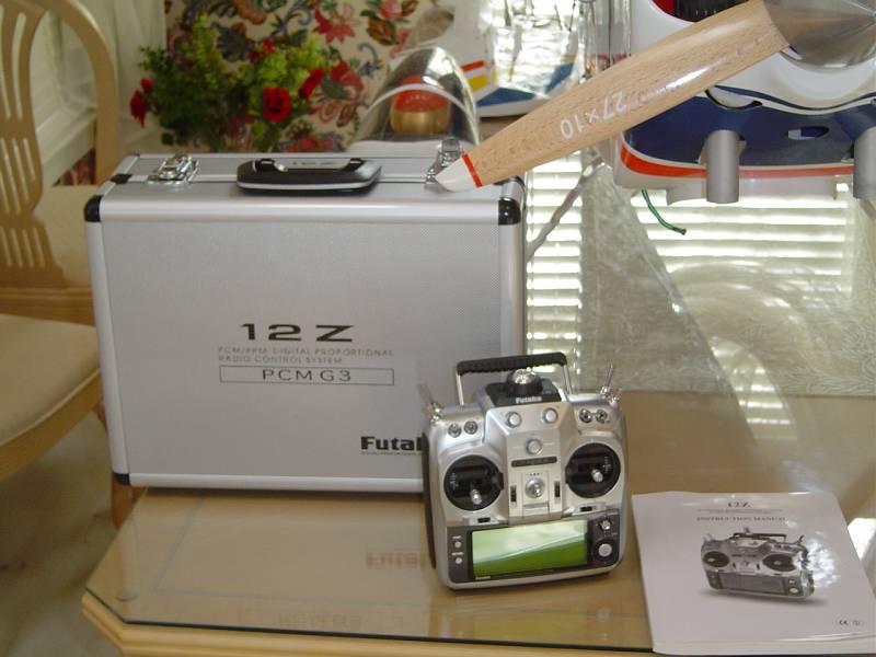

Oh I forgot to mention it will be controled by the new Futaba 12Z. My local hobby store owner Stan called me up and said he had something I should see...$1400 later I'm a owner
