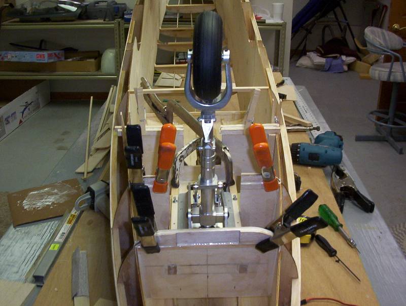

Nose gear unit installed with a JR 8411 servo for steering. Aeropoxy used throughout for this step.

I just received my main gear from Darrell at Sierra Precision. BEAUTIFUL !!!!!!!
I have decided to convert to the 425 at the coaxing of everyone, thus the trailing link (a bonus) gear. I will build the horizontal stab with the V dihederal and modify the nose cone .
Here are some pics of the main gear and the bottom of the nose showing the initial gear door design. I am activating the doors with servos...instead of air cylinders.

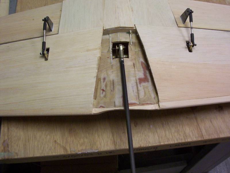

Rudder assembly underway. I used 7/64" piano wire inside large nyrod...laminated between the balsa sheet leading edge..... for the hinge. The rudder is removable by simply pulling the wire out.
The stand-off posts aeropoxied to the vertical fin are cut from C/F and have a brass tubing epoxied inside the hinge point. This does take some time to set up, but worth it in the long run.

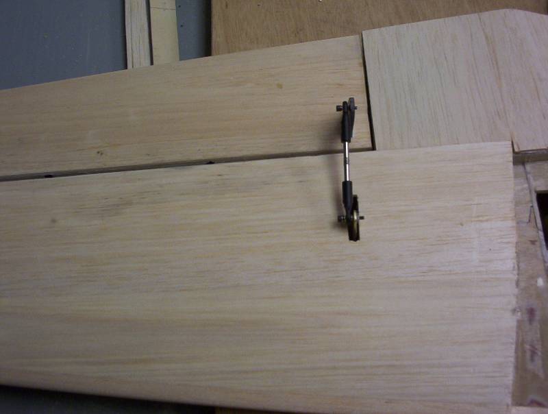

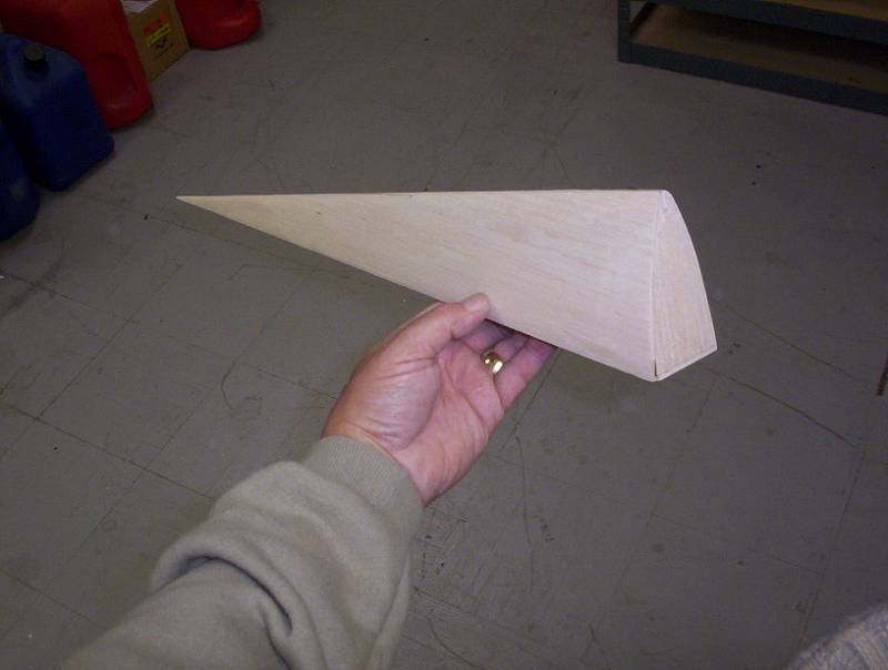

Horizontal stabilizer and elevator framework next. I will have to build a center spar to provide the dihederal that the 425 has.

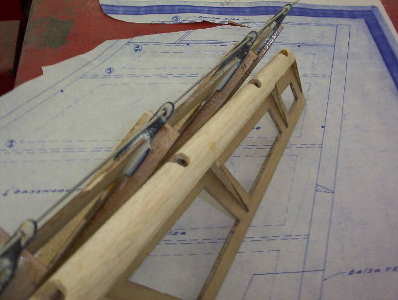

I laid up the spar last evening. It is made from 1/32 ply laminated with 1/8 balsa sheet using Gorilla glue. Stab has been cut and the spar aeropoxied into place.

Horizontal stab sheeted, and fitted, rear fillet roughed in. Rudder fitted and shimmed.
The elevators are next.....

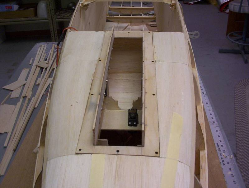

Windshield track assy underway, the first fitting of the glass.

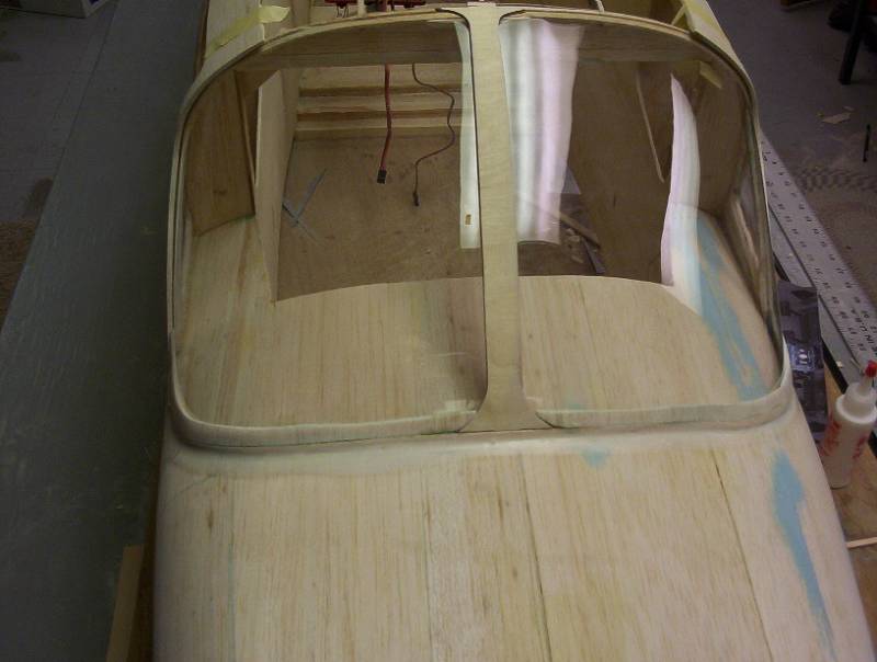

Windshield frame assembly now underway, using 1/32 ply laminated and formed around the curve of a wastebasket....
After much discussion with Roger at Wren.....I have decided to install the new Wren 44 turboprop motors...which will be available late this year. This will save on weight, fuel consumption and will simplify installation due to the newer case design.

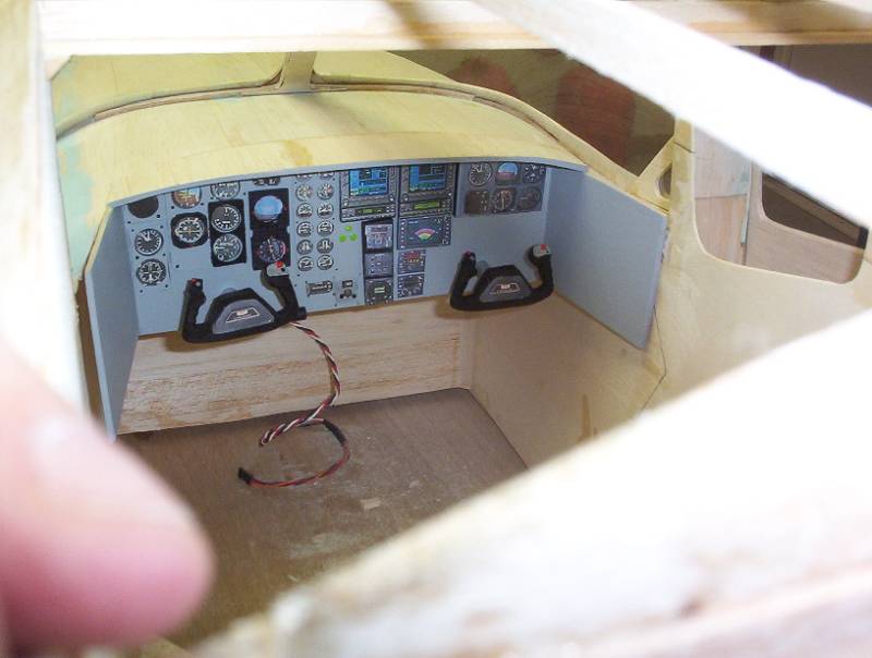

Windshield frame now ready for finishing....instrument panel completed.....nose gear door assembly painted and assembled. I used aluminum tape to finish the inside of the doors.

dual garmin 530's....nice panel!!!!!!
