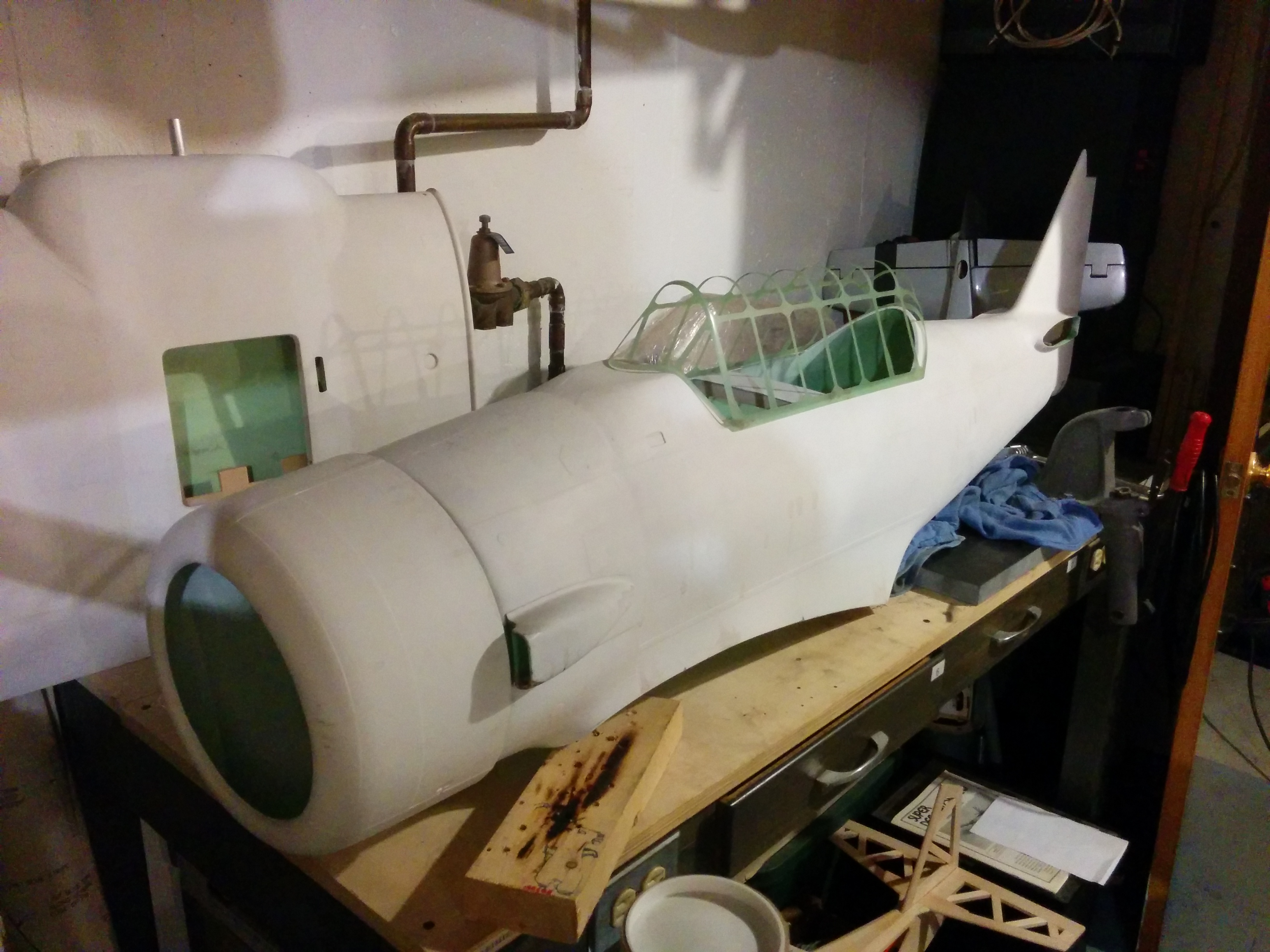

Hi Everyone,
Tom,
I am glad you created this thread very helpful. I am looking into purchasing a 7-77 for an AT-6 Texan, its a used engine that has not been completely broken in. I have a couple questions; 1: You mention old vs new carb that deals with the richer setting at idle. I have the serial number to the engine I'm considering, is there a way to determine if this engine has the old or newer carb? 2, when breaking in the engine the original owner used 5% nitro & 9% oil during the process, do you think the nitro had an adverse effect on the engine?
Any help is much appreciated, Mark

Hi All,
Well I bought a 7-77 and I had a chance to run it today. I was amazed at how easily it started by hand. I am running a blend of Klotz 8% super technniplate and 92% methanol. The person that owned it before me ran 10% redline and 90% methanol, he had a total of an hour running with that mix. I have the Electrodynamics EDR 103 glow driver once the engine was primed it started on the second flip by hand. Here is a picture of the engine and what its going in. The plane is a Yellow Aircraft AT-6 Texan should be a good combination. I have only gotten through about 17 pages of this thread, I think I have the basic down on the maintenance, oiling after finished running for the day after it cools then checking it the next day. I try to run it every time I go to the field to finish the break-in. Must finish the AT-6! Does anyone know if the EDR glow driver uses the same method of igniting the glow plugs as the Sonic Tronics glow driver by pulsing voltage to the glow plugs.
