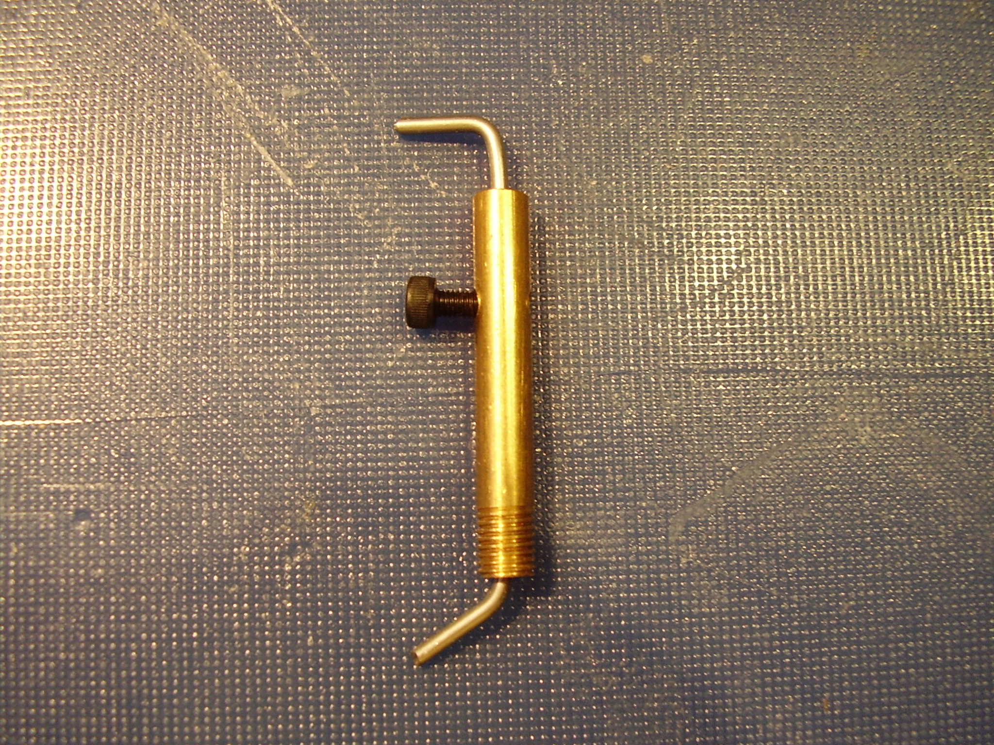

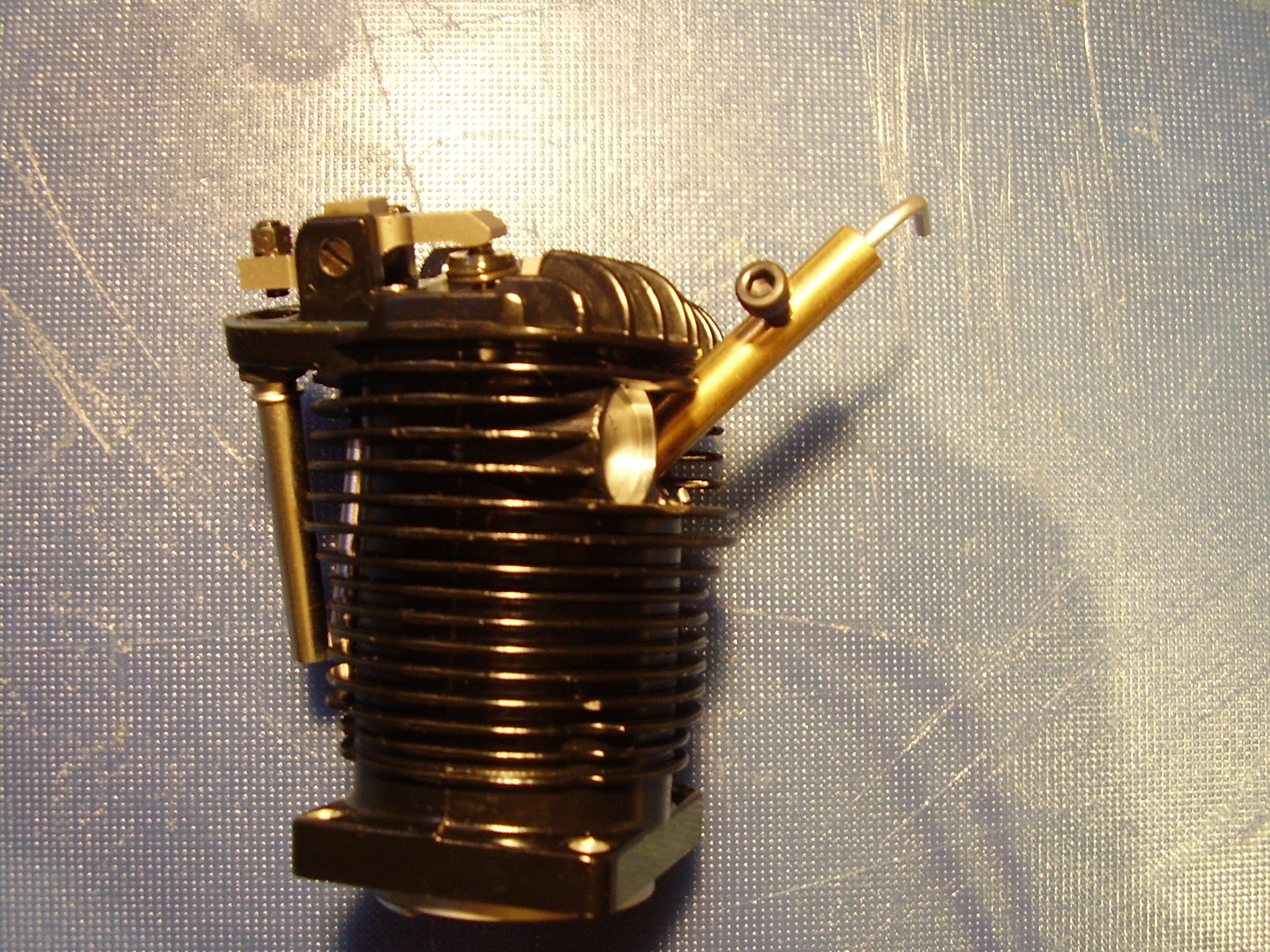

Hello
I discovered that I had different valve springs on my 7-35 (weak & hard)
I bought 14 new springs updated, for all is a bit harder.
Result, the engine runs better and more responsive throttle.
So you who have an early motor 7-35 chek if the springs are soft.
You will notice a difference
I bought my engine in December 2010
I have made a tool for changing the springs without taking the engine apart
Lars

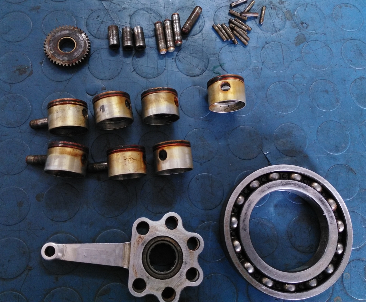

Before you run those engines guys....if you did not do it....I STRONGLY recommend that you take one push road from top and one from bottom OFF, unscrew the brass part with the push rod needle and pump some good grease in until you get it out to the other end.
They do not come greased almost at all, seen several failures on the cams on ready .
When you adjust the valves....make sure you go on the same cylinder 3 THREE times before you move to the next.
It has 3 sets of cams inside and I think they machined not quite the same.
If you adjust one and you see it is good and all OK then you have all the chances to find it to sloppy to the other cam set or to tight...you may need to find a happy medium.
Had several trough my hands and looks that all do the same thing.

The timing chest is not isolated from the crankcase. Any oil or grease injected will mix with the fuel. When the fuel methanol to oil ratio is high enough the drained oil from the timing chest after flying for the day should run out crystal clear and not black. This is why I run 9% oil and 7.5% nitro to offset the extra oil. My engines are over 150 flights with no problems. The air tool oil that was added will come right out the exhaust at the beginning of the flying session like a two stroke glow until it is burned off. This demonstrates any added oil or grease will affect the fuel.
