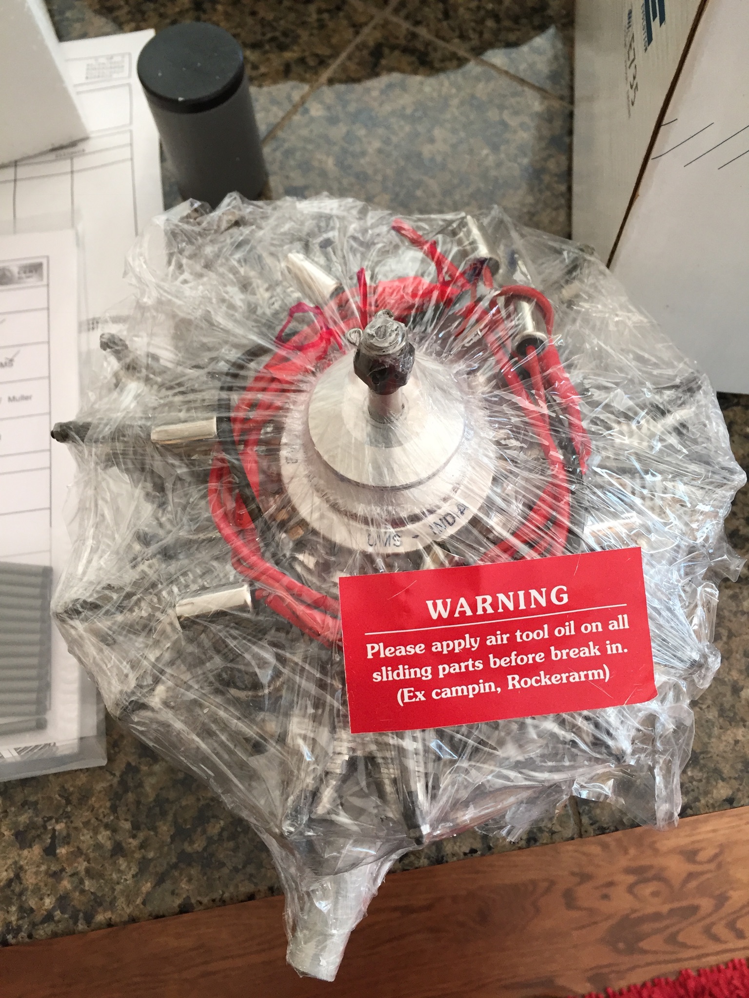

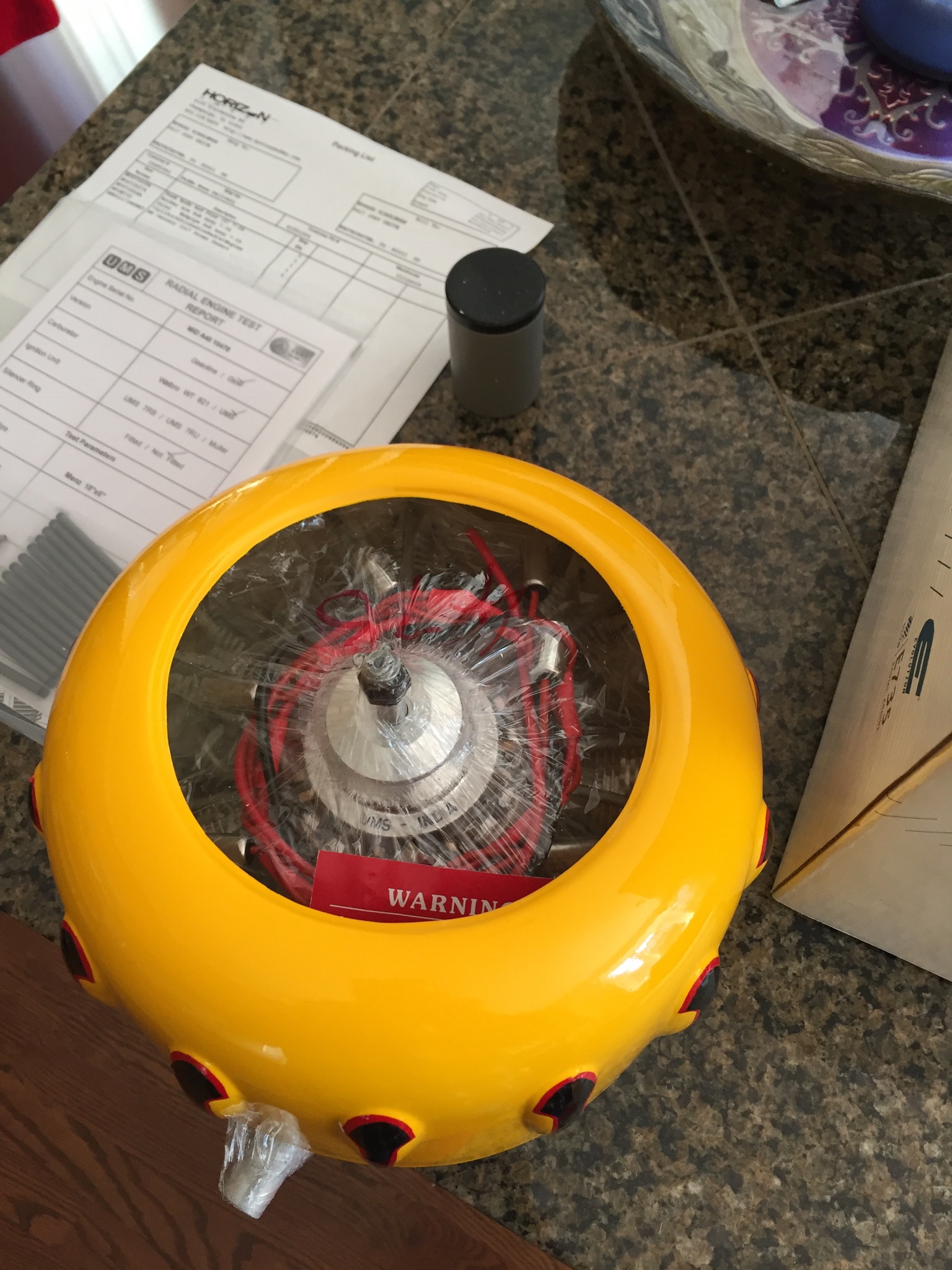

Guys, just received my engine from Horizon. It came with the silencer ring already installed. That saved me $130. It fits my cowling with room to spare but think I'll leave it off so it's easier to work on and it looks great on the Waco. I'm a little concerned after reading Tom's comments that this 7-35 engine is kind of fragile if run lean. I'm wondering if I should wait to run it after the Saito carb swap? Adrian from CH ignitions is going make up an adapter for the carb, what a great guy! Let me know what you guys think about breaking in with the stock carb. Thanks Lars for the carb part number and advice.
Ed

Old 01-27-2017 | 04:18 PM
  #2140
My Feedback: (62)
Joined: Jul 2005
Posts: 1,190
Received 16 Likes on 16 Posts
From: Indianapolis, IN
Ed, you can try to run it. At full throttle if you cannot richen it then stop and get the Saito carb.
