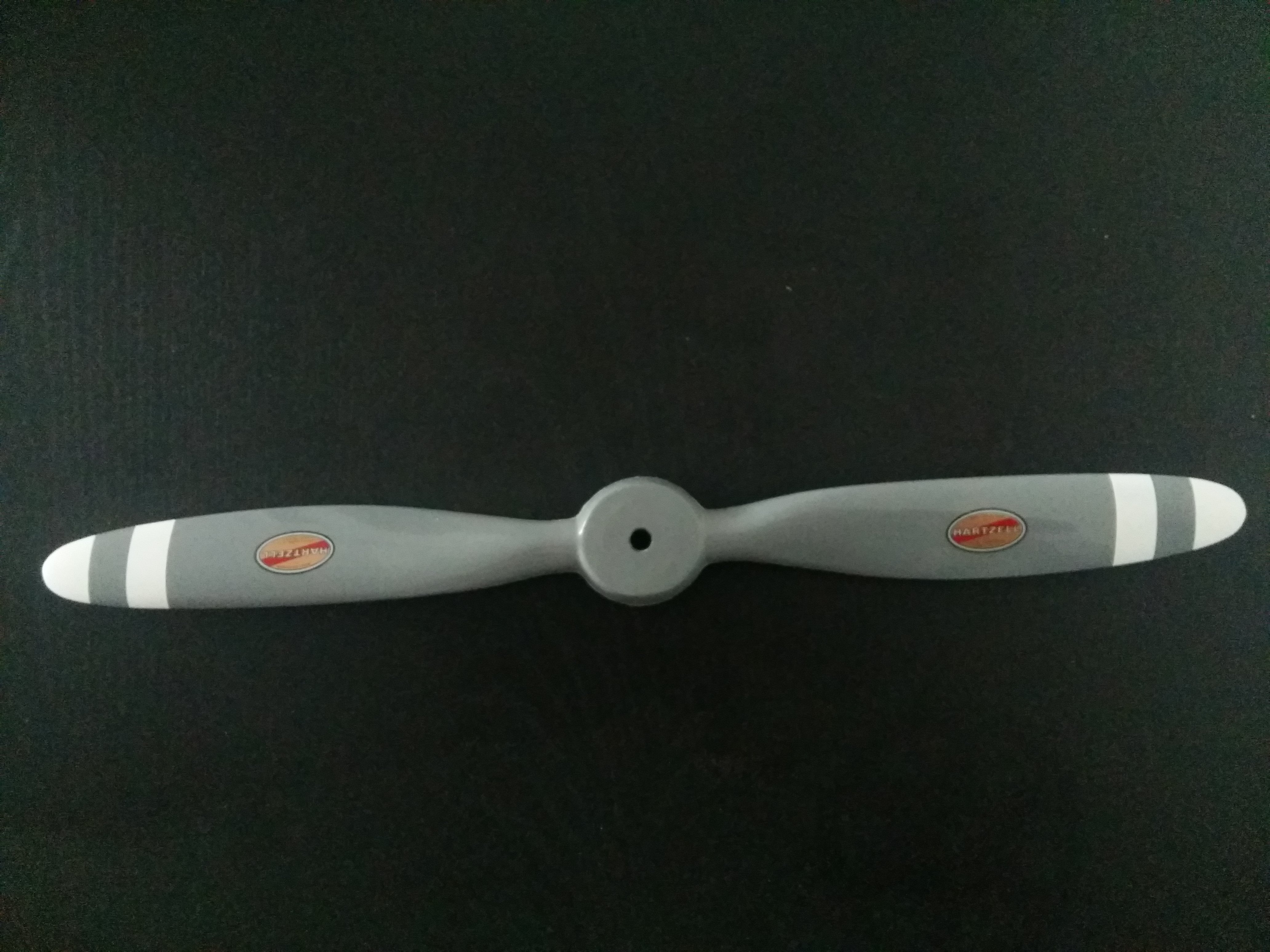

Default biela 18x8 scale propeller rpm
Hello I plan using a biela 18x8 semiscale (picture) do you think the evolution 7-35 stock with methanol will handle it? will it get to the 6000 rpm?

A propeller 18x8 then you should probably have more rpm.
I have flown with a 18x8 Graupner with 7000 rpm.
6000 will probably be a little weak.
now I have an APS 17x10 giving 6400 rpm.
It is after I have switched to a carburetor from Saito 120r3

how many rpm are good for keeping this engine happy? between 6000 and 7000? I feel the engine has not a lot of thrust and my experience is that biela props load more engines than other propellers.

Fulcrum, the 17x10 as Lars said is very good for many applications. Your prop is in the range so try it!

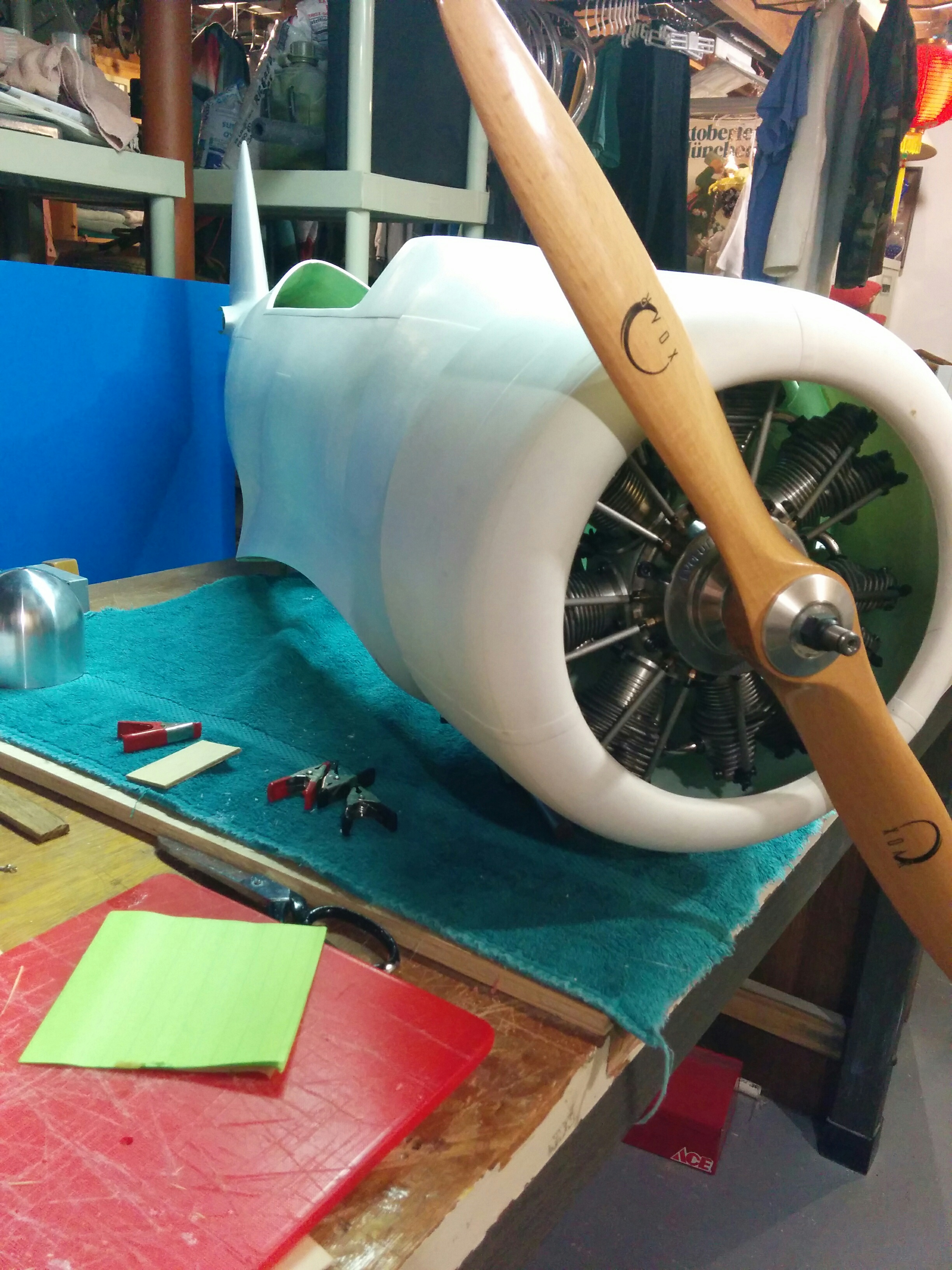

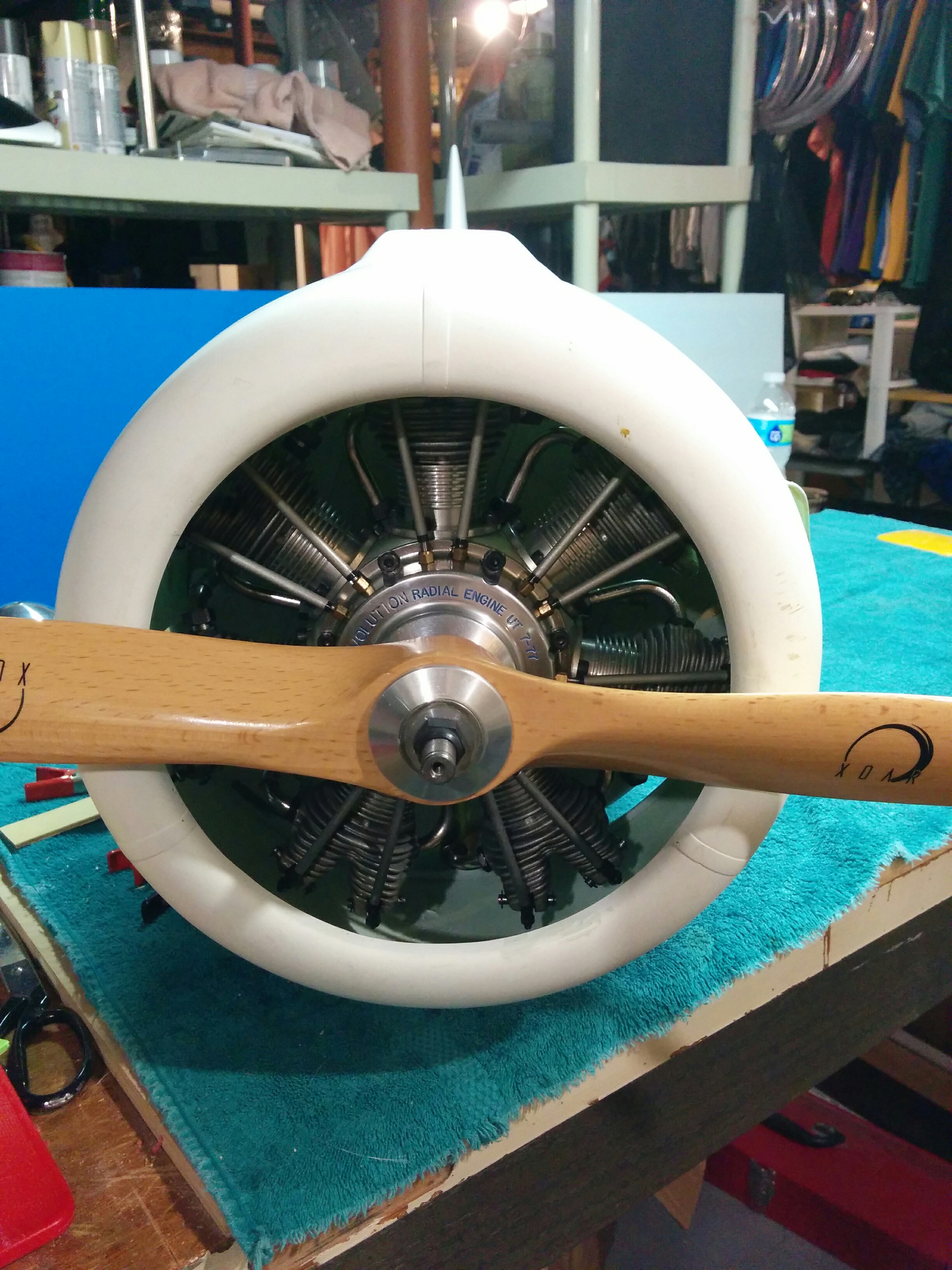

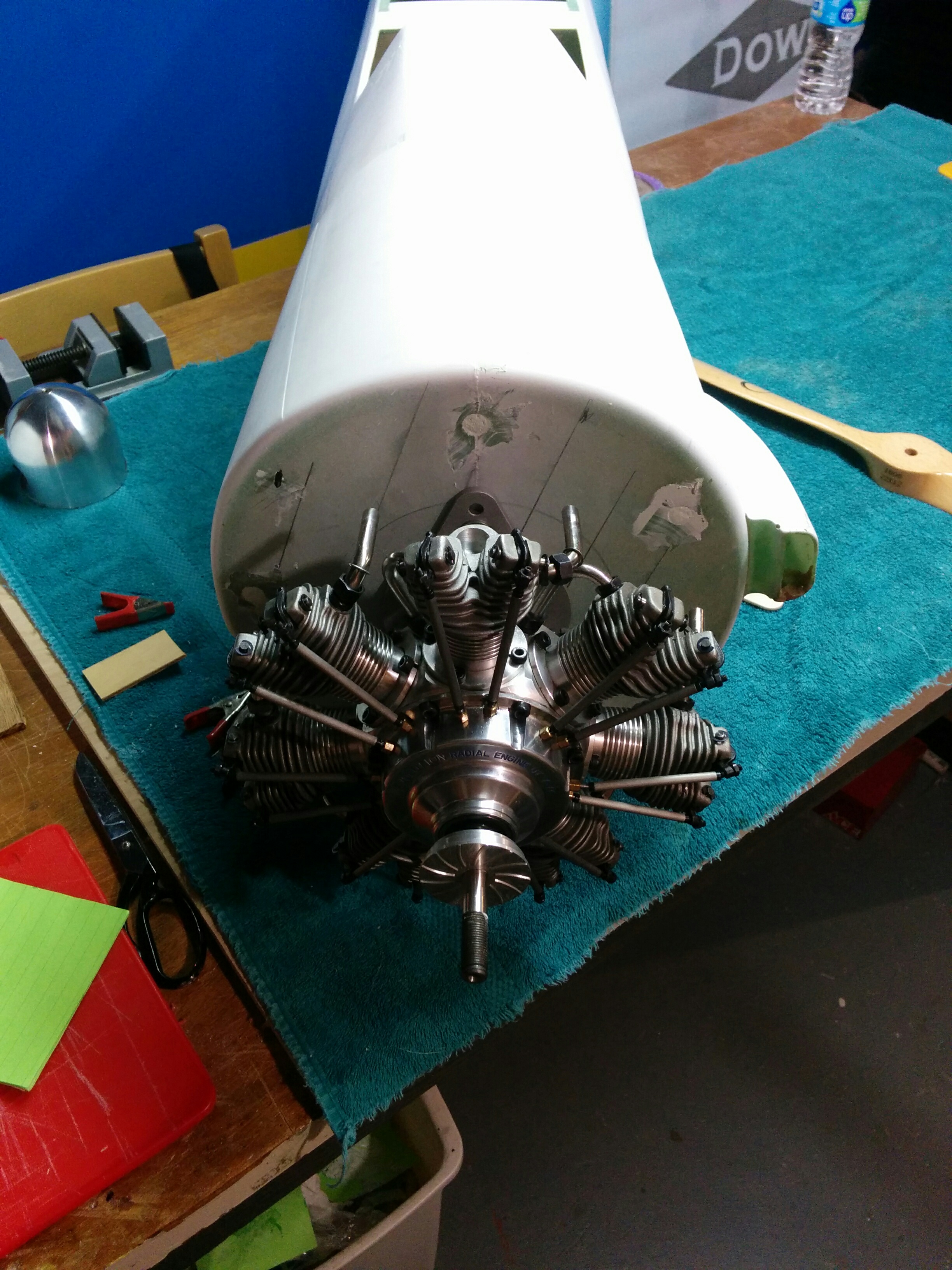

Hi All,
I am building a Yellow AT-6 and putting the 7-77 in it. I have concerns about cooling, the cowl has a big opening but the exit is very narrow about 1/2" around the cowl. I have these pics I will have to get a picture of he cowl on with ou the engine so you can see the engine compartment exhaust. Comments???

Block off the gaps in between the cylinders, leave about 1/16 around the pistons. Your exit for the warm air should be 3x the entry for the cooling air.

When blocking the gaps between the cylinders, be sure not to block off the exhaust pipes. Insufficient cooling of those will lead to burnt exhaust valves.

cymas & tih,
Thanks for the information, you sound like you have done this. As I am new to radials can anyone give an example with pictures of exactly what this might look like.

Gooooogle says....
http://www.modelairplanenews.com/blo...etailing-tips/

Don't you just love the internet. There is all kinds of info on making baffles. Sometime when your brain is hurting from thinking on a subject, ideas as simple as a general search of the internet never rise to the top. :-)
