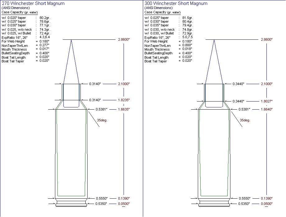

I'm sure it's not an original idea but I've made no successful searches for info. I want to make a muffler for an OS FS .70 out of a rifle shell casing. I know the id needs to be just under 11mm or maybe even 11 before the threads are cut. Anyone know a common casing to suggest?

Here is a CASE DRAWING for the '06. It looks like you could get threads way up into the case wall W/O getting too thin.
if you want a smaller exit diameter go W/ .280, .270 or 25-06.

One of the various WSM CASES might be the ticket. They are .5550" @ the base.

While a .375 H&H based belted magnum case has a head diameter of .532", the actual case base ahead if the belt is only .514". The 375 RCM is a full .532, the RUM & WSM cases are .551" & .555" respectively.
The short WSM case would be the easiest to come by, the longer RUM are a bit rarer. Your 12ga brass case is interesting as it would have an OD of about .800". Where would you find a single 12 ga brass hull?

I got my hands on a 300 WSM. Still too small compared to the factory muffler. I might as well just have an extension on the header for the same effect as far as function. My next idea is a CO2 cartridge.
