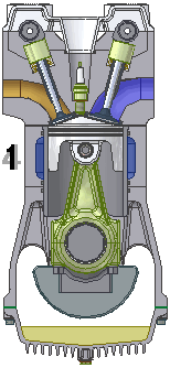

There are two different top dead centers of the piston as far as the valves go because the cam only run half the speed of the crankshaft. You want the one that is the compression stroke.

well, i adjusted the needles per the book and wah wah wah...waawaaaaaaa....
nada, zip, zero zilch no dice i found a neat GIF to help everyone with the compression stroke deal.
any other ideas? they would greatly be appreciated..
ive heard of taking the engine apart and simmering it in a crockpot full of anti-freeze and that will clean it in and throughout. so any ideas short of rebuilding this bad boy or what to check for is appreciated.
