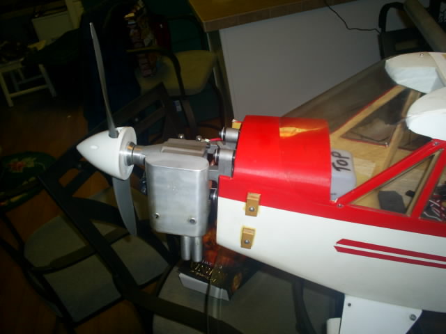

st 2300 with glow driver and bisson
Old 03-26-2006 | 08:31 AM
  #346
LANNYBOB's Avatar
Joined: Jul 2003
Posts: 899
From: d.f.s., FL
Default RE: My 2300 only likes one prop
st2300 with glow driver and bisson hell yea
