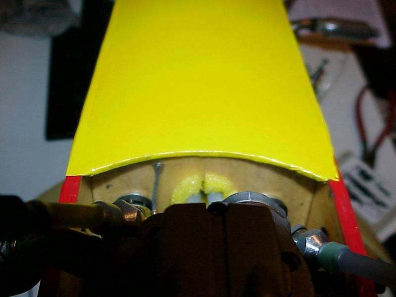

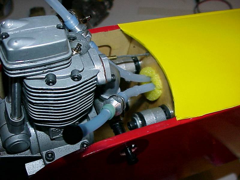

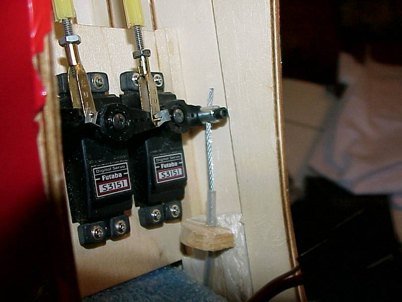

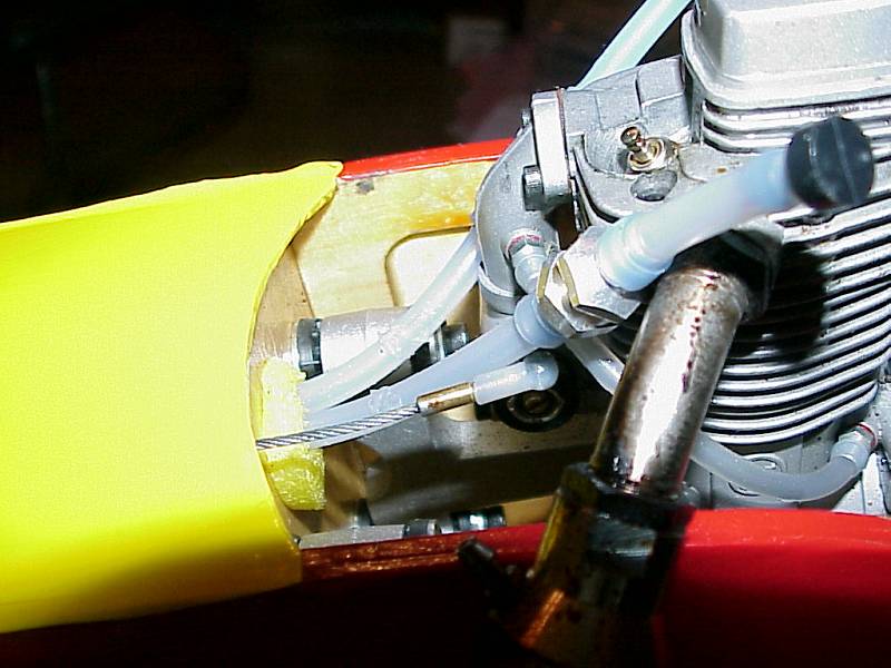

Joel, I have the Magnum 91RFS in my 4*60. From the photos I've seen of the Hobbystar 60, the engine compartment is near identical. My engine has the high speed needle opsite to the exhaust. I use a ball link and a cable for linkage. Using the flexable cable, you can route the linkage around the fuel tank. I battled hard linkage on a couple models before settling on the cable setup. Just keep the amount of cable out of the housing to a minimum and it works really well.
Don

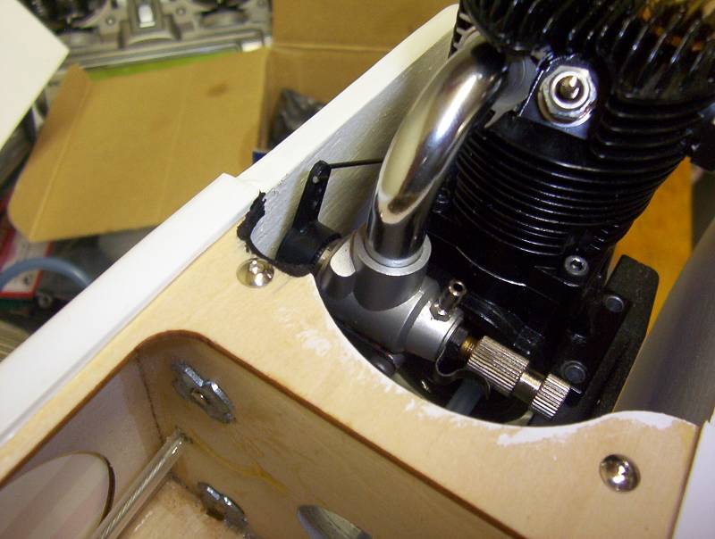

Here is how I do it.
ID:	798942   Click image for larger version

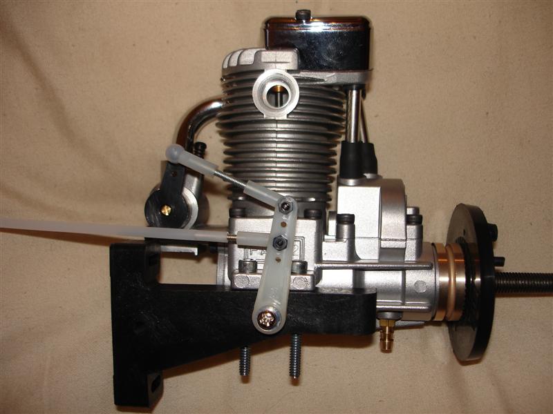

I used the Dubro 4 Stroke Linkage and some ball joints (See Pic)

I use the same system as Custom PC no slop I rotated the Carb 180 degrees, that puts the the needle on the other side (of course the linkage flips to the other side too)
martin
I used the ball joint thing and made the lever from an extra servo arm with one end cut off had what I needed in the extra parts stuff
