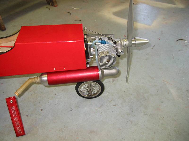

Old 02-25-2009 | 06:50 PM
Hobbsy's Avatar
My Feedback: (102)
Posts: 20,370
Received 30 Likes on 28 Posts
From: Colonial Beach, VA
Default RE: Throttle setup help
Here is a similar set up on an RCM with a Saito .62. Me, "Big Dave" on the left, "Little Dave" in the center and Grandson Jerin on the right.

I really like that idea to remount the throttle servo. I can put the servo on the left and run a rod straight to the carb. Thanks Hobbsy. To me, thats thinking out of the box.

ORIGINAL: Hobbsy
That's a nice setup, but all you really have to do is run the pushrod out of the stock nyrod location out past the cylinder and then bend a 180 in the pushrod and go back to the throttle arm.
The first time I heard of that I laughed, but then I tried it. I eliminated the bellcrank and it worked perfectly every time. Boy, was I red faced. Fortunately, I was alone at the time.
Ed Cregger
