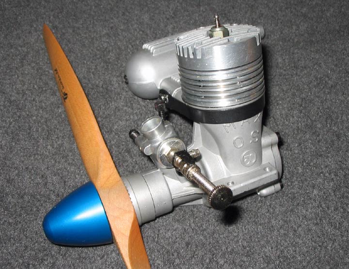

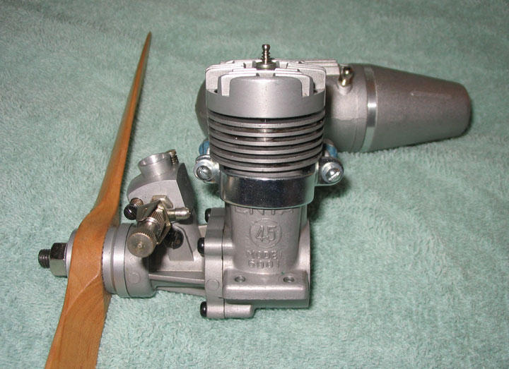

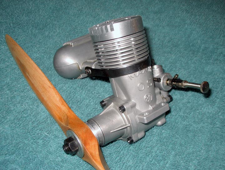

Here're a few engines with two rings.
David
