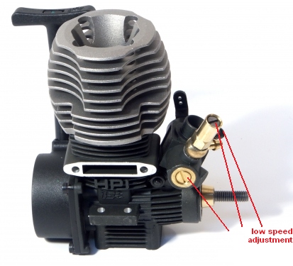

rightyho, so the needle valve limits how much fuel it gets? what about the screw i can adjust where the fuel pipe connects? i thought that would let me modify more air/more fuel but if the needle valve does that.. damn its so simple with electronics lol
Joined: Dec 2009
Posts: 15
From: Leeds, UNITED KINGDOM
Ah ok, what's the other one then? on the side of the carb, if i take the air filter off i can see it and if i adjust it it moves in and out towards a point in the middle

ORIGINAL: Arkz
That sounds like you are describing the low speed mixture needle. If there is a screw slot in in a recessed area in the center of the carb's throttle arm, then it's prob. the low speed adj. screw/needle.
That adjustment, if too rich, will contribute to the difficulties you describe.
Can you post a picture?
Edit: Yeah...it's hard to tell just exactly which screw you might be talking about? One might be the idle speed stop screw...the other, if it's in the center of the carbs throttle arm (where the servo's pushrod attaches ) then it's the low speed mixture.
Joined: Dec 2009
Posts: 15
i didnt mean that, the idle one is a little black screw next to the throttle with a spring on it in the case of this carb, when i adjust it it limits how low the throttle goes, but theres another bigger screw that has a needle on the end when i look down the air hole... could this be a high speed needle?
