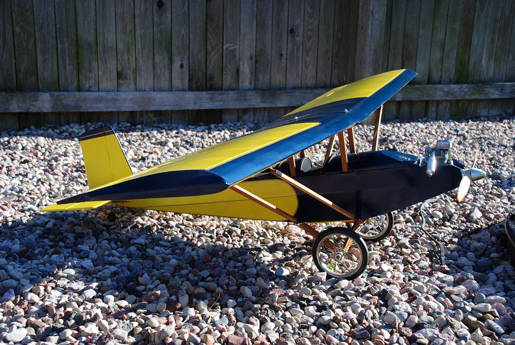

Default RE: New Four Stroke With Engine Knock
<font size="4">Thanks everyone for the comments.
I started it again this evening. Ran it rich without any knocking. I'll get some 5% this weekend. I've got it installed in a"Pietenpol". It's a Balsa USA kit that I bought from a guy that had it for 25+ years. SHOULD fly great with this engine.
