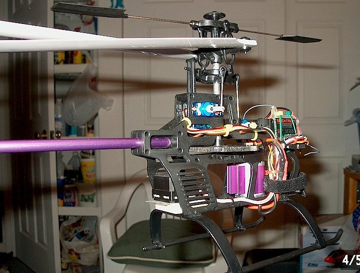

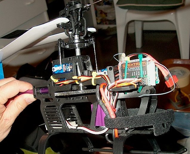

#654
Gy240 is installed!
Ok, I got some kind of logical response from my new Gy240 on the Axe tail motor, in a static bench test with the mains unplugged.
I set the Gy240 Gain to about 25%, and put both the On and Rev switches UP.
I guess I am ready for hovering trials, but am a bit nervous
I got no response until I adjusted the 3-in-1 board TR Trim to about 50%, and I assume that the Gyro Gain should be Zero there.
Any tests or pre-flight confirmations you can think of before I try this thing?

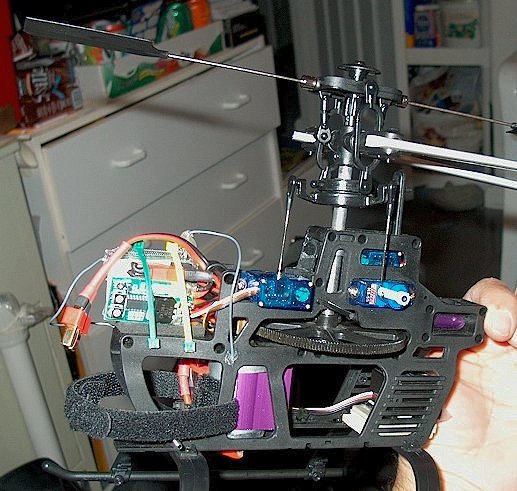

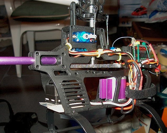

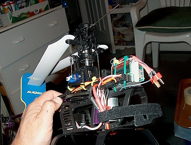

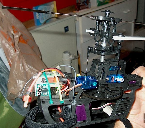

#656
BOOYAH!!
I flew out a couple packs, and she was wanting to buck me off like a bronco a bit,
but after a few tweaks, got into a pretty stable hover in the large clubhouse.
I dropped down hard a couple times, SLAP! Probably due to these sudden losses of lift we have been chatting about. I think I caught a nasty downdraft at least once.
I had to tweak my pitch and throttle curves - this is always a brain puzzle and I think I am closer tot he correct settings for me for now.
I upped the gain on the Gy240 to about 40% and set the e-board TR pot to yes, about 40%. This was after playing a bit with 0/25, 25/25, 50/25.
Yes the Gy240 must have its REV switch ON - its Reversed.
The old fart that locks up the clubhouse at night kicked us out - but the last hover was really good! Just a very slight soft tail wag that I am sure I can dial out on the next pack!
Yes!!! So far I am pleased with the Gy240 and stock e-board working together.
Check out the pics of the installation - looks nice and neat, and I am glad I get to keep the stock e-board, and I am happy to be rid of the stock radio!

#657
ORIGINAL: markind

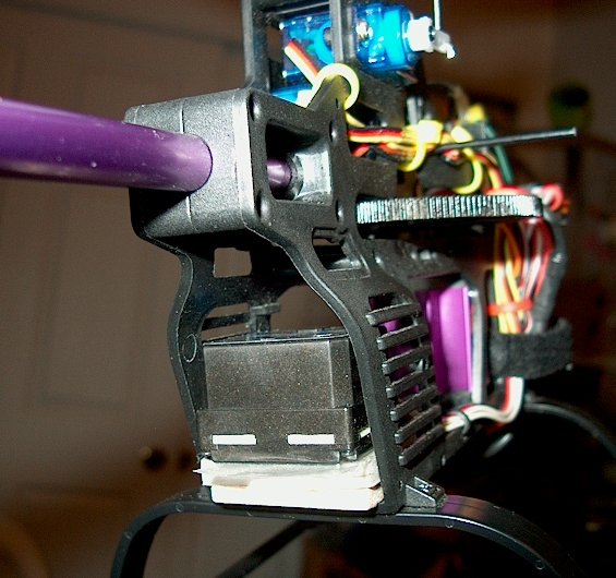

Based on the install method you have pictured above, exactly how do you get adjustment screwdrivers inside that tight space to peak and tweak settings? I just got word from Tower that my GY240 is finally on its way, and should be here early next week. I'm dying to get my bird flying again, however after having my E-board take a hit, I like the idea of hiding electronics in nice, reinforced, internalized spaces rather than having the gyro outside and on top of the whole darn thing, just asking to take a hit somehow.
Regardless, I will be installing mine with the Mini ESC that HeliMax recommends. I assume the only variable that I will affect with that is a slight reduction in operating time as opposed to running everthing off the stock e-board. (I do realize, of course, that having a damaged e-board would make that piggyback mod impossible anyway.)
Oh, and FYI, the 1kohm POT did not repair my failed e-board middle 'gain' pot. I was debating on trying a 10, and then 100K pot for the heck of it anyway, since they're so cheap.
StIIIIIIIIIIiiiiiiiiiiiiillll waiting.. Nothing works slower than Tower... they keep chugging, and chugging, and chugg...
#658
ORIGINAL: strtykrincognito
Markind,
Markind,
Easy! I read a tip (I think from here or Model Airplane News) that says you should not stick your gyro directly onto the foam sticky tape.
Instead, take some regular clear tape, and tape some on the bottom of the gyro. Then put the taped bottom of the gyro on the foam sticky tape.
It holds very firmly, but can be pried off and re-atttached several times without degrading the foam tape much.
If you have to, its easy to remove the clear tape from the gyro and clean it with alcohol. BUT getting that foam sticky tape off can be a nightmare...
I did some hovering here at work in the big, unused conference room. The tail is like 99% ROCK SOLID - BUT there is still a slight drift to the right - I have to input some left stick every 5 or 10 seconds to correct the heading.
I am very pleased with the operation of the gyro with the stock e-board. So far, so good. I hope to nail down the tail settings over the next couple packs.
Also, I replaced the 'see-saw' bit in the main rotor and had tightened those two screws down too tight - this made for some NASTY control problems in flight. I loosened them about a quarter turn, so the flybar was again floppy and loose, and the control problem was fixed.
My tip for the day is: Make sure you work out all the slop in the main rotor head - replace any loose ball-linkage parts. Give a light lube with plastic-safe light machine oil BEFORE you install new ball-linkage parts - they will snap on easier and last longer, and the whole rotor head will run smoother, giving a more glass-like, motionless hover and better, smoother control overall.

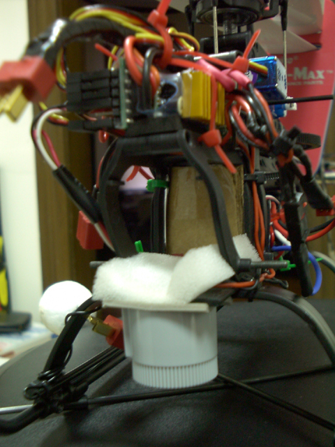

#667
So much for being efficient, safe, and prepared. [sm=drowning.gif]
I rec'd my new GY240 yesterday in the mail. Yay.
I installed the gyro with the GP C-12 Mini ESC per Heli-Max instructions. I put Ultra Deans connectors between the new ESC and the battery feed. I also followed spec and put an U.Deans on for the Rear Rotor connector. I mounted the Gyro to the foam tape, but used 3M UltraLoc velcro-like strip to secure to rear lower chassis. This has proved very secure, and yet removable for adjustment, just use a small screwdriver to seperate. Set Gyro for about 60% Gain.
Tested, stable. Flies pretty good. Tail's pretty stable, but it sure takes some getting used to flying with a HH gyro.
WARNING!!: They're not kidding when they say the tail will start up the second this Gyro detects about a 10 degree change in heading. Surprised the crap out of me for the first 5 times or so that I moved it myself with the main rotor parked. When you're learning to hover from scratch, this can be a problem, because every time you orient the heli on the ground for initial takeoff, if the Gyro's already locked on, it'll forever attempt to compensate to return to it's ZERO heading. [sm=what_smile.gif]
Back on the bench it goes.
Installed SPST Microtoggle to top of Tail Boom mount, wired in main battery path (-) line.
Test flight: Success, no problems, and at my skill level the amperage draw on the microtoggle won't exceed it's thresholds.
Benched again, this time to install the LiPo LOA from Appogee (Loud Obnoxious Alarm).
And for the screwup:
I had all the Ultra Deans connectors disconnected at the same time. They're all red. Apparently I became distracted, and plugged in the LiPo into one of the other Deans connectors, which I think, amothing other things, bypassed the switch, and reverse polarity zapped the receiver. Spark. snap. uh oh. Plugged the battery into the right connector, flipped the switch and watched the magic SMOKE escape from the receiver board's IC. [sm=angry_smile.gif]
I have no idea how much damage I really did to the bird, but the servos didn't look happy, and now the Rx won't even power up. I have a new Rx board on overnight from Tower heading my way, but I'm concerned I cooked more than it's worth now.
Live and learn: I've now color coded all the Deans conectors on the bird for future reference. Grrr....

Question One:
If anyone out there would be so kind as to throw a meter on the outputs of the 3in1 ESC/Gyro board and let me know what kind of output voltages they see per wire while 'at rest' (i.e. motors disconnected, Tx off, disconnected from Rx, etc), it would be most appreciated. I REALLY don't want to plug in the 3in1 back into a new Rx module just to fry it as soon as I flip the switch. [sm=47_47.gif]
---Answer: Black = Gnd, Red & White = 5v+/-.
I'm about this *pinches fingers together* close to just ditching the whole electrical hooey and buying a new Tx/Rx kit, maybe a DX6 or something. I don't know. I just don't know where to go next; it's not worth it to me to keep futzing with this shrinkwrapped stuff, might be easier to jsut go and buy the whole assembly (I'm assuming then I'd only need an standard ESC to replace the existing, currently damaged 3in1 board anyway).
Question Two:
Curious thought though: What would it really take (part specific, rx, ESC, gyro, etc) to replace everything that makes the AXE tick? How much would I really be looking at? I know it'll all move to a better copter in the end, but hey, for now it'll make the AXE zoom around.

I was going to write this earlier, but now that you've asked...
Not knowing what is and isn't working, you could just remove the 3-in-1 all together since you have an aftermarket gyro. Just use a brushed ESC of appropriate amperage for the main motor (GP c-12 is $23). If the RX is fried, get a 4 channel Corona at BPhobbies.com about $20. Use the chrystal from the old Axe RX and you're up and running.
Sorry for your loss...[

ORIGINAL: PilotLight
My only question left is: What's the deal with the voltage stepdown? I know it might be a newbie question, but it seems like Rx units run at something around 6-8v, but the motor runs at 11v, and the 3in1 takes the 11v, and somehow spits out power to the Rx board that then makes everything else run too (servos, etc). Where does the power modulation happen? If I go with an aftermarket ESC for the main rotor, then I KNOW I can just tap off the main battery feed just as I did for the already installed c-12. So.. by having a BEC (Battery eliminator circuit) mean that it does the step down FOR the Rx? So, for example, if I were running two C-12's, I would have to make sure that both BEC's weren't fighting with each other, huh?
Just need a little clarity, thanks.

Yes, the 3-1 has a BEC and steps the voltage down to 5 or so volts for the rx and servos.
Hopefully, you removed the power wire in the tail ESC per the instructions so the 3-1 wasn't fighting the tail esc. Most ESC's have a BEC.
Yes, the c-12 should be enough. Some guys have measured the amperage to the main motor and its never above 10 amps, more like 6. If I were you, I'd buy a c-7 and use it for the tail. (cheaper) and move the c-12 to the main motor. Just remember that only one ESC should power the rx, and I wouldn't try to power it through the gyro. (disable the tail's BEC per instructions)
Do you have a way to connect a 4.8 volt rx batt to check the receiver without the 3-1? (Just run the servos) Maybe its still good and only the 3-1 is fried.
Just re-read and you stated smoke from the rx. You're just gonna have to experiment with replacement rx. Good Luck...
