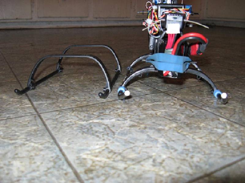

The Walkera 36 gear fits on the AXE as well, the gear I'm using right now is the 3D gear for the T-Rex 450 or Walkera 36. It's low & sturdy gear, went thru several sets of the stock struts & one set of T-rex struts, before finding the low-profile 3D gear @ Heliproz.
Here's some comparasion photos stock AXE CP struts & gear next to mounted 3D gear.

Nope, tail blades have plenty of clearance. I'm using a longer vertical tail fin, that keeps the tail blades from contacting the ground and they are independent blades, so if they to contact the ground they fold in (BDT).

It looks like yours is modified for a belt drive, not stock.
Maybe it's the camera angle, but it still looks like the tail fin touches the ground (floor).

There's about 3/16" of clearance between the tail blades & the ground, and yes it's a Belt-Driven Tail. Yeah, the camera angle isn't all that great, I'll take an outdoor pic & post that later.

I think I see what's happening here. I'm talking about the CF tail fin touching the floor, not the tail rotor.
That belt drive is a good looking mod.

Yup, you figured it out Gary, the CF tail fin "IS" my tail support, keeping the blades off the ground (most of the time, sinks-in softer materials:snow, mud, grass, etc). That's the tail modification kit from Don @ Freestyle-Hobbies, has work perfectly since installed, 3 months ago.
