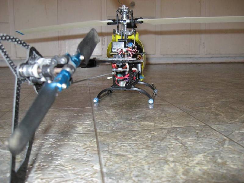

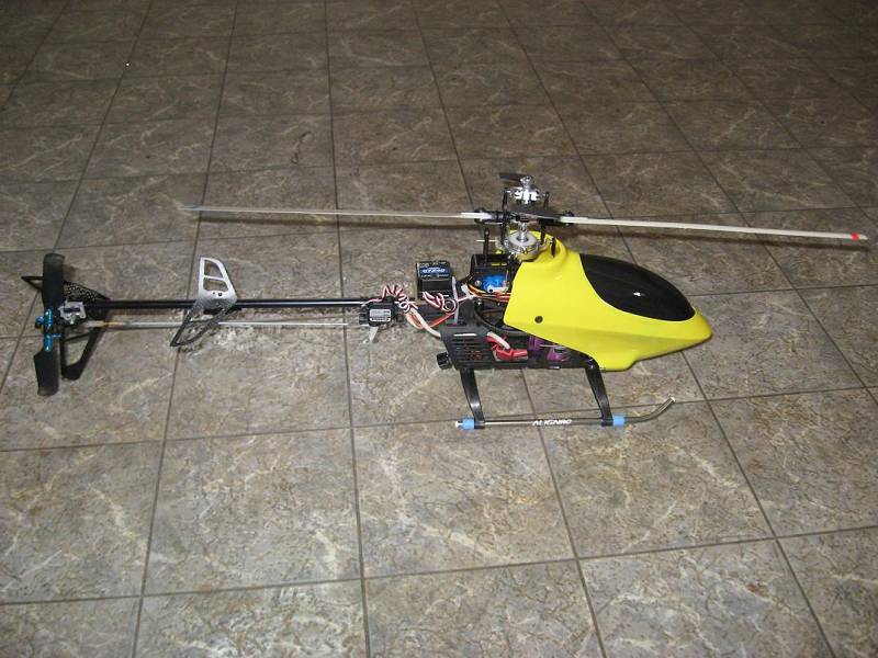

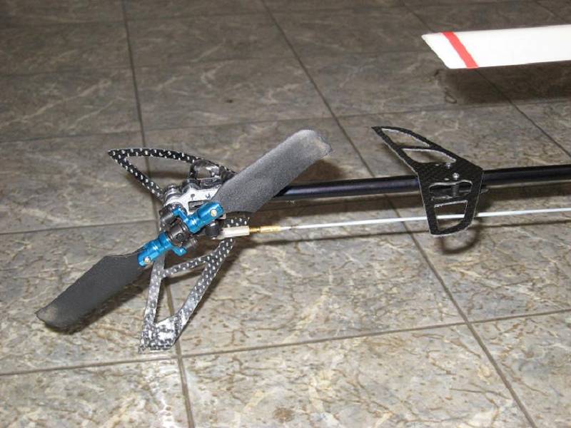

Have you considered switching the tail to a Belt-Drive? My AXE CP has the Belt-Driven Tail modification from Freestyle-Hobbies, still using the stock 380 motor, although I dumped the 3in1 for separates. You'll end up with a lighter more responsive AXE CP!
Tail response is 10 times better than the stock unit, flight times with a 1350mah 20c Lipo is around 10-12 minutes. Don at Freestyle did original testing on the stock "crap-pack" 10.8v 650mah NiMH
battery, without any issues.
Here's a few pics of my monster:
Rick
