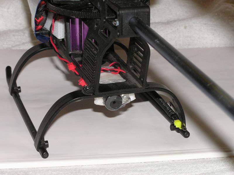

Can someone take a couple measurements for me? I'd like to know the height of the landing gear and the distance between the 2 mounting holes. Prefer mm, but inches is OK.
Thanks.

Hi Mike. I think I've found the answer by a reply you made in another thread. The stock landing gear is about, but not more than 42mm tall, and the space between the mounting holes is 42mm.
What I need now is someone that has a digital camera, a decent looking Axe CP (not all patched up
) , can take a couple pictures of pretty good quality (doesn't have to be professional, just decent), and who would like a free (open sample) set of SuperSkids400 Landing Gear in trade for the pictures. Before we can say for sure that SuperSkids400 will fit, we have to know that our unique design won't interfere with the canopy or other parts of the heli. http://super-skids.com/superskids400.htm
If you, or anyone else is interested, let me know in this thread and we'll finish the transaction by PM or email.
Thanks.

Ok Gary, you've piqued my interest. I can shoot macro photos in high res with my camera. As far as I can tell from the web site that you posted, I dont think there will be any issues with the canopy or any other conflict of space.
the measurements you were asking for;
mounting bolts centerline to centerline: 40mm
height from ground to top of skid support: 43mm
hope this helps.

That helps, but raises a couple other questions. Are you measuring the landing gear mounting space width on the landing gear or the frame? In one of his posts, Mike said the Align landing gear bolts onto the Axe frame. Align uses 42mm spacing. I can't find a good closeup pic of the Axe frame, so I don't know if the mounting holes are actually holes, or slots. If the frame uses slots (or very large holes), then either 40 or 42mm might fit.
It doens't really matter, I suppose, as the SuperSkids400 have holes drilled at 38mm (for other 400 size helis) and 42mm (for T-rex), and you can use a 42mm hole on one side and 38 on the other to give you 40mm.
Just out of curiousity, could you double check the measurement?
Are you interested in my offer?

Gary, the stock landing gear supports do measure 40 mm CL to CL. The AXE frame is in two pieces and does not have a fastener at that point, it uses the landing gear support as the fastener, so Mike is correct in that the Align gear would bolt on. There would be a 2mm gap at that point on the frame, no big deal.
Yes I am interested in your offer. As a matter of fact, some carefully angled photos would describe what I meant in the previous paragraph.

OK. A picture is worth 1000 words.
Please PM me with your name and mailing address, line by line so I can copy/paste. I'll try to get them out tomorrow is I have time. Otherwise Monday. And thanks.

I said the HDX450 landing gear will bolt right on - the HDX aluminum and steel landing gear actually has 2 holes on each side drilled right next to each other (actually touching each other), and and the HDX bolts right on.
