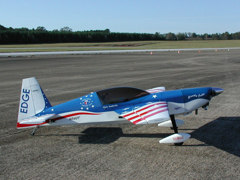

Here is my Edge on the ramp at this weekends' fly-in. I ordered the all-white version so that I could do this scheme. I'm anxious to get started in my IMAC practice with some help from an experienced competitor that I know. It seems that most IMAC'ers are in the 35 to 40% scale range. Do you see many in your area flying the 50cc size A/C? I know that skill has nothing to do with the size of your equipment (!!) but am I likely to be judged differently with the smaller airplane?
I'll start a new thread in the ARF section with a ZDZ / Christen Eagle question for you - please take a look.
Chris

Here is my honest opinion on IMAC
The rules - always driven by the most keen and active competitors, have driven IMAC into the same old trap that hits all of the competition groups
That trap is in promoting as " truth", the idea that any plane size can be flown with equal chance for success.
Not true.
The reason is objective-not subjective.
The TIME it takes to fly the sequences changes with the size of the model.
Bigger models = more time --more time to correct --more time to present - etc.
This is an almost impossible edge to overcome ,unless you are very proficient - which most entry level flyers are not.
So-- even a very amateur newcomer can look good with a large model -which is less demanding to fly.
You can do well with a smaller model but you must must fly very well to place better than a less skilled presentation with a larger setup-
If you can fly and win with a smaller model -you are absolutely a better pilot.
We do have,locally, guys flying 50 size models - but this rarely goes beyond the first two classes.
The bigger models just plain ol present better .
I like the 50 size model for ease of relaxed flying and low cost of practice.
I just sold my last larger model - and will shortly start on another .-as soon as I finish 3, 40% models owned by others . --

I haven't flown the larger models yet but I am awaiting a 40% Carden Extra kit due this spring. Sounds like if I can make good progress on the sequences with my DP Edge then the big'un will make it easier to actually compete. I had my suspicions about the judging (not to imply that it's overtly unfair) always being somewhat biased toward the larger A/C because many contests utilize other competitors from the upper classes as judges. Just human nature to be favorably inclined towards others' choice of something you already have (kind of like why I responded to your EDGE post, huh?). Well thanks for the good advice again, Dick.
