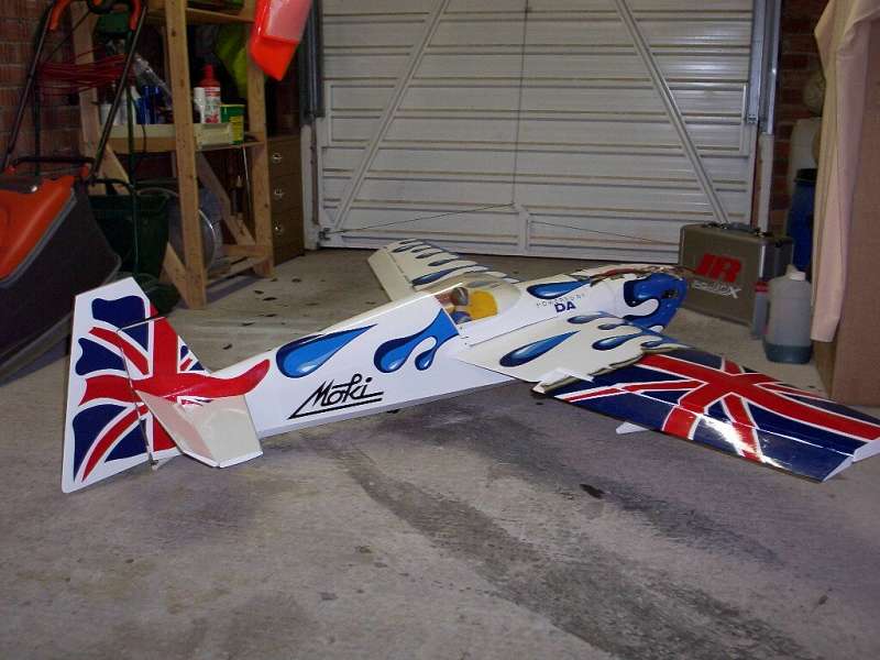

I have a Moki 1.80 in mine and modified it for rear servo install. The CG came out right on the money basically with that engine and 2 hitec 605's in the tail.
My guess is it would come out tail heavy with the Saito. I'll post a pic of the basic finished install here. I have several more step by step if you might be further interested...I'd be happy to post for you.

I am also flying my H9 Edge with a Moki 1.8 and the tail mounted servos. No added weight was required. Your Saito is somewhat lighter than the Moki with a Bisson muffler (Approx. 49 Oz.). My suggestion would be to mount your engine and all equipment except the elevator servo (servos), just tape or tack the tail feathers in place. Then put the plane on the balancer and decide where you want the servos. Do not permanently install the vertical and horizontal Stabs. till you decide as it is much simpler to make the modifications for tail mounted servos without the horizontal Stab. in place. Good luck with your Edge, I hope it flys as well as mine.
[8D][8D]. Oh yes, my rudder servo is pull-pull in the stock location.

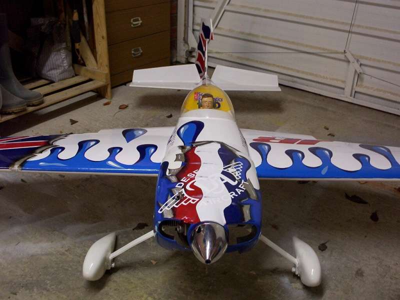

RE: Hangar 9 Edge 540 query in response to Ronbo

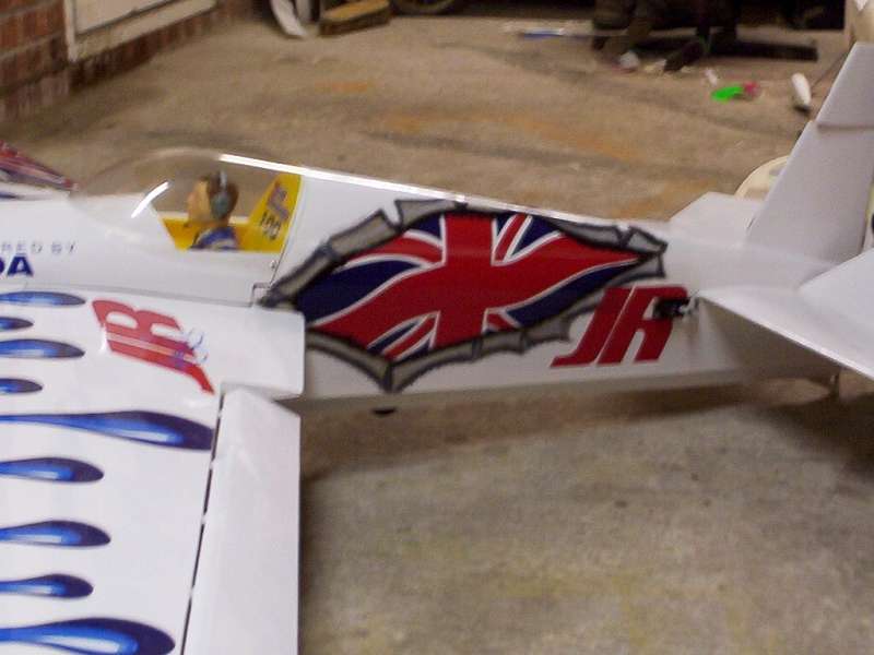

These planes fly well if they are set up correctly. If you take your time then you'll enjoy the plane, if not you'll be taking home a bag of bits.I had one (sold it didn't crash it) with a moki 180 (superb engine) and an internal tuned pipe inside the fus. Also had 2 JR DS 8411 on the elevators. I recovered mine because i didn't like the colours. I covered it in profilm and airbrushed my design onto that. Pictures are below.
hope this helps,

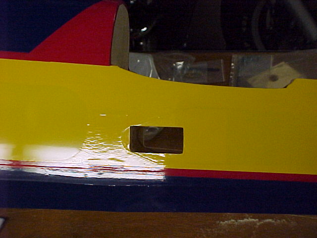

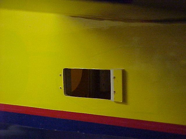

The first thing I did was to make the filler plate that I glued into the rear servo area. To get the pattern close, I used the side of a freshly sharpened pencil. I taped a piece of paper to the area, then shaded the original cut-out. That left me with a reasonable impression/pattern to start from. Once I had that done, I just cut out a few pieces of light-ply, and sanded them for a near perfect fit in that cut out. Then I used med. CA to glue the plates in, so as not to disturb the existing covering. I then took the iron, and ironed the covering down to the area I just worked on, so when it comes time to cut the hole, I didn't have to worry about the covering lifting or anything like that. Don't cut the servo hole just yet though...
Then I planned servo placement. That won't vary to much regardless of servo, I just wanted a comfy geometry for the linkage. Once I was satisfied with the servo/linkage, and the overall placement, I cut the hole for servo....making it a comfy fit, and again checking linkage/geometry, and all that....
I'm going to put this in a few posts....my comp is not too stable these days....I dont want to lose this info before I'm done....
These pics show the approx placement, as well as the hole(s) after they were were cut and sanded out.......remember.....there are 2 sides to do...I recomend doing both sides at one time, and use a ruler, slid through the fusalage as a gauge for fine tuning the placement...much like lining up a stab to make sure its horizontal and true...

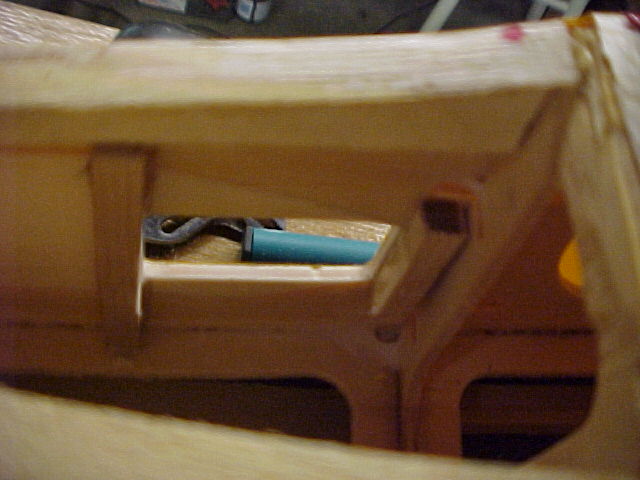

Then what I did....and I think this step is very important.....is to install some servo bearing blocks.. I used spruce I think... or any kind of hardwood, about 5/16" or so... enough for that servo mounting screw to bite into. Make them long enough to capture fully, so as to "pinch" the hole mounting into existing, as well as the plate that you added. I used 5min epoxy here, as once this step is done... I really don't think the servos are going anywhere. Again,,,this in my opinion is the most important step... your whole servo install is only as strong as the weakest link, and this shores the whole thing up....

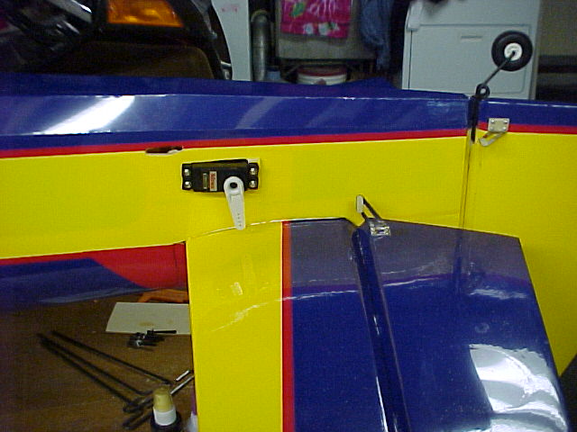

This pic shows the small "stand-off" that was needed for the linkage/servo to be canted to reach a very near 90'degree to hinge line placement... I just cut the covering enough to CA a small piece of lite-ply to shim it out a bit, then just ironed the covering back... With the exception of this cut, and making the servo hole itself... none of the covering was cut, or comprimised in any way.... leaving it looking like a factory install. (Don't know why I liked that...it takes a very good factory to outbuild me... LOL )... Anyways..... here is is...
And again......here's the final product. To wire it ..I used a tube installed in the fusalage to capture the wiring....or you can make one out of paper/card stock...or Don's hobby has them(For $10 you can get a lifetime supply of the stuff)... or if you have any other way to secure the servo wires in the fuse I'm sure you can figure it out.
I used a servo-reversing Y-harness from Horizon hobby... come to find out later..I could have just programmed it in my radio(I pretty much knew it then too)...anyways..... A 9CAP is what I use... and it will work a few different ways with that transmitter, depending on the reciever, will tell you which way you might want to go with it. I've done 3 of these so far, and each one a bit different in the way it was totally done.. but these pics are prototype of my first one(the one I own), and I may upgrade my programming and ditch the Y-harness, as I do see slight advantages to programming it in.............so........that does it for DGrant's H9 elev servo install......stay tuned for more episodes.... LOL... I do hope this does help though.... I'm going to the shop now.... I have urge to build for some reason....
