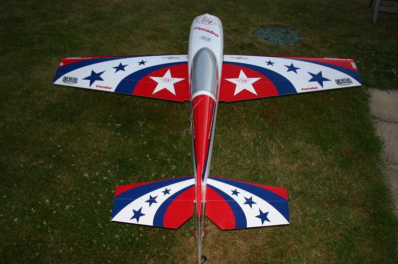

Hi Mark,
Excellent work she looks fantastic, particularly with the additional decals. What sort of a power box are you using? I look forward to your flight report.
Cheers
Lang
Cheers
Lang
#131
Posts: 5,193
Received 1 Like
1 Post
From: SevenoaksKent, UNITED KINGDOM
Hi Lang,
Didn't get out over the weekend - hoping to fly her tonight!
I'm not running a powerbox - don't think it's necessary on this size model. Am running the new(ish) PowerBox sensor switch connected to 2 TP2100mah Lipo (excellent bit of kit) and a Powerbox systems voltage regulator on a TP2100mah lipo for ignition.
Rgds,
Mark

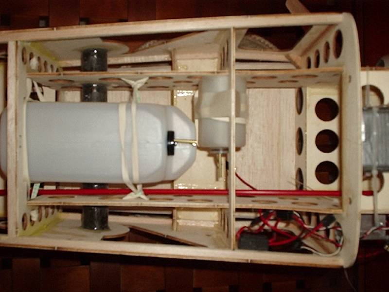

You will need some elevator to rudder mix for knife edge - I have about 10% but this will change depending on your CofG position.
I also felt a huge transformation through manouevers when I mixed in about 4% down elevator at idle. Downlines stay dead vertical and it stops any balloning when you cut the throttle to land.
I can fly for 30mins easy with the DA50 and the 24oz tank so this could be swapped for a much smaller/lighter fuel load.
After 4 10min flights I recharged my 2100mAh lipos and put approx 450mAh back in them. The ignition back however required about 1000mAh which suprised me!
Anyway, will keep you posted of any changes/insights!
Rgds,
Mark
#139
Joined: Dec 2002
Posts: 78
From: Schaffen, BELGIUM
I finally maidened my Extra 2x2, got already 15 flights on it.
I haven't programmed any mixes yet, i only programmed a throttle curve so i can hover at 1/2 throttle instead of 1/3!!! It's just easier to control the rudder that way....
Thanks for your info on the mixes schroedm
I maidened mine with the CG 115mm back from the wing tip LE. No probs for F3A or 3D flying.
I'm still breaking in the engine with a Menz 22x8, i'll take more pics when i put the mejzlik 23x8 and carbon spinner on it.
I made some ventilation holes in the back of the fuse because the muffler(no tunnel) was heating up my electronics
Gr Gaaaz
Gr Gaaaz

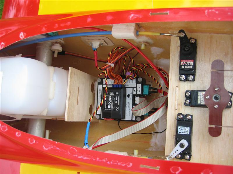

Does anyone have any close up shots of how you have setup your throttle when using the DA-50? I am a little puzzled as to how I am going to achieve this.
Regards
Chris
Regards
Chris
#142
Joined: Dec 2002
Posts: 78
Hi Chris,
This is my throttle setup with a DA-50. I haven't got the engine update, so my carb is still 180° turned.
In my previous post you can see the throttle servo (hitec 5975) and the choke servo (graupner/jr c5077) in the rudder tray...
Gr Gaaaz
Gr Gaaaz
#143
Posts: 5,193
Received 1 Like
1 Post
Haggy,
Have a look at the build thread here www.composite-arf.co.uk - my DA50 has the carb update so your install could be done the same way - nice and direct!
Rgds,
Mark
Rgds,
Mark

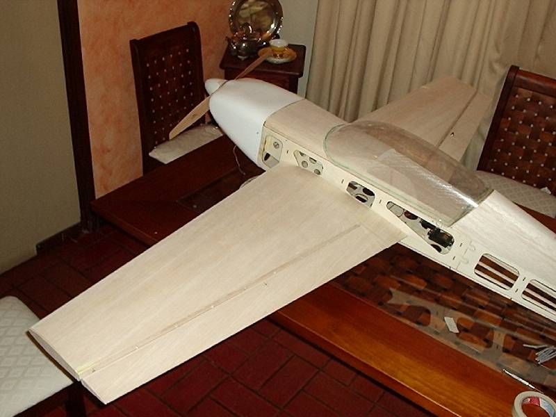

hy,
i really want to finish my 2x2 ca model extra kit,,, i´m working about 1 month and i think finish about 1 1/2 month more,,,,, i read your kind of fly and wwoooouuu 1/3 to hover thats very nice..
i put a Brisson 3.2 with a 22/10 i think 23/8 is the prop, but i dont found it...maybe finally i put 22/8 i dont know.
