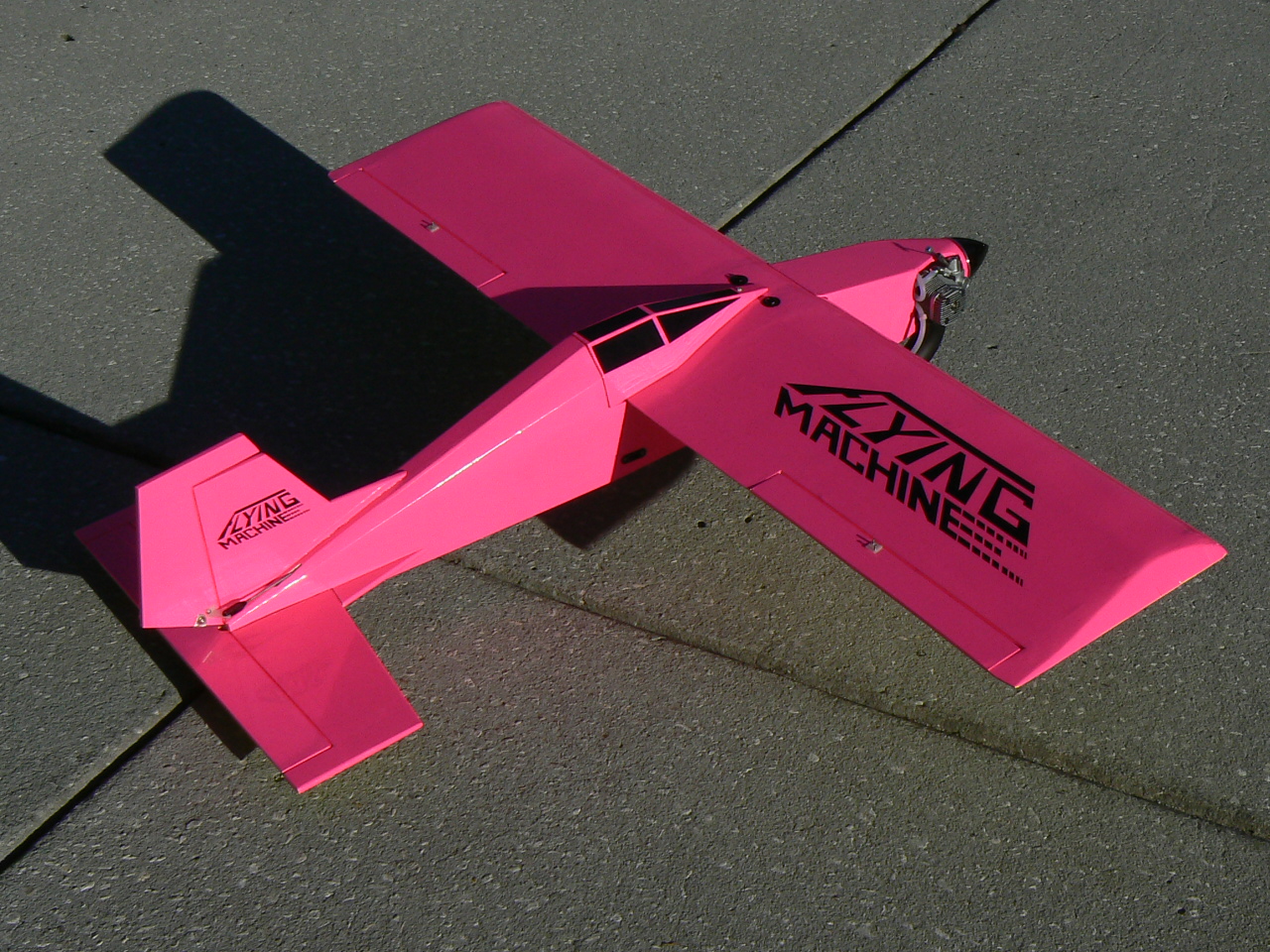

It is starting to take shape. I did the initial CG check today and it may be an ounce or two nose heavy. The battery will most like have to go in the tail. Putting the OS 55AX in the nose with a 2 1/4" spinner reminded me of what Dolly Parton's dad is supposed to have commented about Dolly's overly endowed figure. "It's hard to put 10 pounds of flour in a 5 pound sack." Minus pushrods and covering, it weighs just at 4lbs.

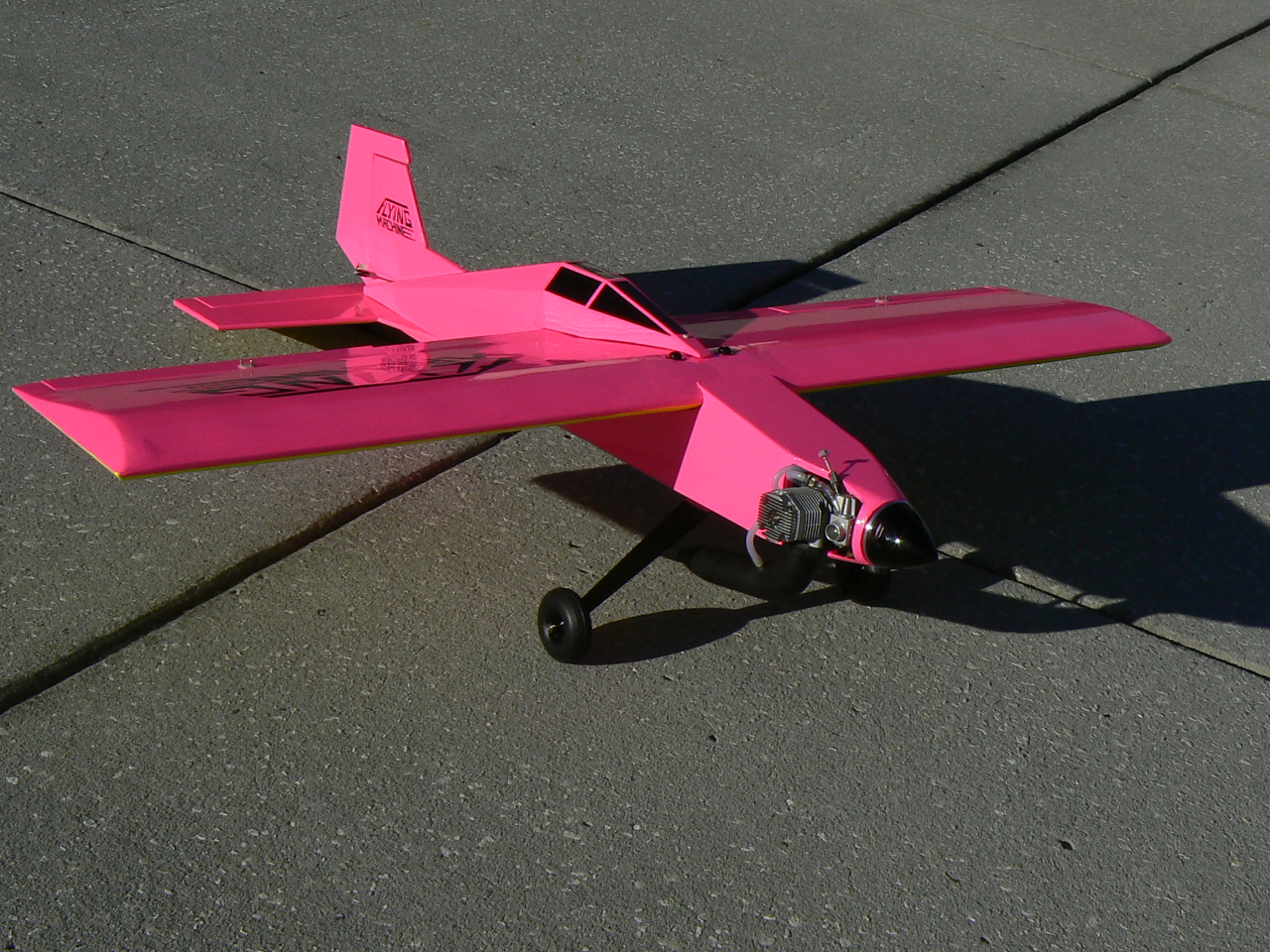

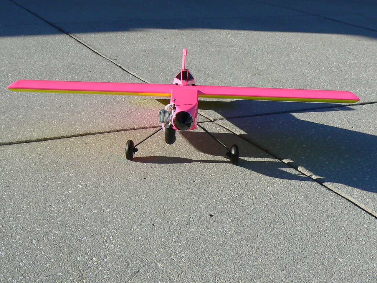

The plane is basically finished. A few tweaks left such as engine runs to decide whether to use the Macs or standard muffler and which prop. The plane has the OS 55AX with HS 485HB standard servos for elev and rud. HS82MG servos are used for each aileron and an HS81 servo for the throttle. A Hayes 8oz tank was used. The total weight came out at 4 1/2 lbs. The CG is at 3" aft of the leading edge using the Macs muffler. Don has 3" aft of leading edge written in his assembly maual for the CG and the plans measure 3 1/8" aft of leading edge. So I think for initial flights it should be fine at 3".

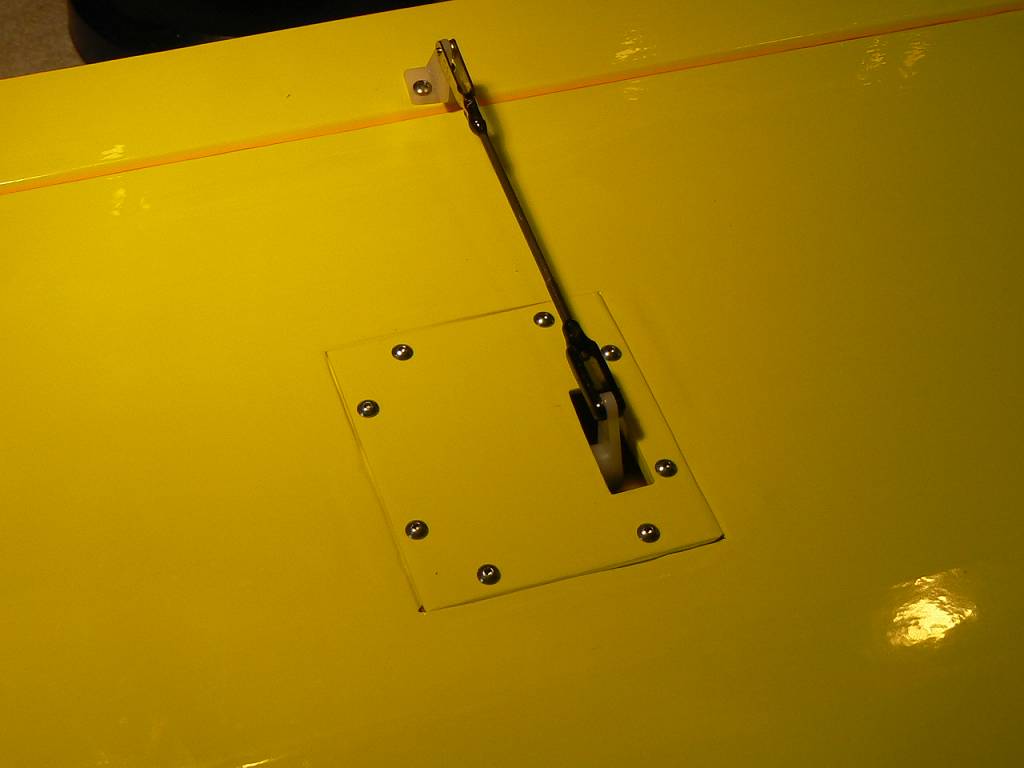

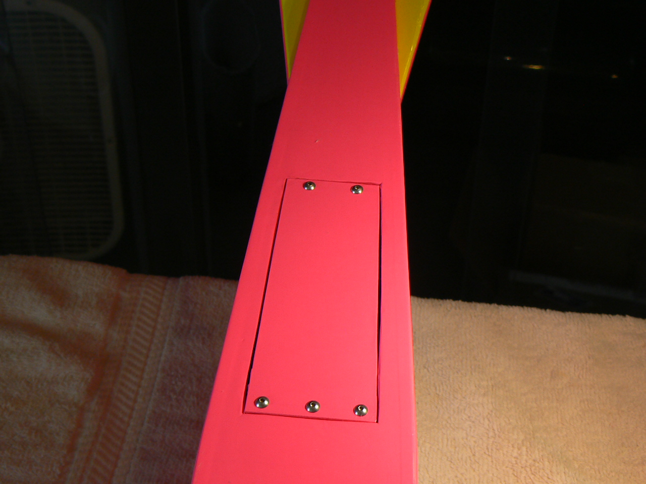

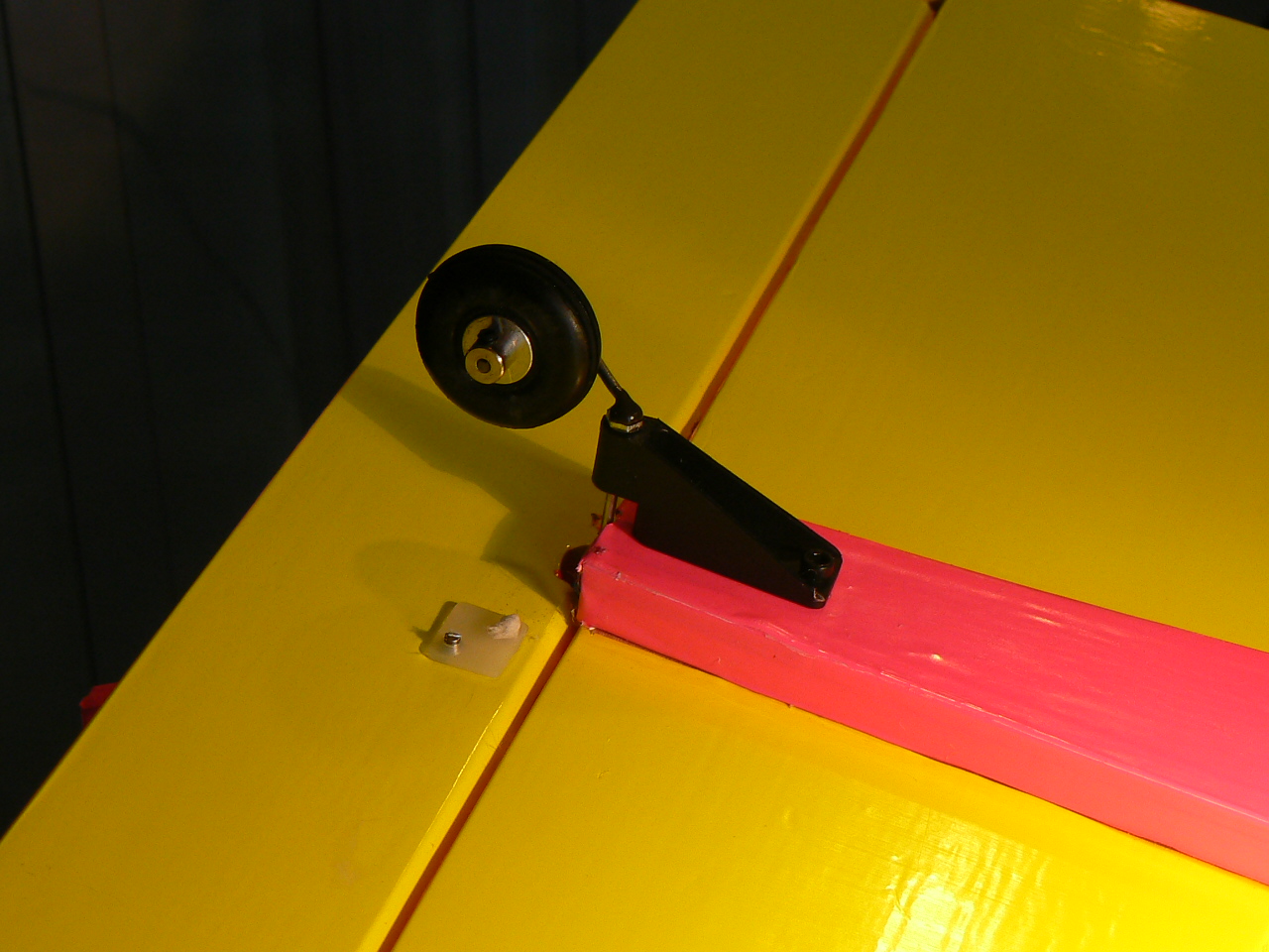

Here are a couple of pics of the few little things I did differently from the plans. I mounted the aileron servos in the wing, the battery is mounted in a removable compartment in the aft fuse to balance the OS 55AX motor and the tail wheel is installed without the wire being permanently mounted in the rudder.
