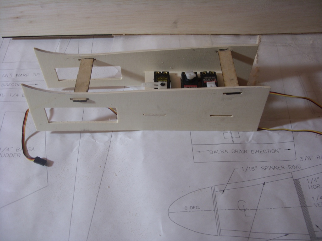

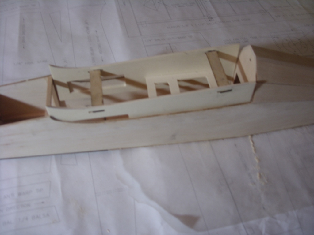

I have a question, Are you building the wing mount per plans. (with the aluminum/plywood strap) or doing something different?
 Iwas just wondering, I think I have an easier and just as strong idea.
ED

Can I ask what your thinking about doing with yours? I built this plane once years ago, and haven't started my short kit yet (too many other projects now) but should after x-mas. But when I build my first flying machine it was the first time I had used the aluminum strap method, but it was easy, fast, and not hard at all, not to mention super rigid. I guess I am wondering what could be simpler and stronger? I planned on doing the same with mine when the time comes.

I was planning on using lite ply doublers with notches for the hold downs and an incorporated servo tray.
I will post pics, It will be a day or so. Unless I can get to the shop tonight.

Sice the block has to be flush with the wing saddle, not sure how you would do that unless you left a gap there so the ply would encapsulate the wing block so it couldn't pull away from the fuse under a high load. Either way, I am not sure why your opposed to the strap method? If I were to do anything different, I may be tempted to drill through the sides of the fuse into the wing block and pin it will some epoxied in 1/8 dowels or maybe some toothpicks. Just a thought........

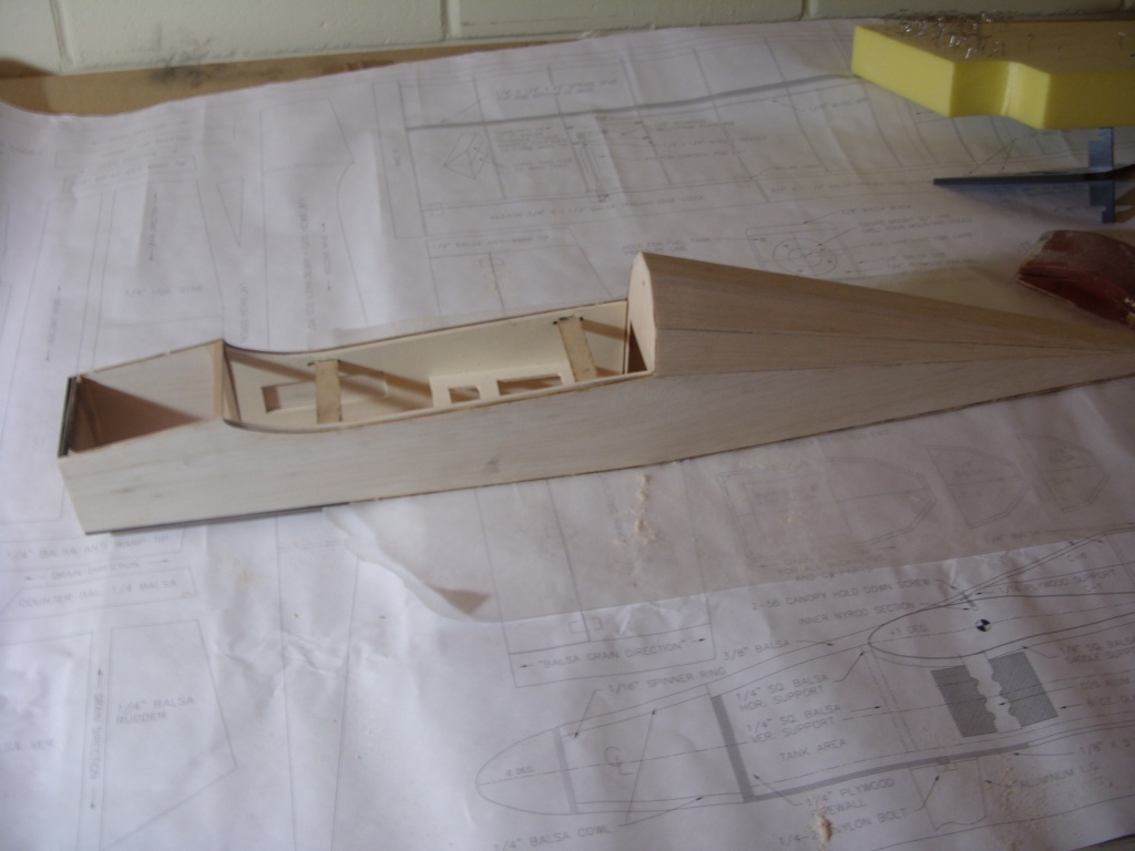

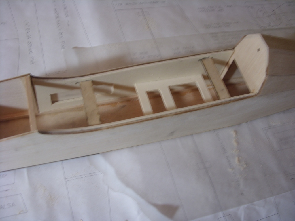

Here is the plan,
The lite ply is cut and fits in like a glove, from bulkhead to bulkhead and fuse side from fuse side. The 1/8" slots lock the 1/8"ply then 1/4" will be added to get flush on the wing saddle. for a total of 3/8" wing mount. I think the idea of adding a pin to the 1/4" would do the trick. It is a method I use on some of my scratch builds, and it makes a strong uni body structure.
ED

ok, so your adding a spacer to get the seat flush with the saddle. That should be plenty strong enough, thats for sure, maybe a bit of added weight (?) opposed to the other method with all of that lite ply, but maybe not after glassing it all and such. Look forward to the test!

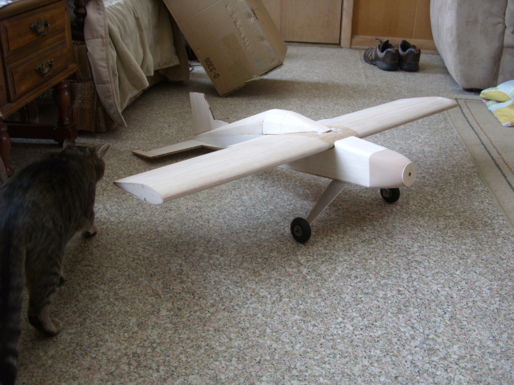

Heres mine Need some final sanding, add thewing tips, and start covering. My cat was was doing her inspection, (must like sniffing glue).
Ihave a plug in place for the cowl, and will vacuum a styrene one.
Looks like a fun plane, Iremember Don flying his at one of Byron's Striking Back. Iwas only 14It left quite an impression.
