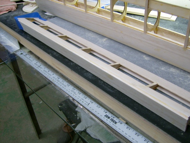

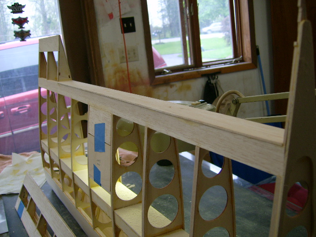

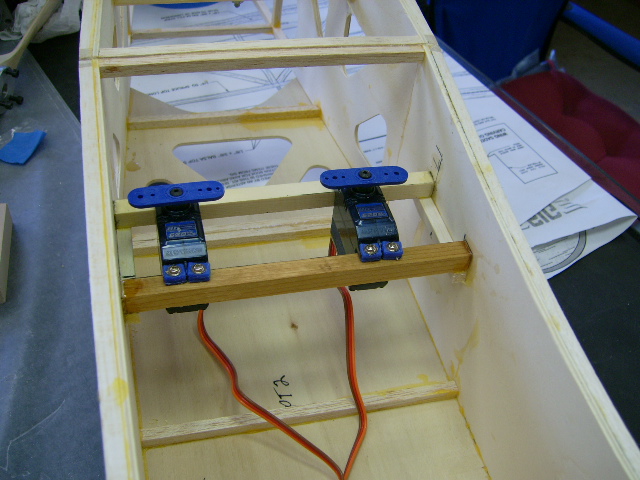

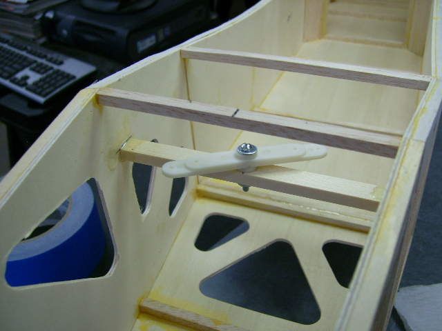

I mounted the aileron servos and cut out the ailerons - a job I was hesitant to do; but they turned out OK. A test fit of the wing tips found that they are a good fit. I think I will attach some mounting blocks on the wing tips to make it easier to epoxy the tips in place. What did you fellow builders do to attach the tips? Here are some pics.

I used mounting blocks, too.

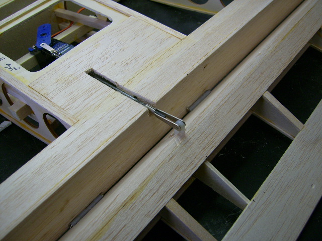

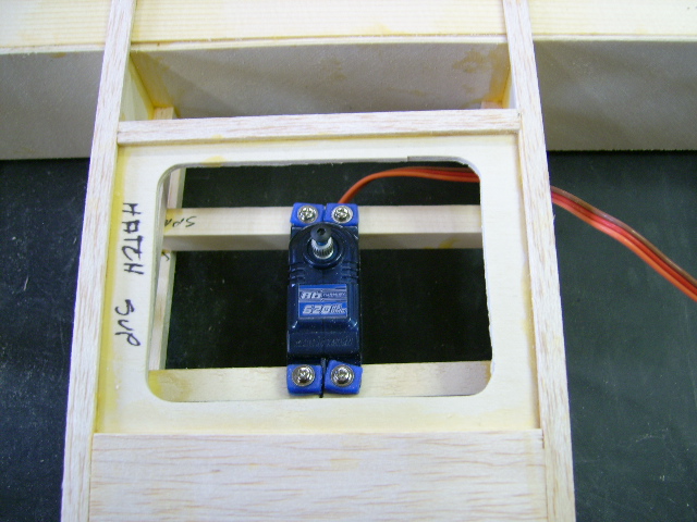

I cut the hinge slots for the ailerons and cutout the channels in the wing for the control rods. I am going to try Stix-it with the polyester cloth on the fin. I'll see how this goes before I cover any other parts. I applied one coat of nitrate to the fin and then a coat of Stix-it. I'll let that dry for a few hours and try ironing on a piece of cloth. I have used the cloth before with waterbase poly and it came out very nice. I shrunk it with a heat gun and it seemed to tighten up pretty well. We will see how it works with Stix-it and dope.

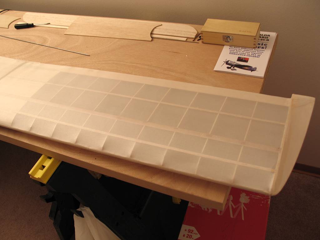

Covered the fin with Sunline 100% polyester dress lining adhered with Stix-it. Applied two coats of nitrate dope after initial heat shrink with a gun. Came out OK. There are some tiny bubbles on the framework that I think came from the Stix-it when heated. I was able to re-heat and smooth them out with my finger. This works well and I think this must be done before sealing with dope as there is enough air holes in the fabric before sealing. That is one nice thing about this fabric - when shrinking on closed structures the heated air can escape through the fabric. With pre-painted fabric you would have to let the air out with a pin hole.

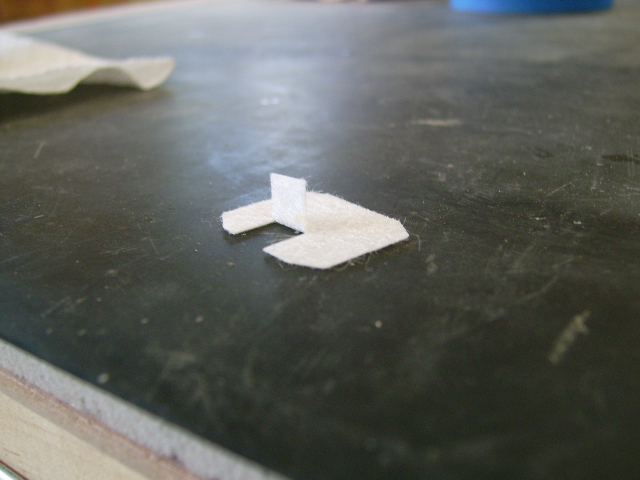

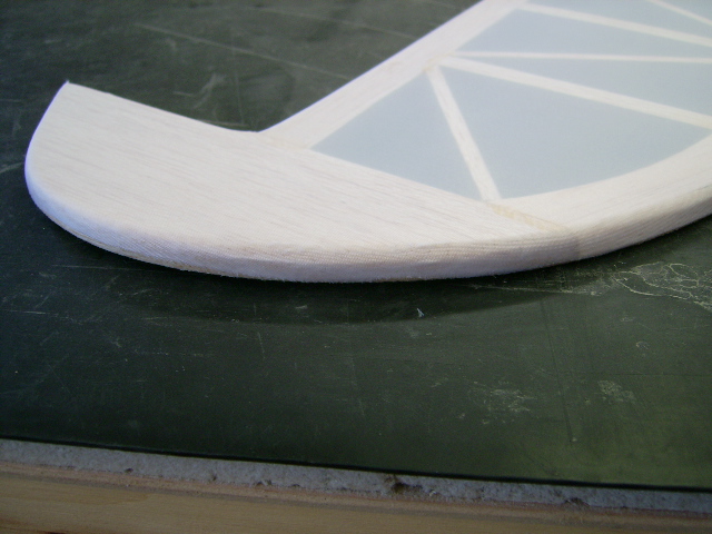

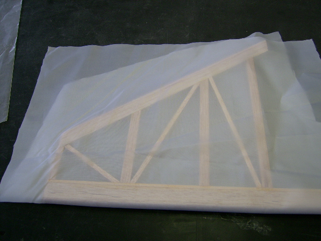

Here are some pics of the elevator. For anyone interested in the process, it goes like this:
1 Apply Stix-it or Poly Tack to the entire framework. Let dry.
2 Cut an ample peice of Polyester cloth.
3 Iron down the horizontial perimeterof the piece being carefull to not introduce wrinkles. Use low heat to prevent the adhesive from bubbling.
4 Flip the piece and trim the cloth to with 1/4" of the piece.
5 Seal down the overlap to the edges with the iron.
6 Coat the edge with adhesive and let dry.
7 Cover the other side of the piece like in steps 2 and 3.
8 Repeat steps 4 and 5 on the newly covered side.
9 Shrink the fabric with a heat gun being carefull not to over heat and cause bubbles. Apply the sealer coats. I used nitrate dope here but WB Polycan be used.

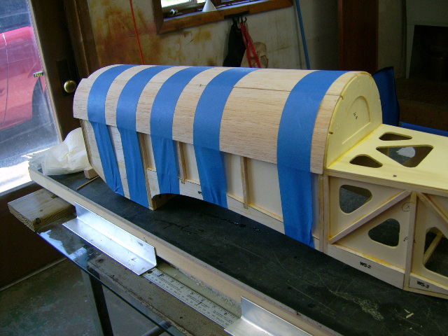

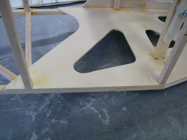

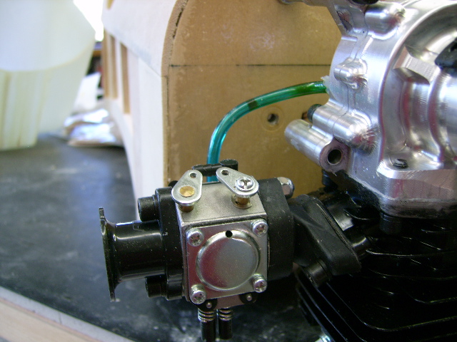

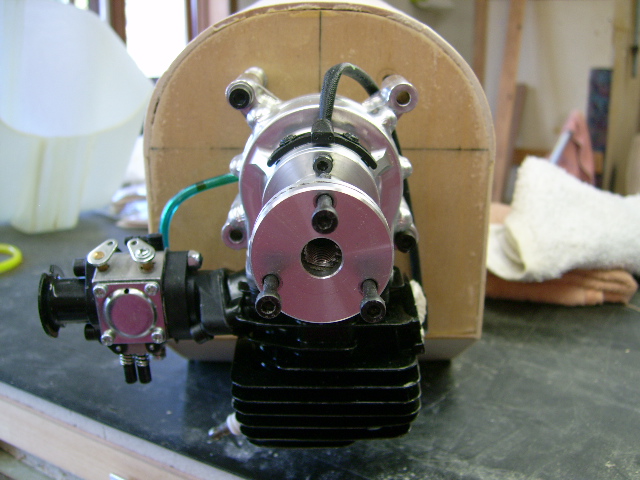

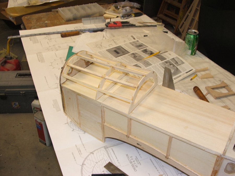

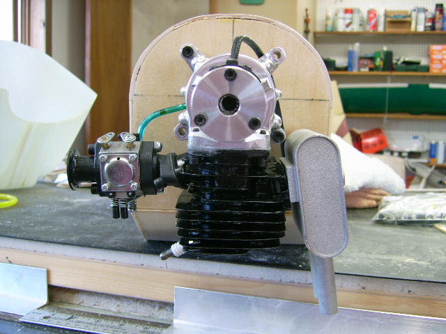

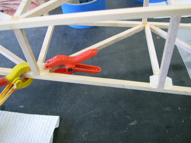

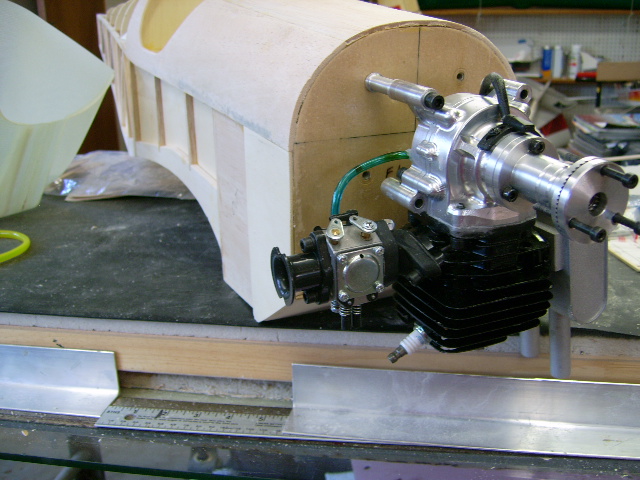

Started completion of the fuselage. Also the engine piston was polished and reassembled. I put some truse reinforcements in place; I used CA hinges cut with little tabs to tie the structure together. The top front of the fuse was built and sheeted. The center sheeting went on without a hitch. The left side was a pain; The wetted sheeting would not let the glue setup quickly. For the other side I edge glued the dry sheeting to the center with CA gel and then wet it with paper towels. When softened I the spead Titebond under the sheeting and taped it down. This method worked very well.

Well, made some progress -
1. Covered the nose with sheeting and cut out the cockpit.
2. Installed the formers for the longerons.
3. Put some lite ply supports on the first two formers. If the pilot leans back he won't break the former out.
4. Cut, shaped and test fit the balsa block to the front bottom of the fuse. I don't think I will glue it in place, I think I will make it removeable so that I can mount the throttle servo and ignitionmodule next to the fuel tank and have access to all that stuff.
5. Test fit the engine to see how to setup the throttle servo and ignition. Found that the throttle arm can not be rotated on the carb throttle plate rod. The arm has a "D" shapped hole and can't be repositioned. It also has a strong spring that I think must be removed.
The build has been pretty simple up till now. The fun begins now. The 24 oz tank will fit nicely at the proper height if mounted just below the cockpit floor and offset to the same side as the carb. This leave plenty of room for the servo and ignition module.
Anyone else had a throttle arm angle like this (see pictures)? If so sugestions are welcome.

Old 06-03-2011 | 02:49 PM
  #173
huck1199's Avatar
Joined: Jan 2007
Posts: 1,550
From: Lancaster, NY
Default RE: Sig 1/3 scale Spacewalker
More

Huck,
I think some guys use a steering arm from a nosewheel assembly on the throttle shaft.
Joe
Yeah, I will have to mount something on top of the throttle arm and connect the push rod from the other side. I am thinking of a servo wheel; the space is small. Your picture didn't come thru, but I get the idea. Thanks.
Anyone know if you can take an Rxcel module apart to take the plug wire off to snake it thru the firewall and the re-attach the wire? I am afraid to try it, don't want to destroy it.
