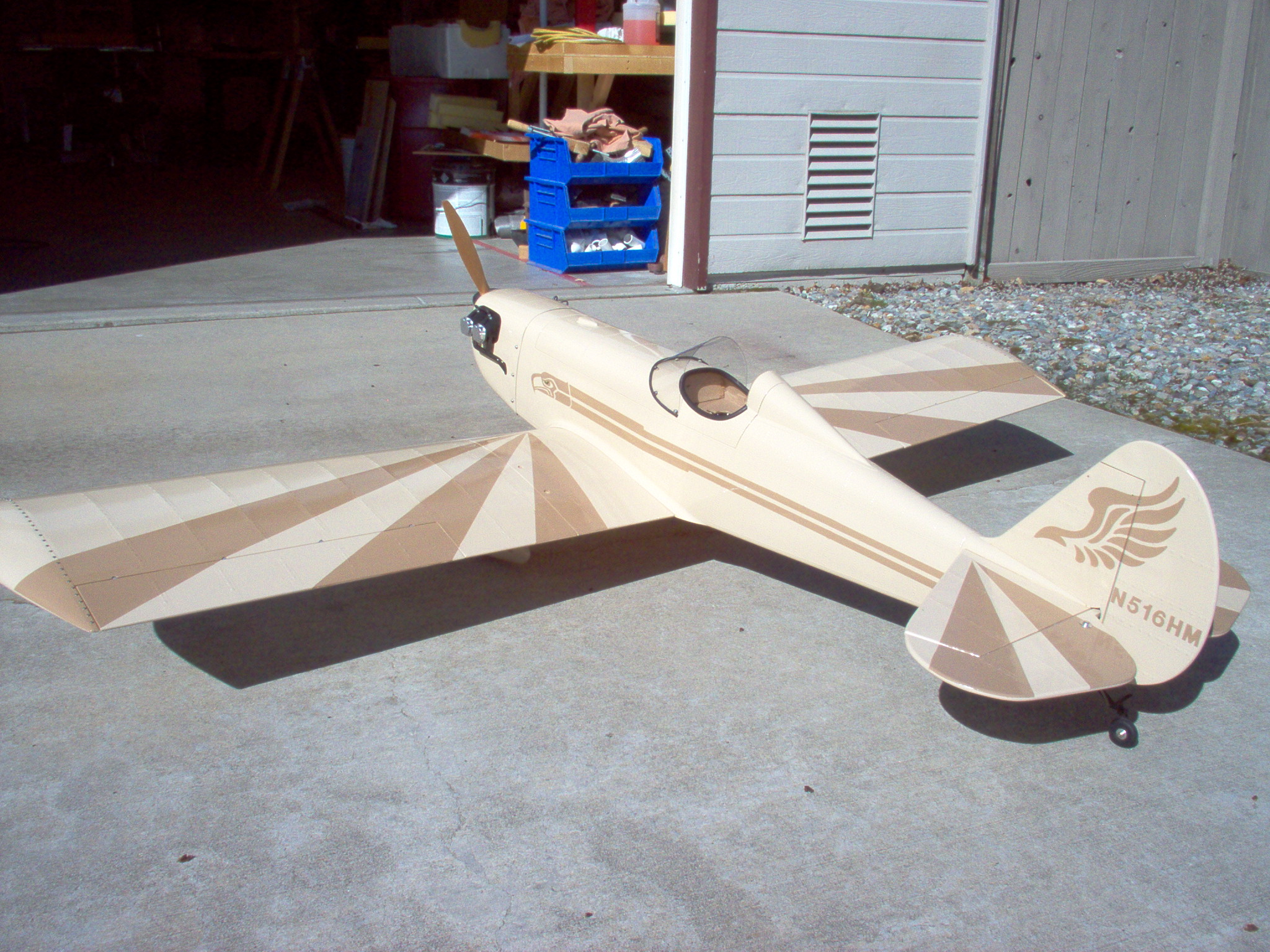

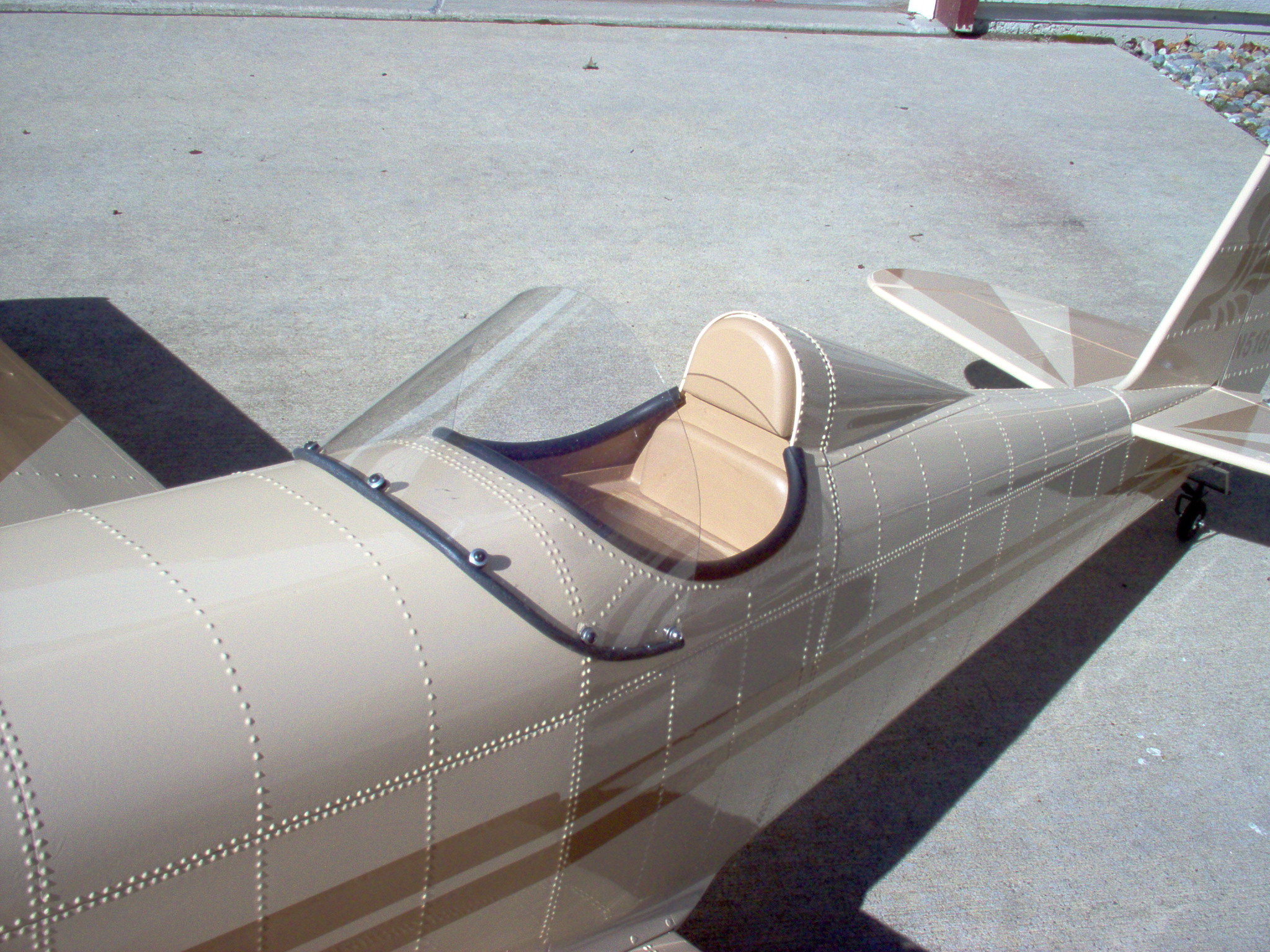

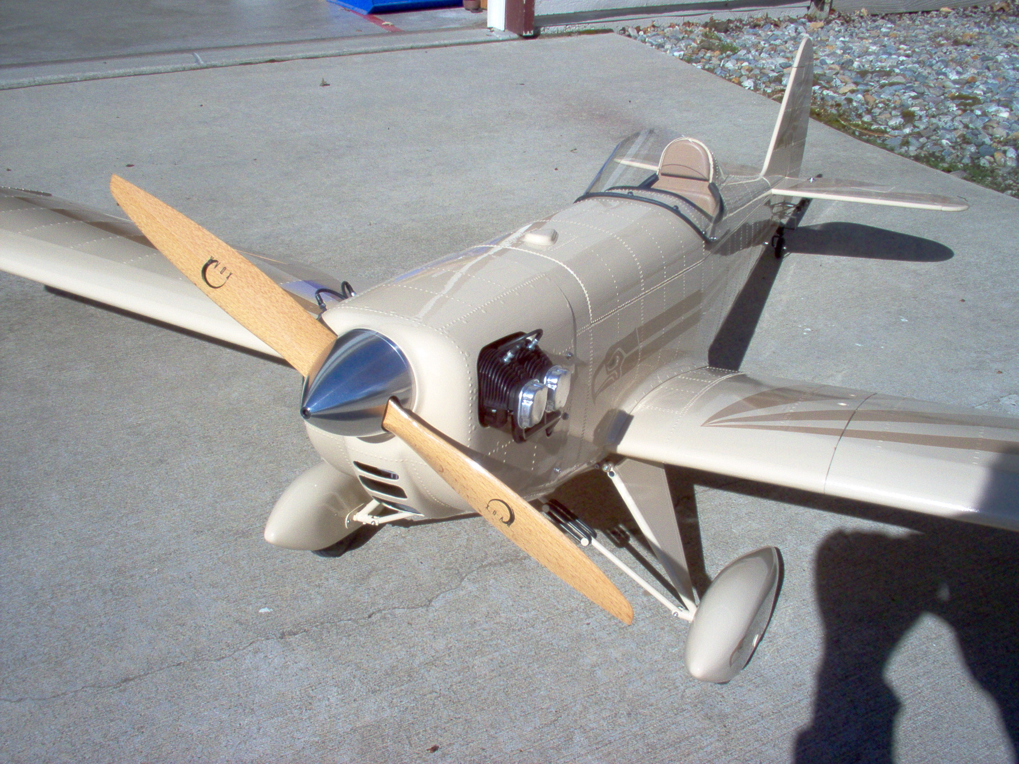

Old 04-06-2017 | 07:44 PM
  #223
Joined: Jun 2009
Posts: 2,285
Received 6 Likes on 5 Posts
From: Idaho
Glad to see some action here again, the Spacewalker 11 is such a neat plane in both 1/4 - 1/3 scale. They also offer some nice adaptable modifications and keep their great flying characteristics. Mine is 1/4 scale with a 3 piece wing and fixed center section, wings mount on tubes. Cockpit is on a removable upper deck and in the same location as on the plans, I contoured the fuselage planked and glassed it to look like metal and added the head rest to look a little like a Ryan STA, very sporty. All else on the plane is per the plan. Rivet detail is punched 1/16" litho plate, had fun putting them on, panel lines are there also. Top Notch 1/4 scale dummy engine dresses up the front end, engine is a DLE 35 RA.
Enjoy,
Leroy
