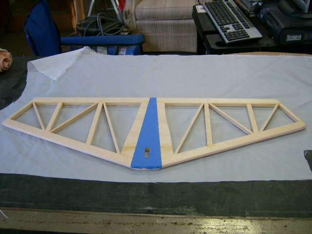

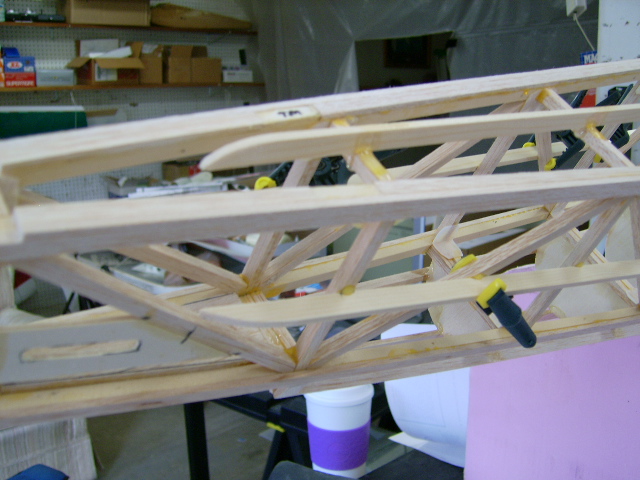

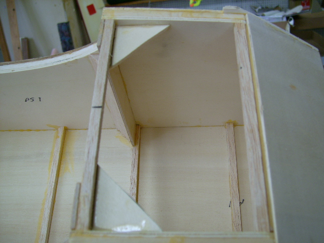

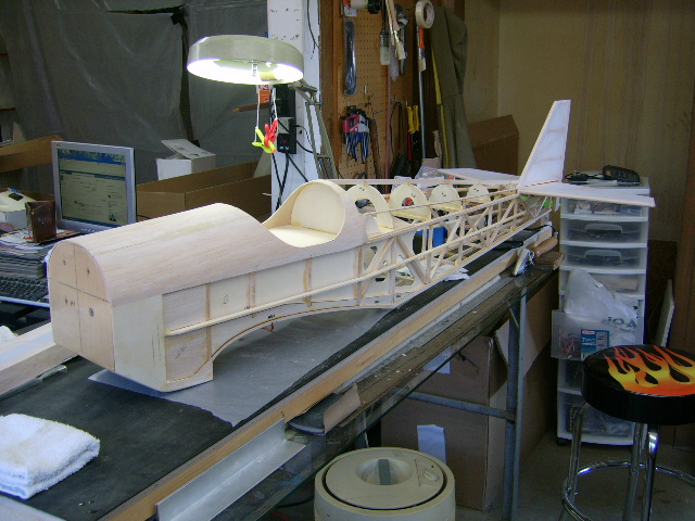

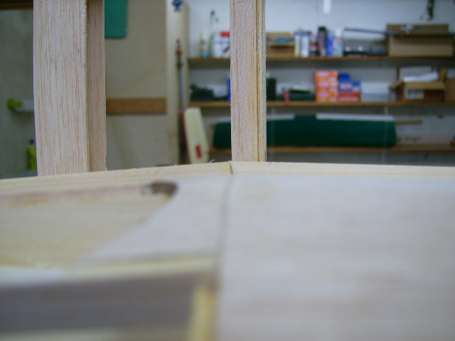

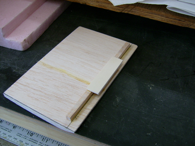

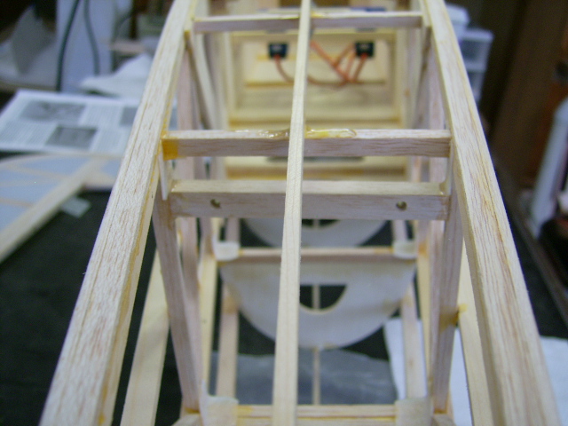

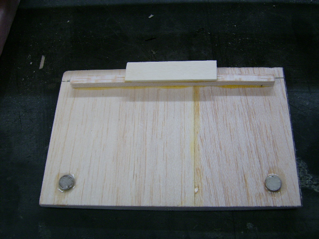

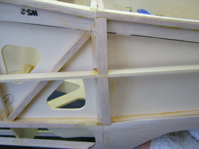

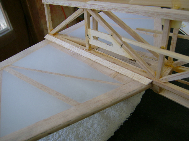

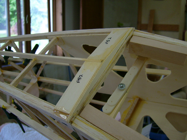

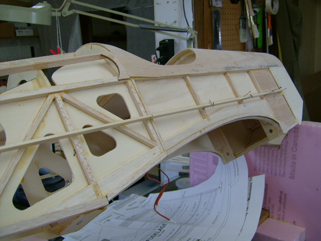

Made some more progress.
1. Decided to make the balsa block in front of the wing removeable. So I reinforced the wing hold down straps and put a tongue on the balsa block.
2. Installed all the stringers that give the fuselage it's rounder shape. I mitered the joint of the side stringers where the fuse angles to a narrower shape and don't like the protrusion, so I will sand them down to smooth out the transition from front to aft of the fuselage.
3. I also installed a solid block in the space under where the horizontal stab attached to the fuselage. This will make it a lot stronger.
4. Added the rear wingmount blocks. Still have to drill and tap the blocks.
5. I covered the horizontal stab with fabric.

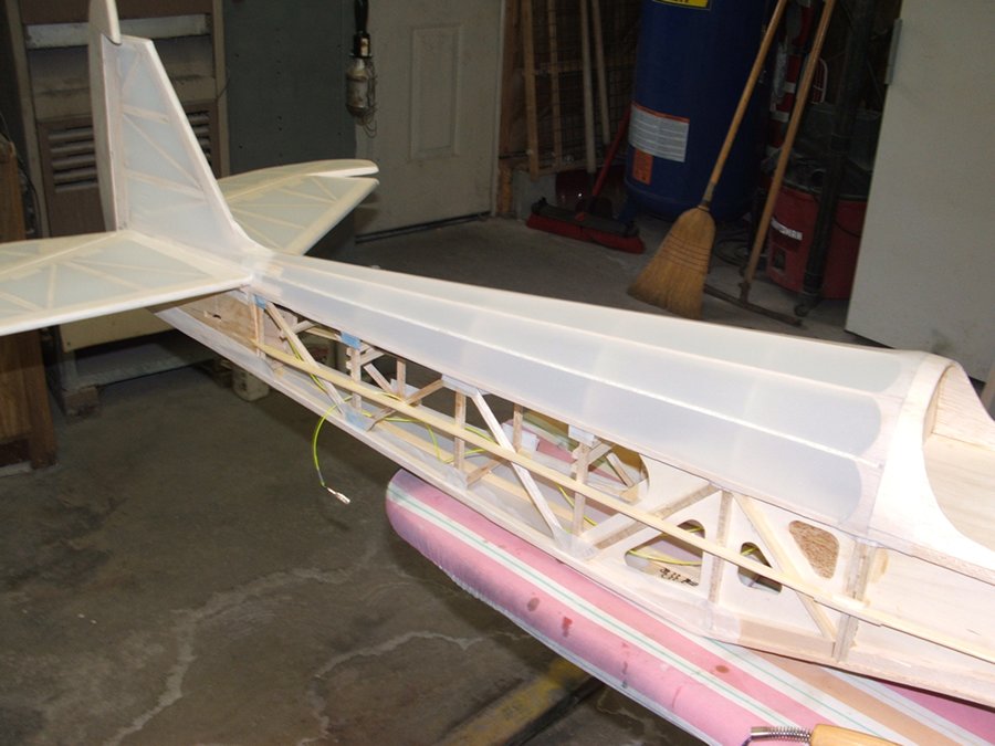

Tom

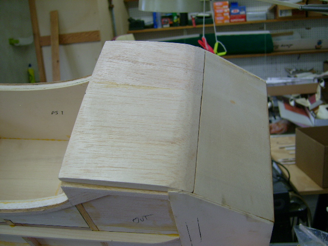

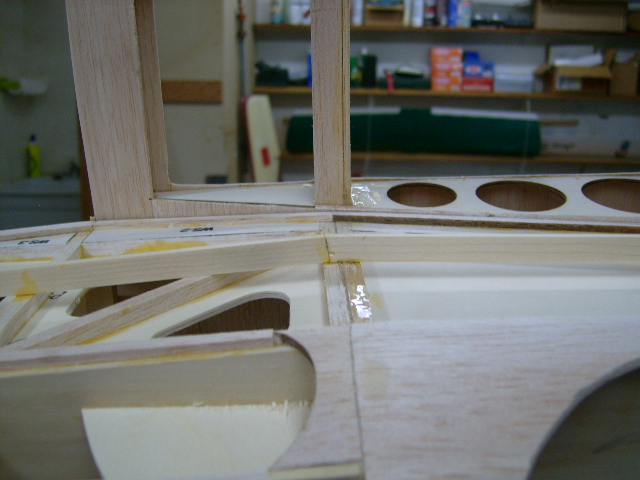

I was looking at the fuse sides and wondered if the covering is best sealed down on the saddle side fill strips or the saddle itself (bottom). I am thinking (I know that is a problem in itself) that if not sealed to the side filler strip the covering will be more vulnerable to puncture from handling, etc. What did you do?
This plane with all the open spans of covering is like a 20lb egg as far as care in handling. Slab sided planes are much more forgiving in the hangar.

My SW was sealed in both places, huck. I tacked it to the sides of the saddle fill strips first, and then folded the covering into the saddle, where I sealed it again.

Tom, thanks for the pics. I figured that was the way to go but was not sure how it looked, etc. I was going to sand down the point where the joint is on the side stringers so it is not so prominent. Your pic looks like you did the same. I was also thinking that I would add some vertical balsa filler at the the fuse joint for fabric attachment. This looks like a good place to seam the covering. Then I can cover the nose back to the end of the cockpit with one piece and cover the aft sections separately. How did you do your seaming?

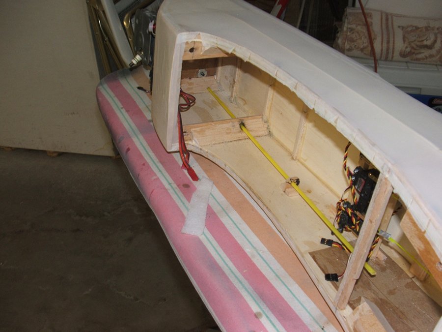

These pics will give you an idea of how I covered the fuselage on my SW, huck. I did the mounted tail first, then the top and bottom. The sides were last.
The sides were done in one piece, nose to tailpost. Note that extra balsa was added, in front of, and below the stab, to give purchase area for the covering.

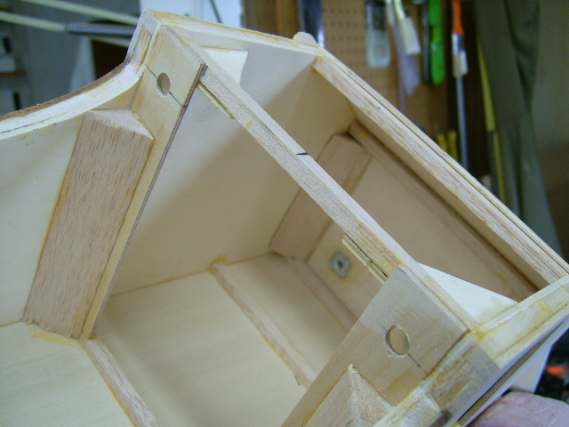

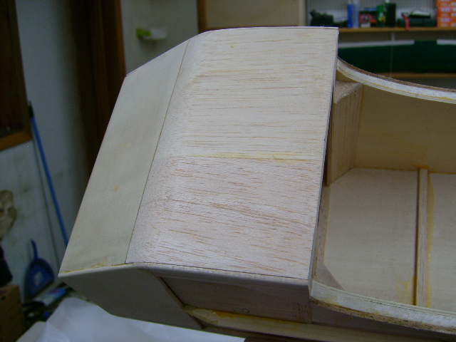

Here are some pics of the removable hatch on the bottom of the nose. This will make it easy to service the throttle servo, ignition module and gas tank. The hatch has a tongue on the front and magnets at the rear corners.

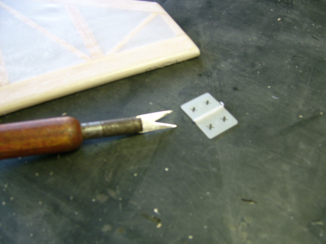

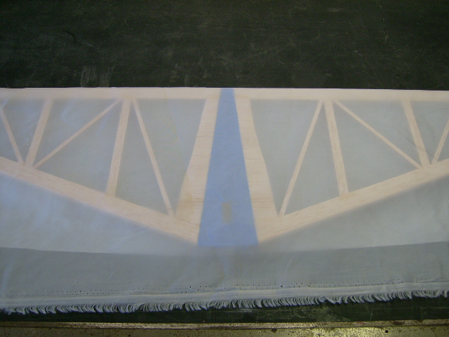

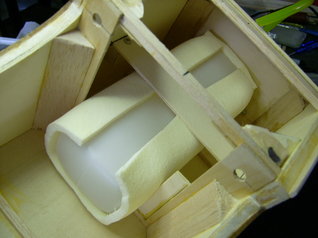

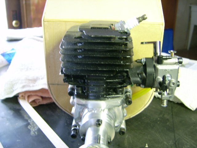

Made a little progress. I have been busy installing new windows in my house. Replaced 14 and have the big front picture window left to do. Then I have to put up the new siding - 22 sq.This is getting expensive. But here are some more pics.
1. Put in the cross member to hold the rudder pull-pull wires,
2. Mounted the horizontal stab and triangle stock on the underside.
3. Mounted the fuel tank and a removeable cross brace. I am using 5/32" tygon for the fuel feed and 1/8" for the vent and fill plumbing.
4. Trial mounted the engine, Turnigy 52cc, to determine throttle servo location. Flipped the carb over to make the throttle arm easier to hook up. I replaced the original arm with one from Jody as suggested - it is very nice.
5. Put on side blocks where the fuse sections are joined so that I can seam the coveriningaft of the cockpit. I will use one piece of matterial for the sides and top. Then use four pieces for the aft fuse - 1 top. 2 sides, and 1 bottom.

Just curious. Why are you using 4 pieces on the fuselage sides, instead of two ?

I am using two.  I wrote    "Then use four pieces for the aft fuse - 1 top. 2 sides, and 1 bottom. "

Interesting. I would have covered the bottom of the fuselage, then the sides, then the top, so that all the overlap seams would be downward facing, and (theoretically) less noticable.
